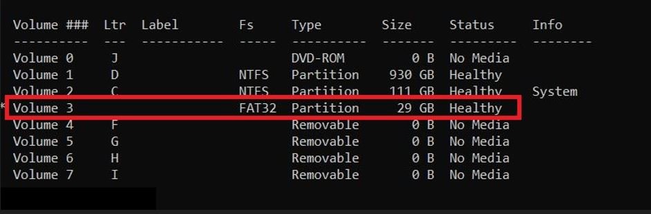

    If you have a Windows machine and administrator privileges, you can format using the Command Prompt.
    diskpart
    list disk
    select disk
    clean
    create partition primary
    format fs=fat32
    list volume
    assign letter =E (the example I attached doesn't have an assigned letter, but I would assign E to the drive. FYI, the drive won't be available or visible in the windows environment until you assign a letter).
