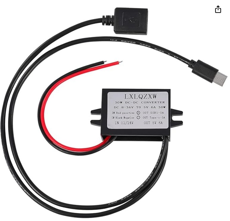

    I installed one of these in my '09:
    https://www.amazon.com/dp/B0BZTV9M19
    Connections are +12V, Ground, USB-C, and USB-A.
    I put the USB-A in the center console storage, and the USB-C comes out where the bezel of the shifter is. My phone sits in the change pocket, and the USB-C plugs right in. With this setup, and my Android Auto head unit, I have tunes and maps that allow me to drive 600 miles a day.
