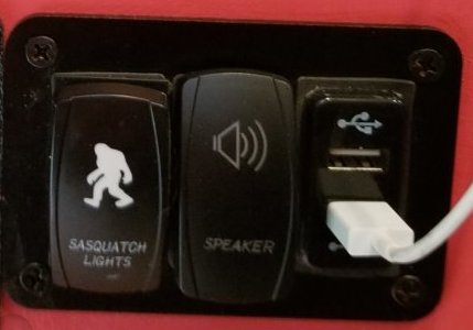

    Aftermarket is your easiest bet, as they are already sized for Toyota switch blanks. I bought one off of Amazon for roughly 10 bucks and installed it in my trailer. The only downside is that I had to first disassemble it to clip those stupid LED lights. Had it gone in my truck I would have also sanded the decals off the face plate. But it puts out a decent charge.

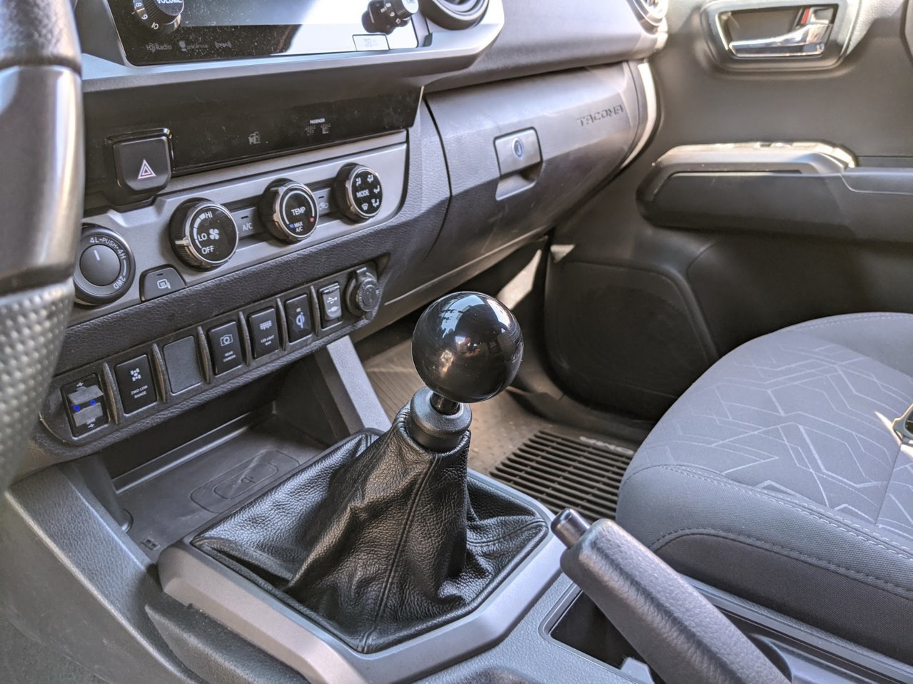

    No need to take the dash apart to install one. You can pop out one of the blanks in the center by putting duct tape on it, making a loop and giving it a good pull. Then you can route the wires through the hole to the drivers side fuse box and just use a "add a fuse" there. Takes 10 minutes and the only tools you need is a 10mm for the ground and duct tape to pull the switch blank out.

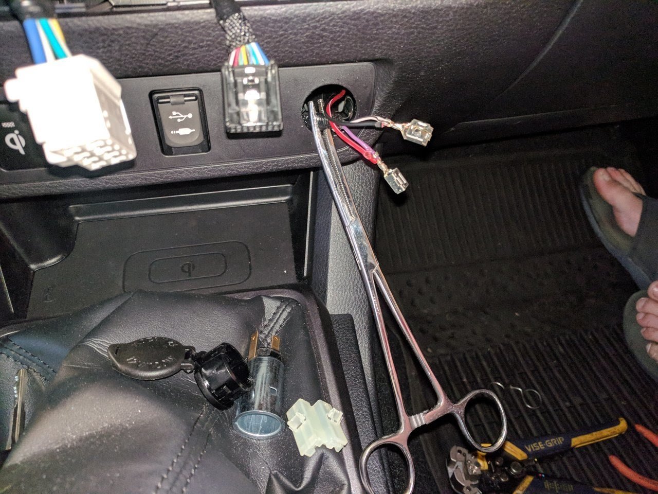

    Yeah. Flipping bits in the ECU is nothing as risky as flashing a TSB. Yet, hundreds of us have made it through.
    I have two different ones in my @MESO LSP7. Same setup as Stock, just more possibilities:

    I don't know. The DAH is the first part that I am buying from her.
    Installing both of mine was pretty easy though.
    The left one is constant power tapped into the tow harness connector and grounded at the ground point almost directly behind the switch panel.
    The right one reuses the stock power port spade connectors. I just had to disassemble the stock plastic part of the connector. Very easy also. This is the first time that I took it apart to use as a keyed power tap for the front camera:
    Skydvrr[QUOTED] likes this.

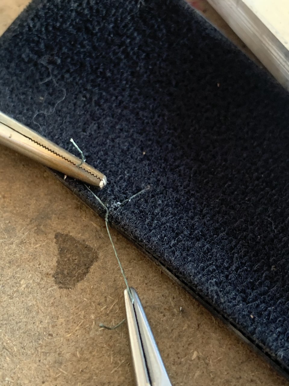

    Hahahaha! One of my favorite tools. On the bike side, I use them to keep from dropping valves when swapping closer shims.
    I need that sweet one that you have since I have to wrap mine in electrical tape.
