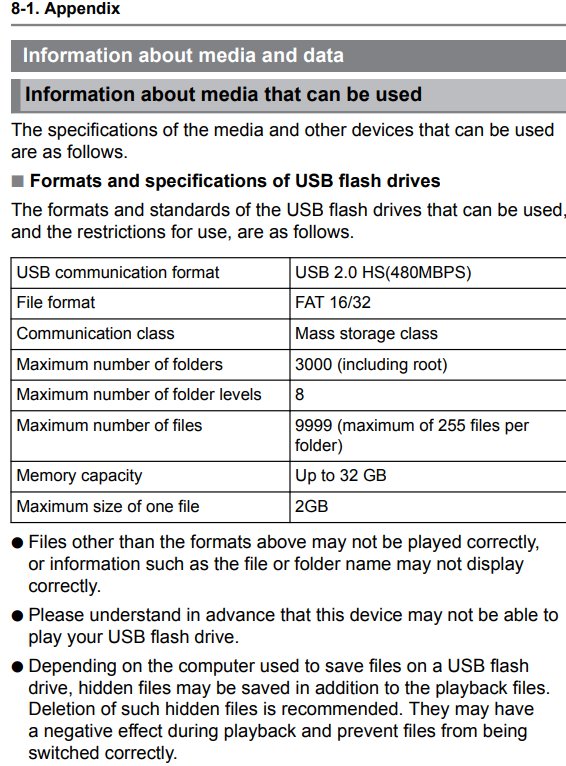

    LOL, I just found that as well. Here's a pic. Basically this is the same as my 2018.

    gr8-wrx, thank you so much. My issue must have been the 32G limit as well as the format (not FAT32) of previous flash drives I was trying. I have since obtained a 32G Sandisk formatted as FAT32 and it's all good. Very happy.
