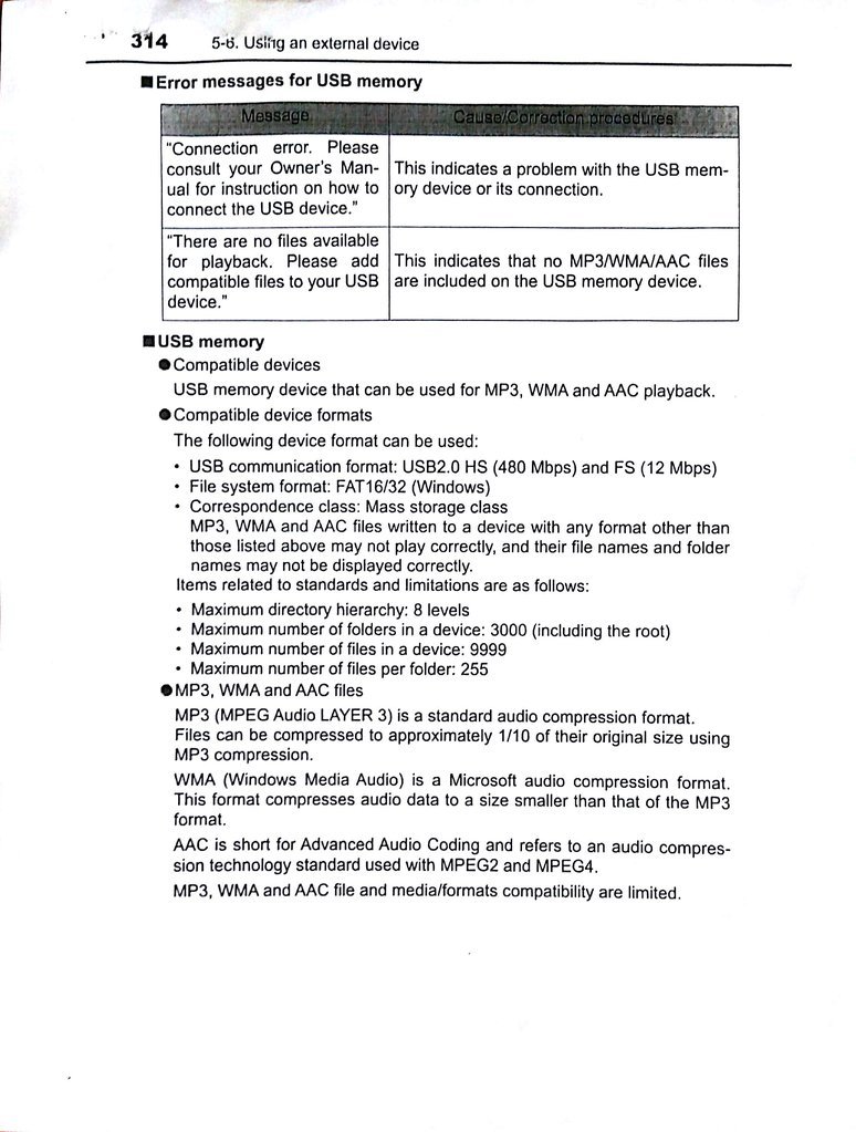

    Sep 3, 2015

    page 311 owners manual ...
    ■USB memory
    ●Compatible devices USB memory device that can be used for MP3, WMA and AAC playback.
    ●Compatible device formats The following device format can be used:
    • USB communication format: USB2.0 HS (480 Mbps) and FS (12 Mbps)
    • File system format: FAT16/32 (Windows)
    • Correspondence class: Mass storage class MP3, WMA and AAC files written to a device with any format other than those listed above may not play correctly, and their file names and folder names may not be displayed correctly.
    Items related to standards and limitations are as follows:
    • Maximum directory hierarchy: 8 levels
    • Maximum number of folders in a device: 3000 (including the root)
    • Maximum number of files in a device: 9999
    • Maximum number of files per folder: 255
    Beerpayzdabillz likes this.

    UPDATE: Went to pick up the truck from the dealership today. Service manager took me to a new Tacoma, I plugged in the USB and the same results: 499 files. I inserted another USB and again 499! Is the manual misleading? They gave me the attached page they received from Toyota. I think I need to contact Toyota directly.
