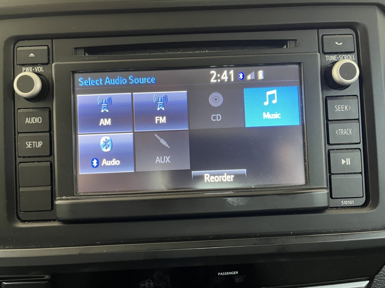

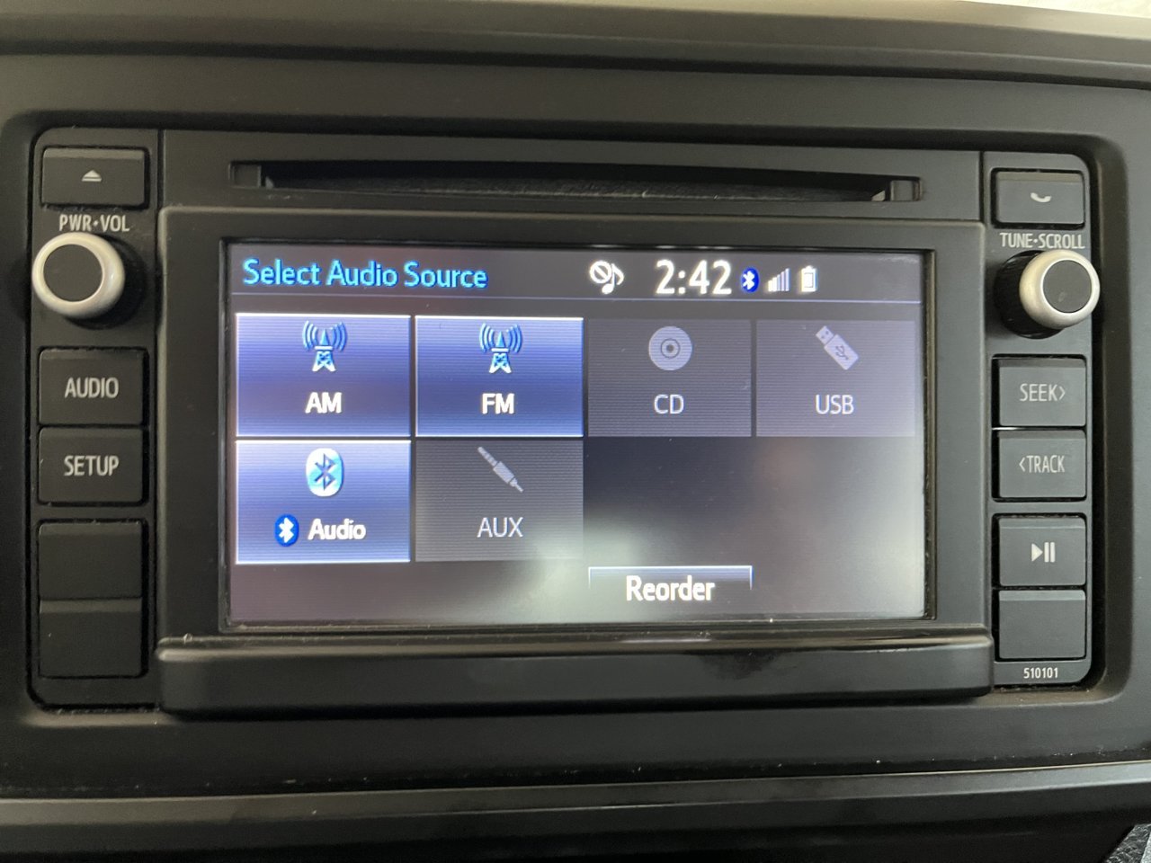

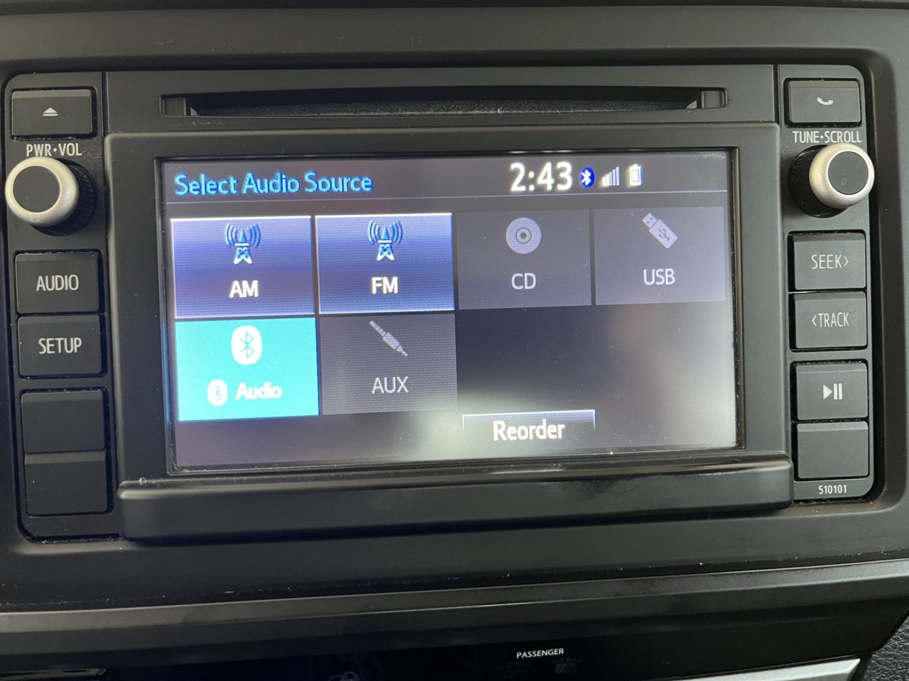

    When using bluetoothA4B6F8C1-E489-4129-8EF1-5A6C14D58176.jpgWhen using phone plugged in AAC09DDD-DF40-40C0-916D-B255FFF4B885.jpg
    When unit is working with phone plugged inCA41006F-7CBE-4119-9F9B-C380EBB6AE43.jpgWhen the phone is plugged in, it charges

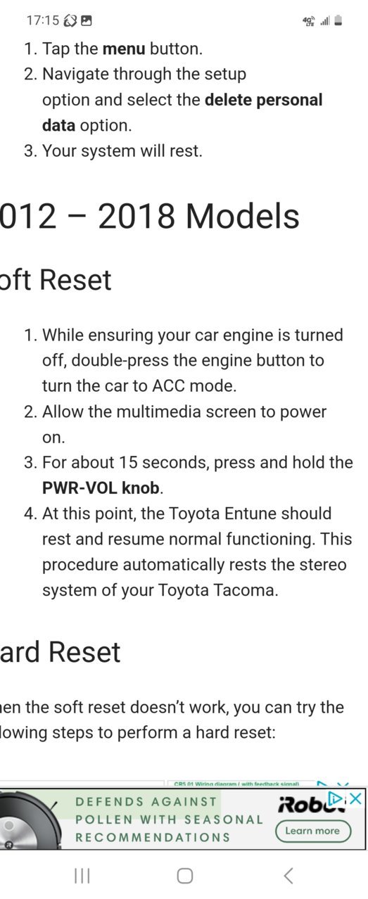

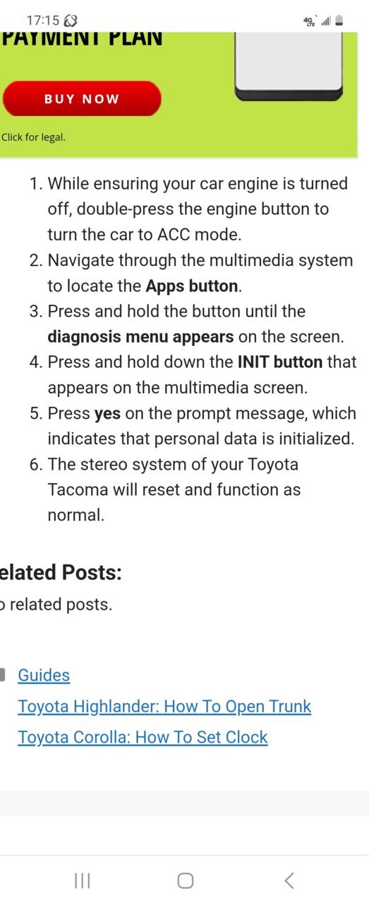

    Found these for a soft reset and a hard reset.
    DES2009 and ZMan2k2 like this.

    I was looking for a place that had a small reset button or pin you press. But those instructions popped up when I put in the number on the bottom right of your radio for a reset.

    I tried the resets and they didn’t work. My unit doesn’t have an app button, so I couldn’t try that method. When I held down the power button, it just turned off and on repeatedly. I was able to delete personal data, but nothing changed. I disconnected the battery for ten minutes and after reconnecting, the usb worked. It took several minutes for the usb icon to highlight and another minute or so before the random, repeat and pause buttons lit up.
