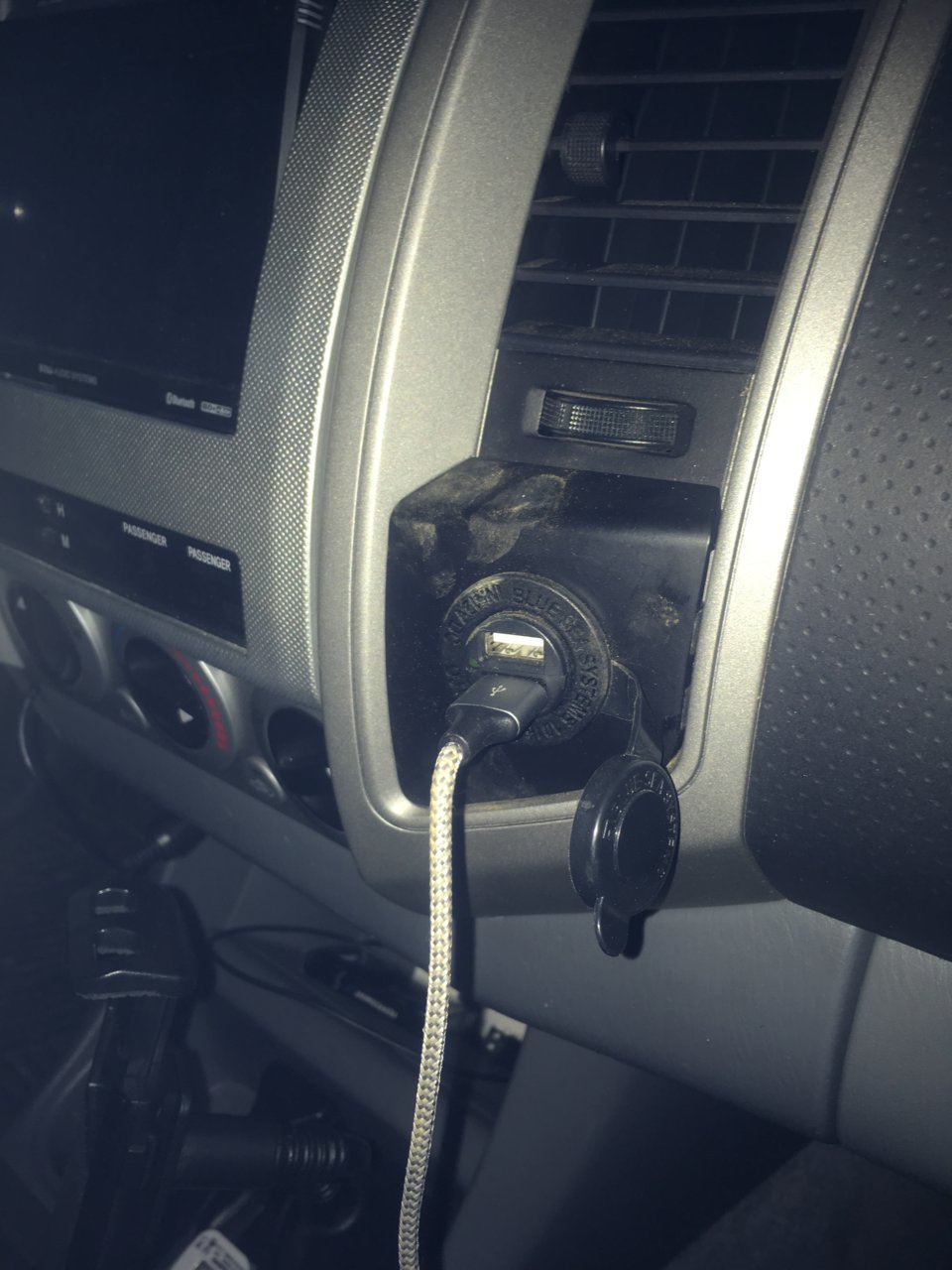

    I dropped mine just to the right of my head unit

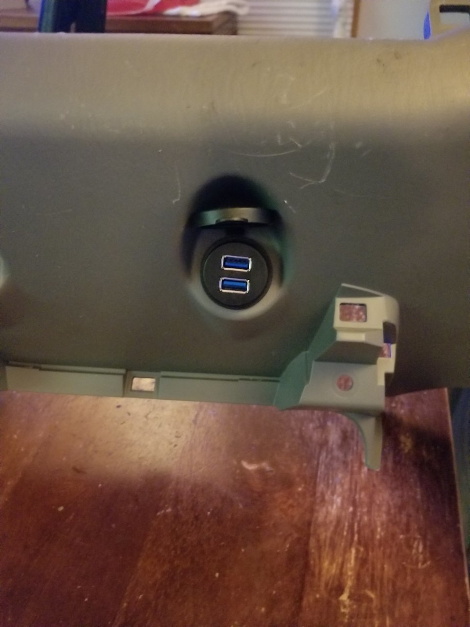

    I'm thinking it might work easier if I use the cigarette lighter hole. It is "almost" 1 1/8". These units seem made for the 1.5 amp feeds from aftermarket stereos. The USB cord(s) are factory installed to the back of the port plug, and then terminate in USB Male to plug into the aftermarket stereo. Here are the two units I am going to try.
    https://www.bluesea.com/products/1044/12V_DC_USB_Extension. Just delivered this morning. Already a VERY tight fit at 1 1/8" reportedly. I literally couldn't quite get the threads past the cigarette lighter hole in my 2006 Toyota Tacoma. It does support data and charging, even fast charging. I've only tested it through my lap top, but both data and fast charging worked. Available through Amazon as well.
    Second one ,https://www.amazon.com/gp/product/B01MY1WDIU/ref=ppx_yo_dt_b_asin_title_o00_s00?ie=UTF8&psc=1
    Bonus two USB leads/female receptacles, as my Pioneer AVIC 8500NEX has two USB ports. Crutchfield recommended, It, reportedly also does fast charging as well as data throughput.

    Fits into both the cigar lighter ( easily) and the power supply port, with a little bit of threading. Both are nice, tight fits when installed. I'll check out data and chargong later.

    Second one ,
    $11 2 Ports Dual USB 3.0 Male to USB 3.0 Female AUX Flush Mount Car Mount Extension Cable for Car Truck Boat Motorcycle Dashboard Panel -(3 Feet)
    Does support data transfer as well as "fast charging" as checked using my notebook computer. Does fit into either the cigarette lighter or the smaller power outlet dash holes. Currently, until final checking when I have the Pioneer Avic 8500NEX initially installed/connected to further check Apple CarPlay and Android Play. The head unit does either wirelessly, but wanted to have backup verified.

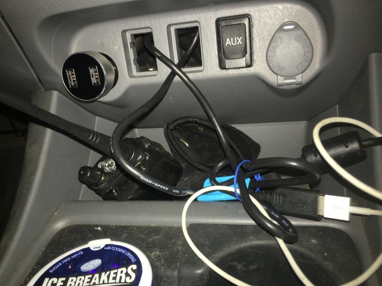

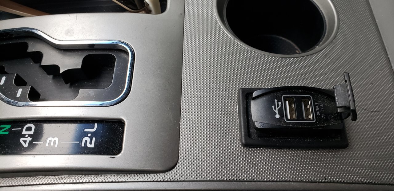

    2005 DCLB 4WD
    I used a drill bit to grind off enough room for the HU usb cable to pass through the cubby compartment to phone. I also added a dual usb port at the center console so my wife can charge her phone. I plan on adding another for rear passengers off the rear console.
