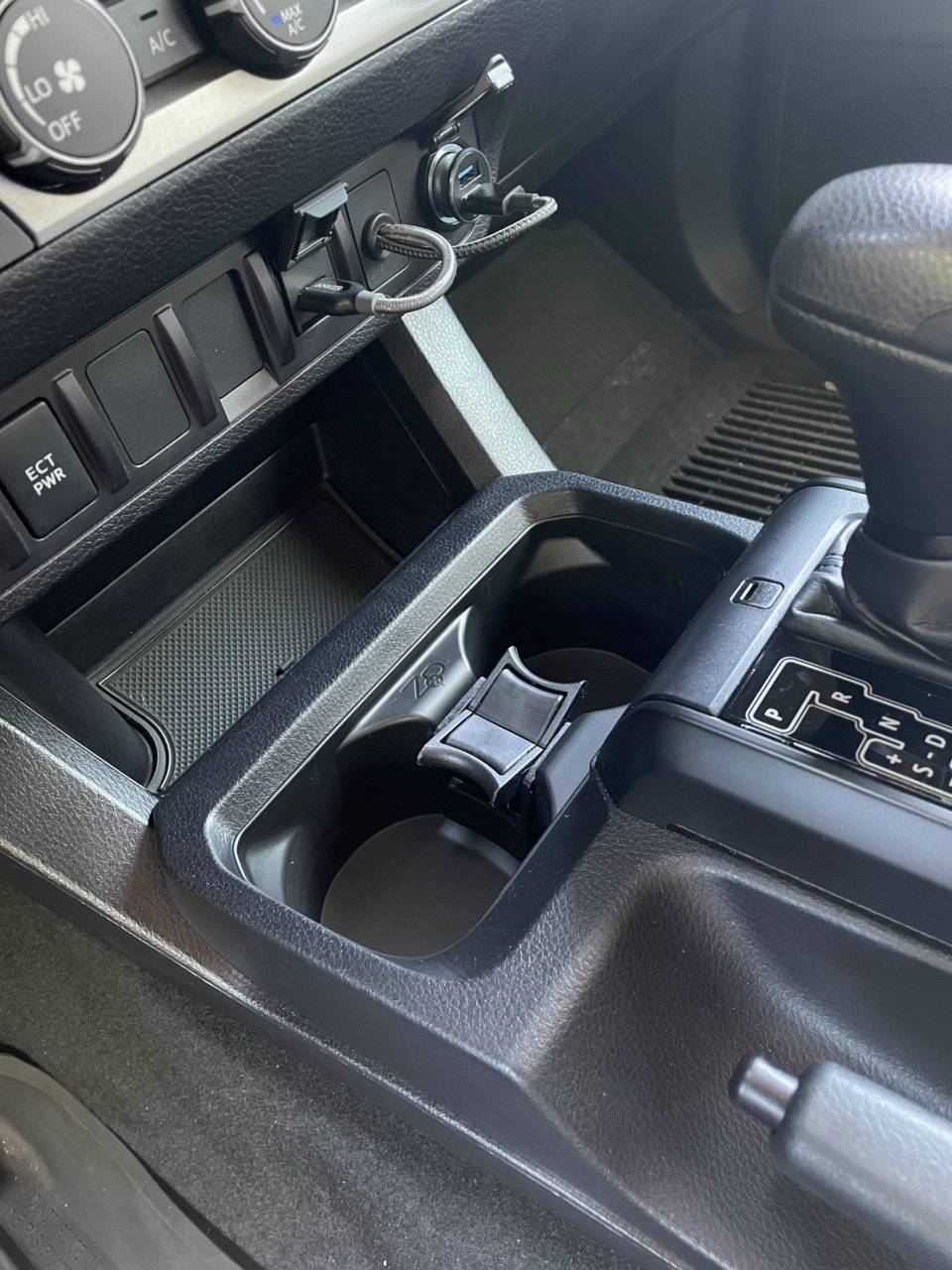

    Anybody know where I can find a usb port that will pop into the switch panel. Added a carplay kit and it has a seperate USB plug from the stock one. I popped out one of the switch panel blanks and ran it through. ISO a piece I can use to make it fit into place and look factory.

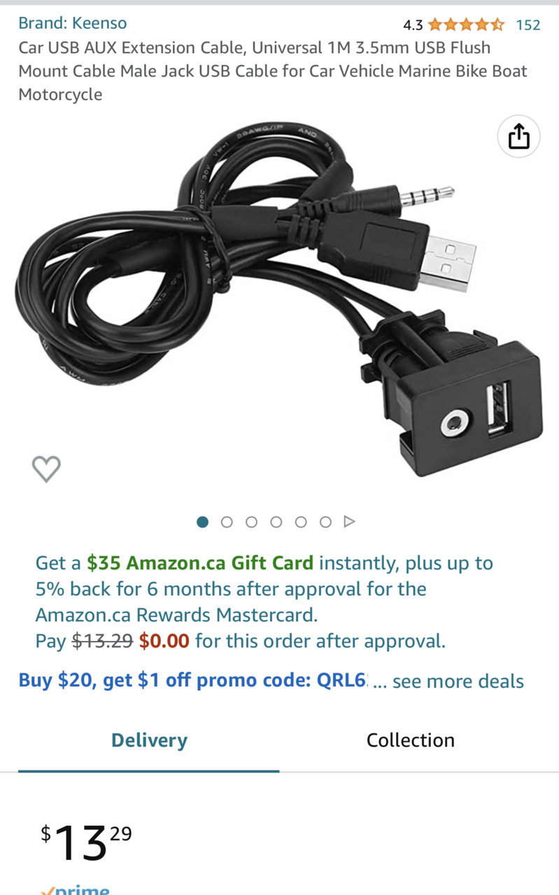

    Maybe this?

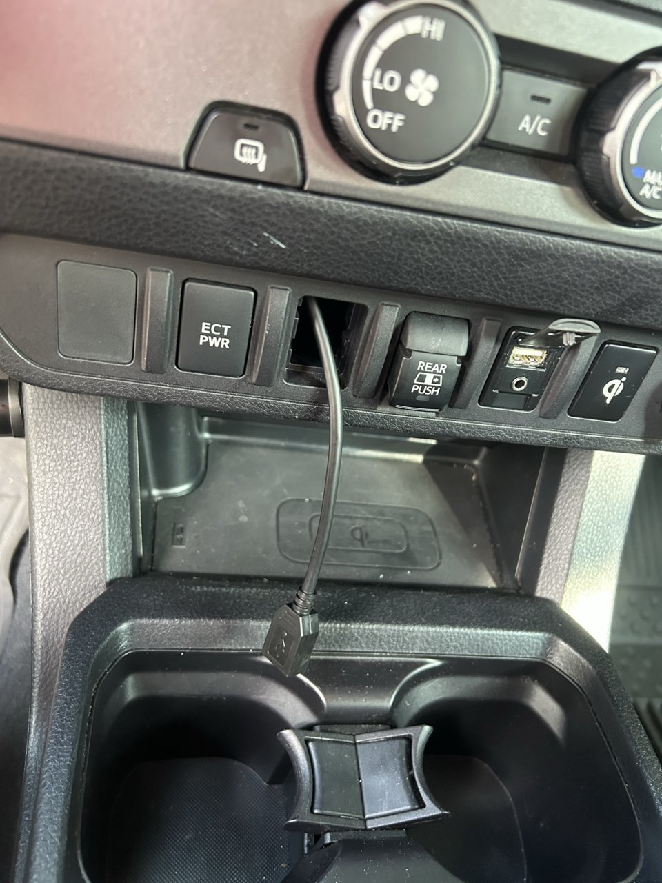

    Just a grommet through a factory blank

    That looks like a female cable end, no?
    I'm thinking your cleanest option might be to find some kind of panel mount female-to-male and then install it yourself in a blank switch panel
    https://www.amazon.com/ICESPRING-Fe...male+to+male+panel+mou,electronics,158&sr=1-4

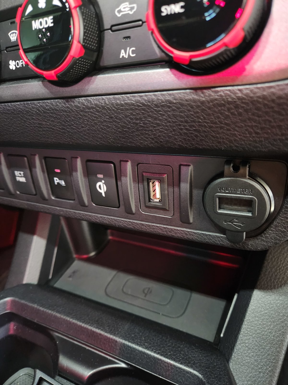

    Amazon, fits in the factory space and works just fine. Looks like the factory USB port as well. I have a CarPlay kit in my ‘18 that runs a 2nd USB and it worked perfectly.

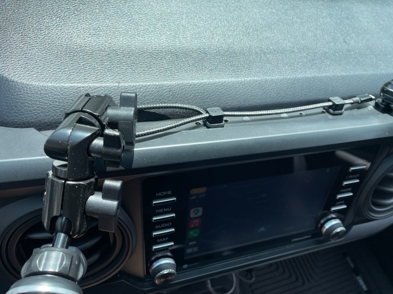

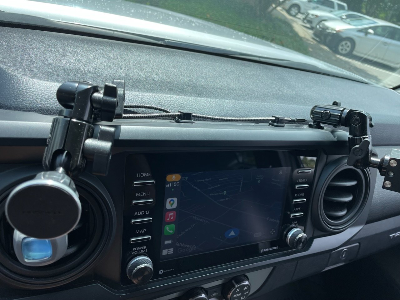

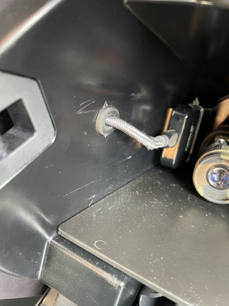

    I have my wireless CarPlay adapter in the glove box so the usb c end goes through the grommet into the wireless CarPlay dongle in the glove box. The other wire is just an iPhone cable that is routed through the grommet and up to the top of the radio where I keep my phone on a magnet mount.

    Ahh, ok, so it's the other ends (USB C and Lightning) that fit through the hole! Thanks! I have a wireless CarPlay adapter as well and I'm hunting for a home for it...this might be the solution!

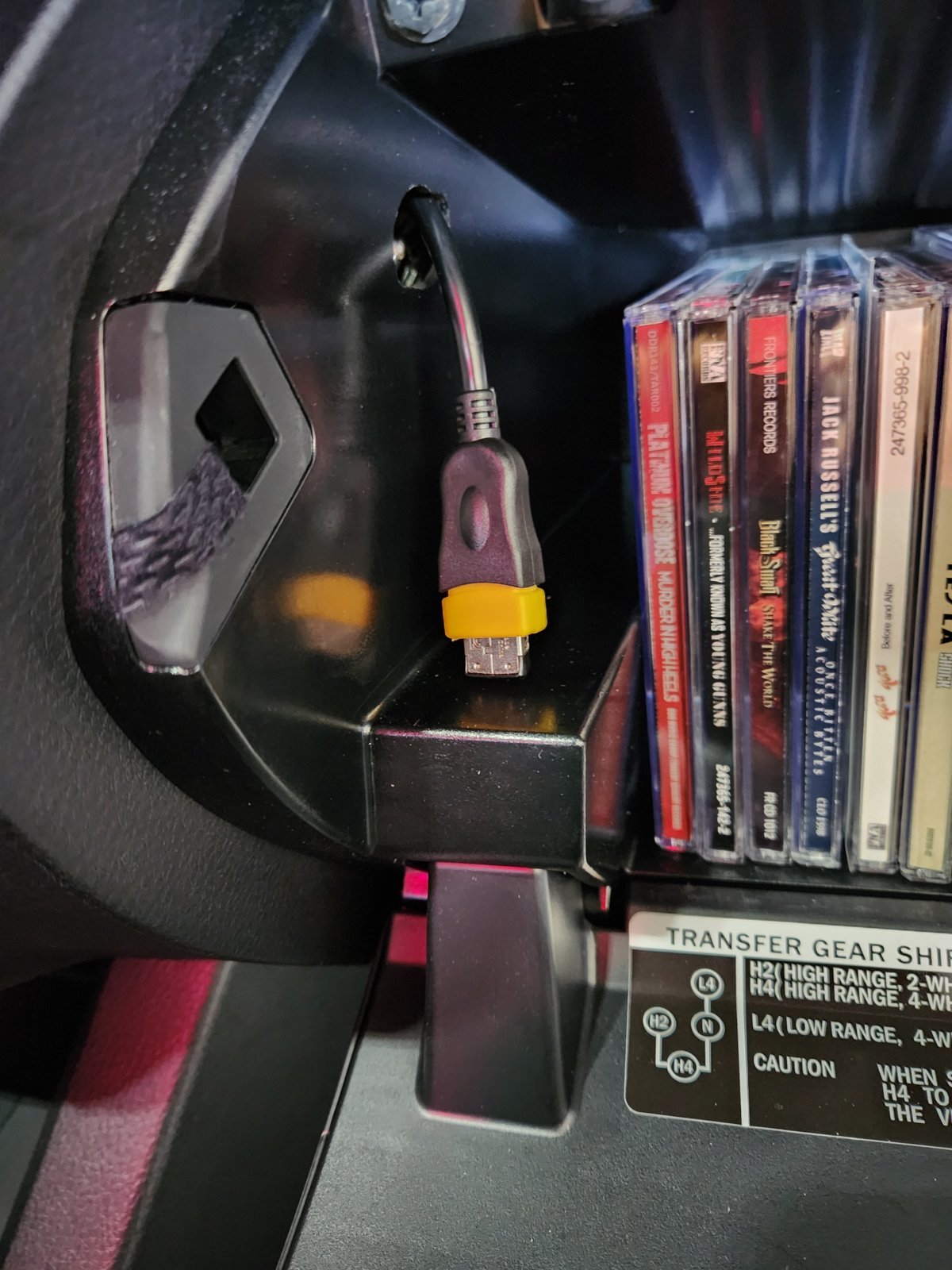

    Correct here is a few more pictures. I have a sticky clip on the side of the glove box and the clip has a spot for a zip tie to hold the dongle.

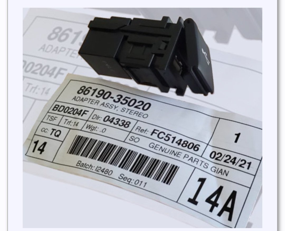

    I'm looking to replace that usb a port that connects to the infotainment system. I just wanted to make sure I get something that connects to the weird oem port. Ideally I'd like to replace it with a dual USBa & USBc but I'll take whatever I can get.
    Any help is appreciated, this port has been driving me crazy
    Dfpftw likes this.

    Not sure this helps...Search feature not helpful but I did find a parts list here (few years back) for splitting the factory USB. The original panel gets tucked behind the dash and the splitter plugs into that. One end goes back to factory location and the other into the glovebox. There is a factory style panel the other plugs into.
