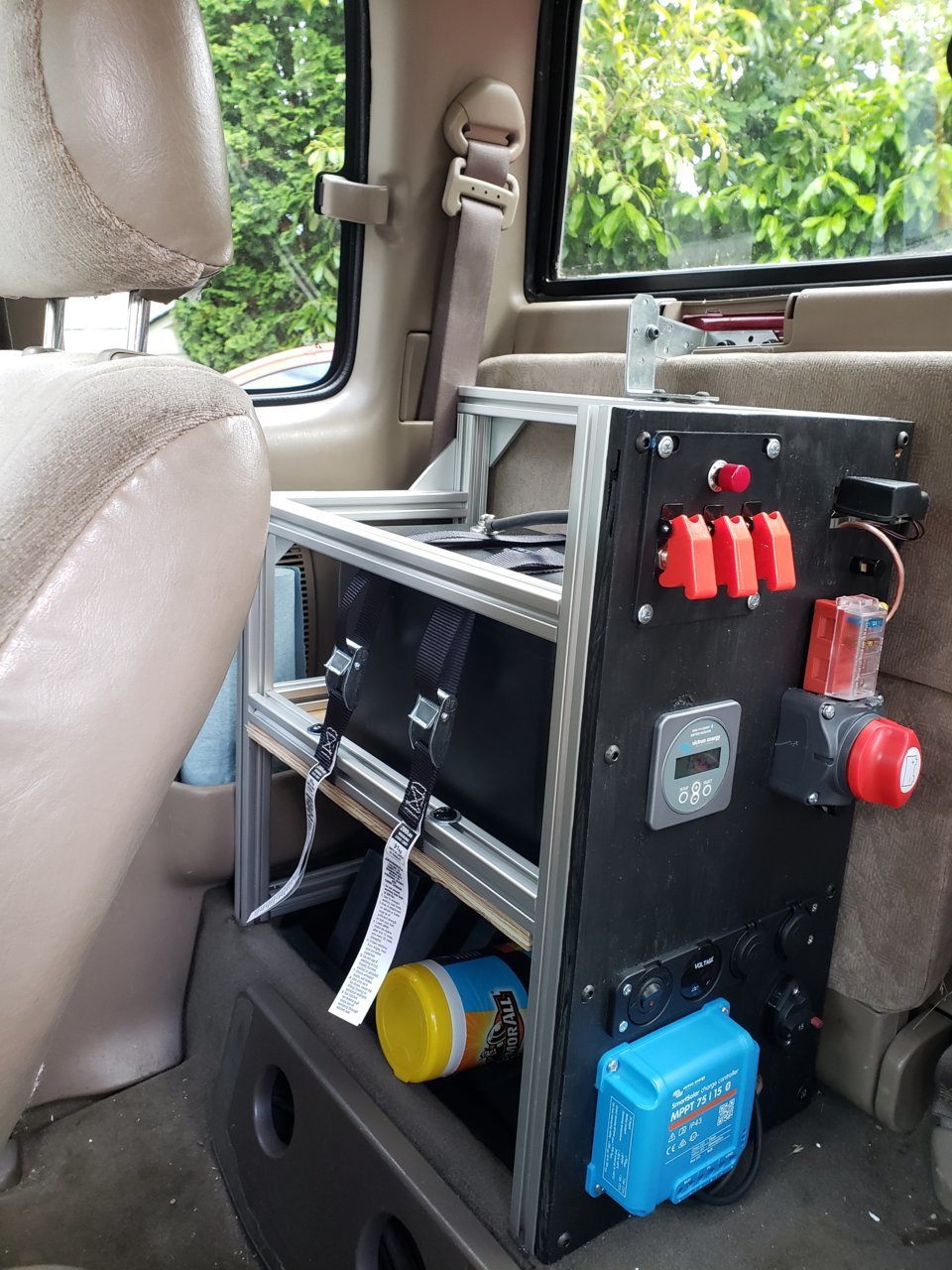

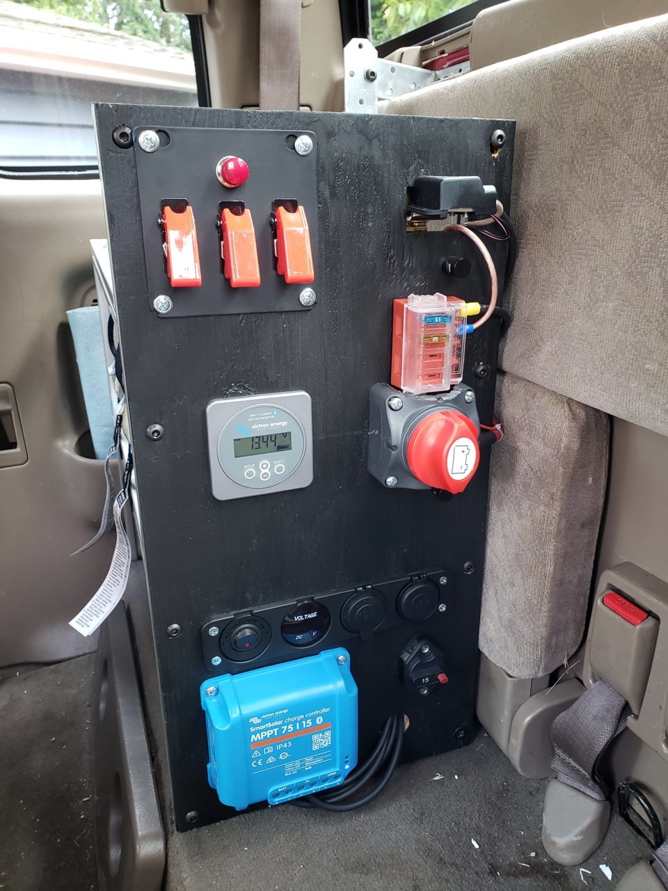

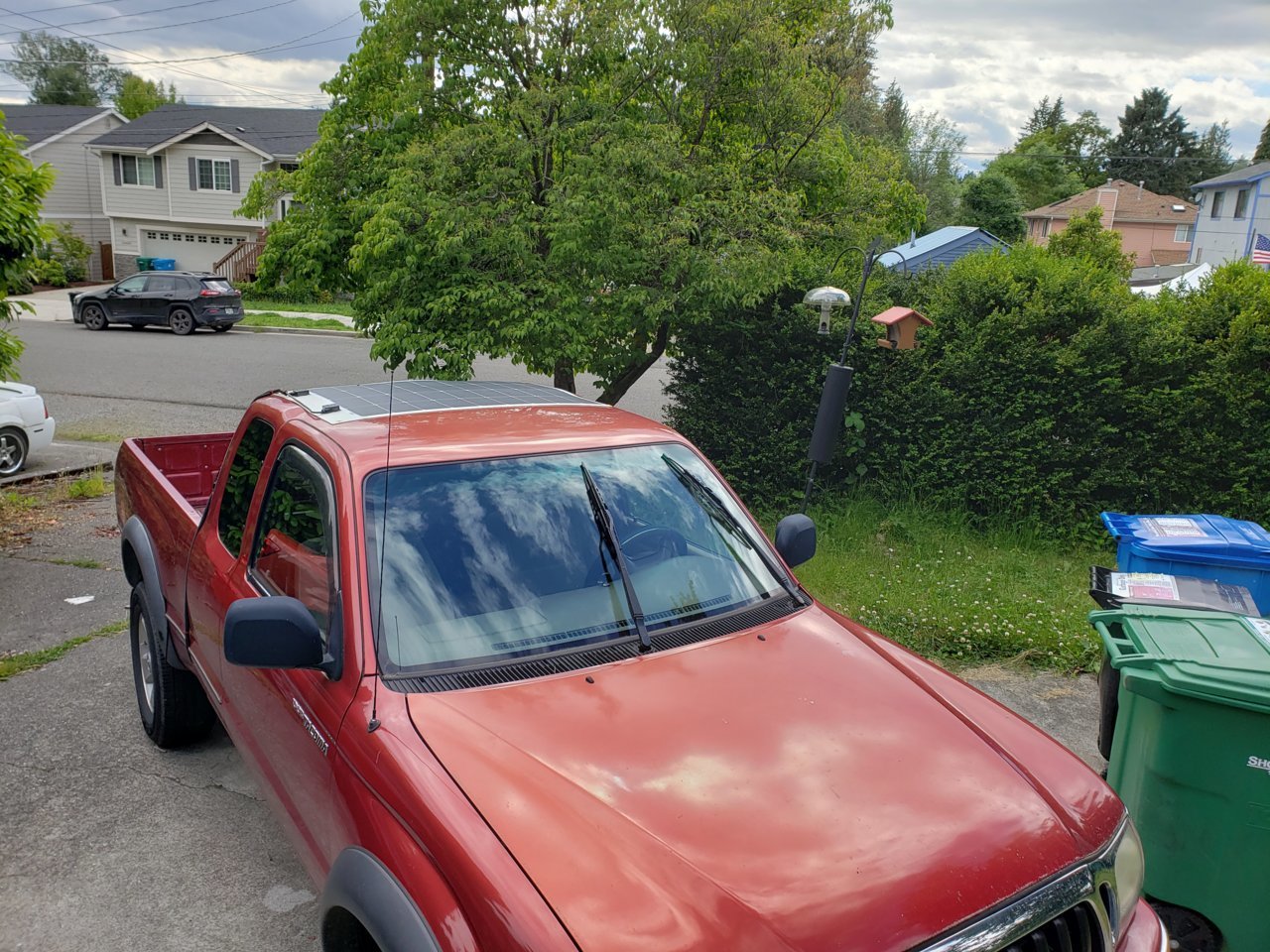

    Or you can go whole hog with a solar setup on the roof. I saw a guy with a second gen that used a flexible panel setup that inspired me. I don't have much need for my backseats so I built a rack to house my battery and all the electronics behind the passenger seat. I used some vhb to stick the panel on the roof and ran the cables down through a plug in the rear of the cab. I bet with some creative engineering and a smaller battery (I doubt you need a 100ah) you could keep the seats intact and still get a functioning system.

    As much as I love that setup, I want to say thank you for proving my point lol.
