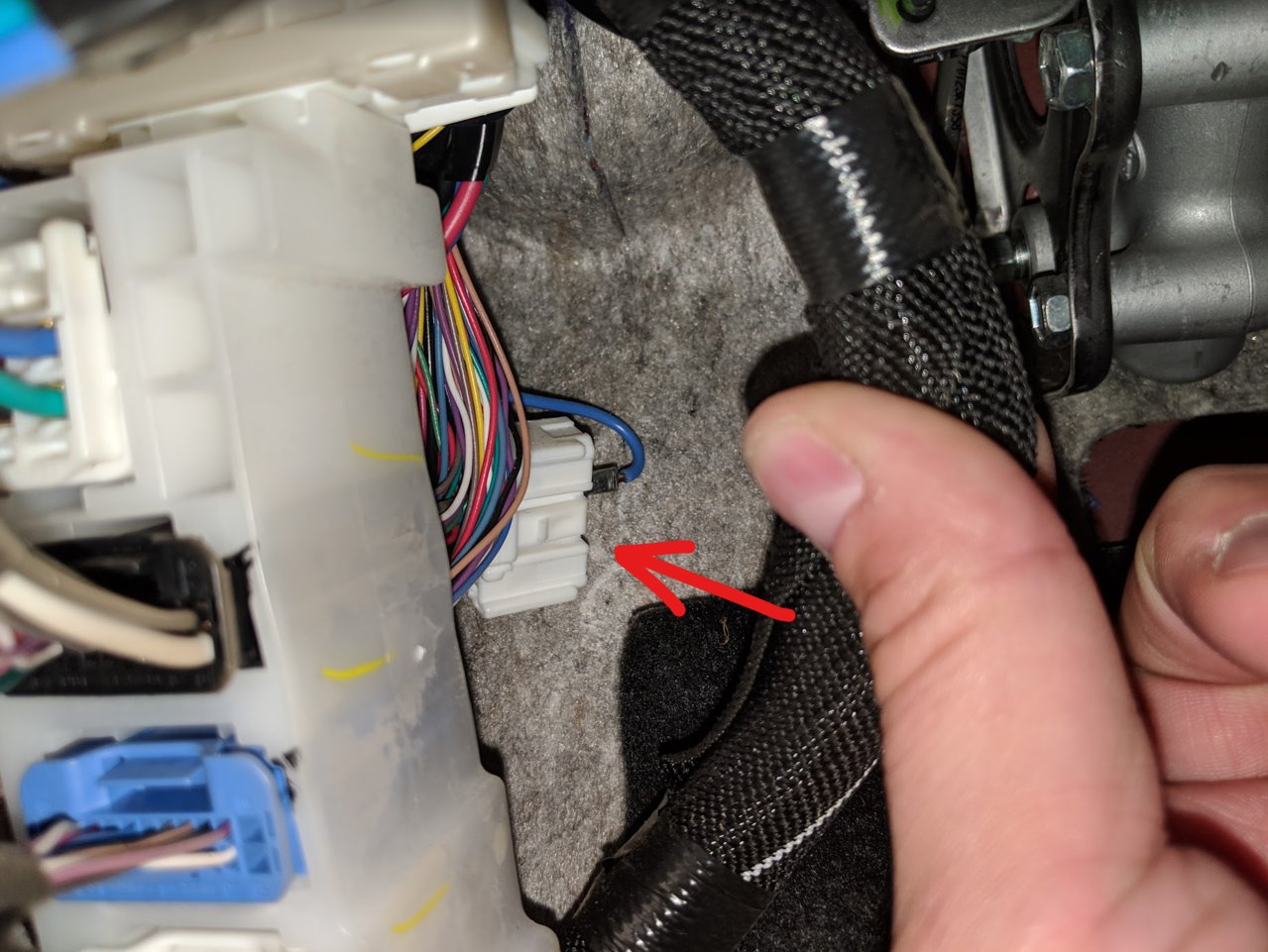

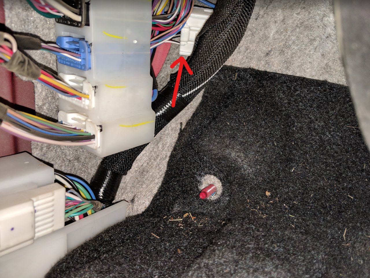

    Under the left kick panel is that trailer brake harness connector. If you are not using a trailer brake controller, there is non-key power in that connector. Work great for me.
    Also, there is a ground stud right behind the left side of the HVAC panel. So, it is pretty easy to wire in USB charging.

    Here's the connector:

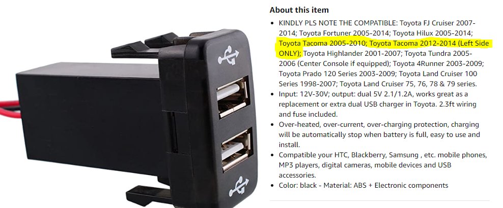

  16. Aug 19, 2022 at 2:24 AM

  17. Aug 19, 2022 at 3:36 AM

    Yes. I placed it in the blank on the left lower switch panel.
