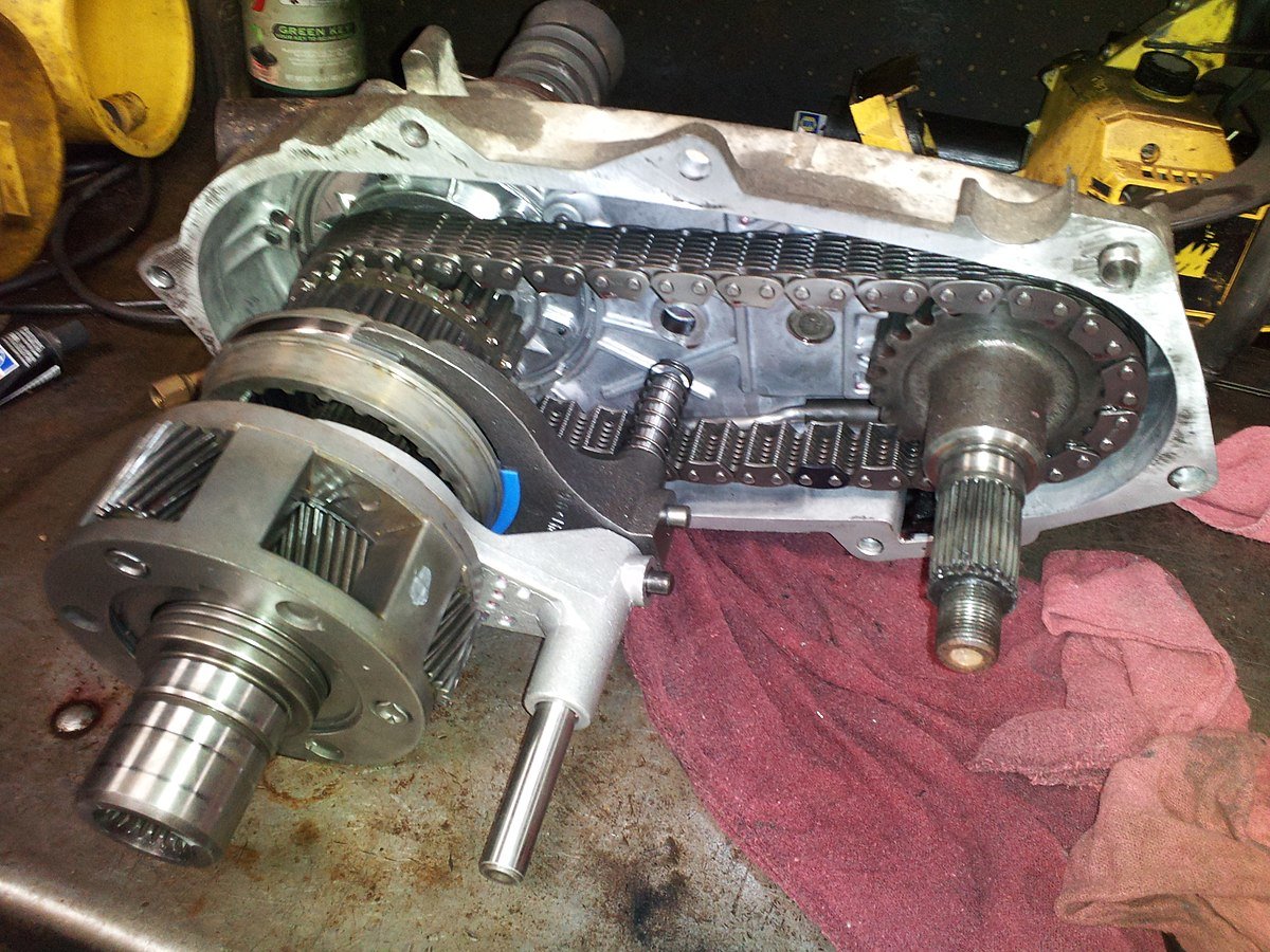

    Just because it isn't broke now doesn't mean you didn't damage something. The damage from stuff like this is cumulative. A fat guy can sit in a chair for only so long before it eventually breaks. A skinny guy can sit there a lot longer before it breaks.
    Just about everyone I know with a 4X4 has done something similar, but not for 80 miles. Unless you felt binding it is unlikely that you'll see a catastrophic failure any time soon. But you did over stress parts and they will fail sooner than they normally would have. If you're like most people who trade often it will probably be the 2nd or 3rd owner who pays for the damage though. This is why I really don't like to buy a used 4X4.
    If you are in a high traction situation in 4X4 and turn the wheels sharp then you stand a good chance of blowing up something in the transfer case or front diff. If you're lucky you'll break a U-Joint before something more expensive blows up. But what you did is more likely to stress the chain in the transfer case. Over time if it is over stressed it will stretch and eventually start slipping on the gears when you accelerate.
    The chain in your transfer case

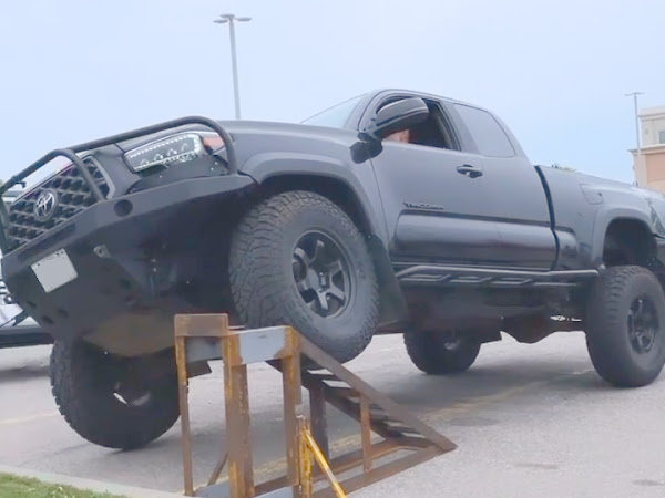

    You're fine. The tires did the slipping so your gears and transfer case chain didn't have to. :)
    I did the same thing yesterday after getting off a flex ramp. Forgot I was in 4low and wondered why the 35s were chirping as I backed into a parking spot. :anonymous:

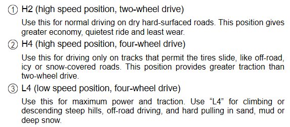

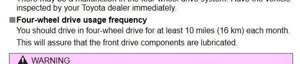

    Straight out of the owner's manual:
    BUT ALSO
    You're supposed to be engaging 4x4 once a month according to your owner's literature.
    Regarding wear on the components from driving perfectly straight on the highway, that's like saying you've overstressed the brakes and torque converter by driving the car, best not to use them to avoid wear. :rolleyes:
