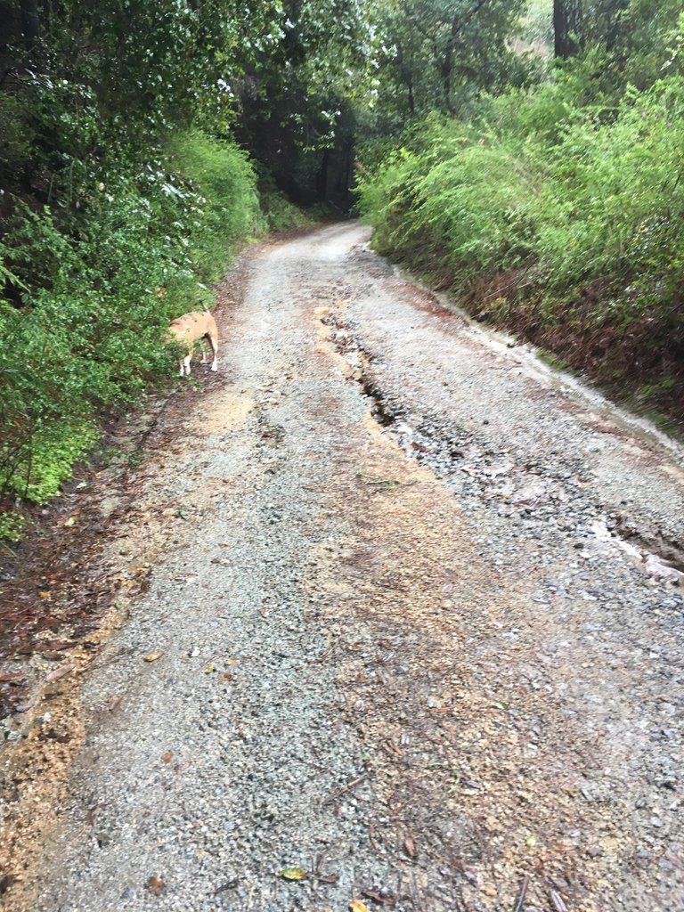

    Make sure your drivetrain is under the least amountIMG_0675.jpg of load before you change in or out of 4hi. I use mine every time I drive. My driveway, worse in summer now.

    hahahah, I was gonna say, that looks like a typical driveway in the Santa Cruz Mountains, then I looked at your 'info' box, 'Dirt road in Aptos', indeed :-D

    LeftCoast Nerd, yeah thats it in winter, much worse in summer, loose gravel. Use 4hi every time I go up and down, had a Tundra and learned to only shift with no load on driveline. Just hear a click if anything.
