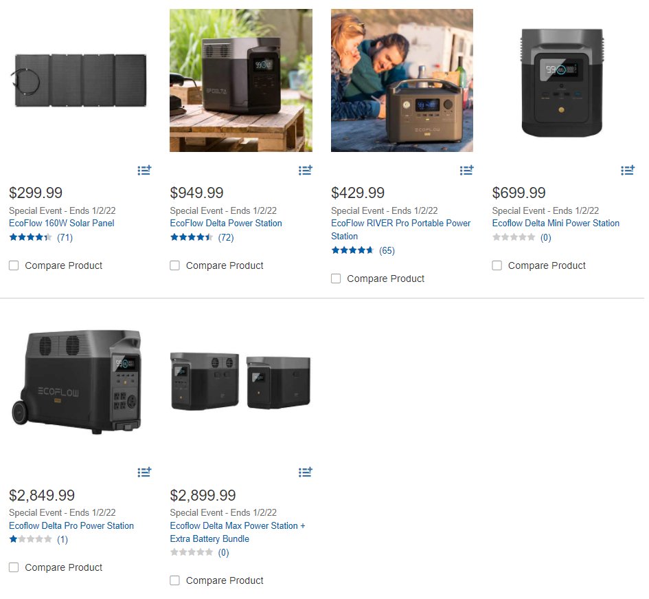

    Everyone keeps suggesting Jackery, they are like the Kleenex of portable power stations.
    Comparable companies at a lower price point do exist. I am happy with my Ecoflow River Pro which is a 720 Wh device which I got for $430. Check out Ecoflow on Costco. Costco offers them for a ridiculously cheap price for what you get. I plug my fridge and other accessories into this full time and have the Ecoflow plugged into a 12v outlet I ran to the truckbed. It is always full and topped off by the time I get anywhere.
    https://www.costco.com/CatalogSearc...al=00847,Regional=115-bd&ipAddr=97.113.200.44
    Dawelda[OP] and lostMarbles like this.
