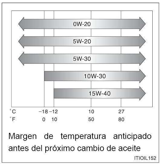

    It'll be OK according to its native owner's manual (Mexican):
