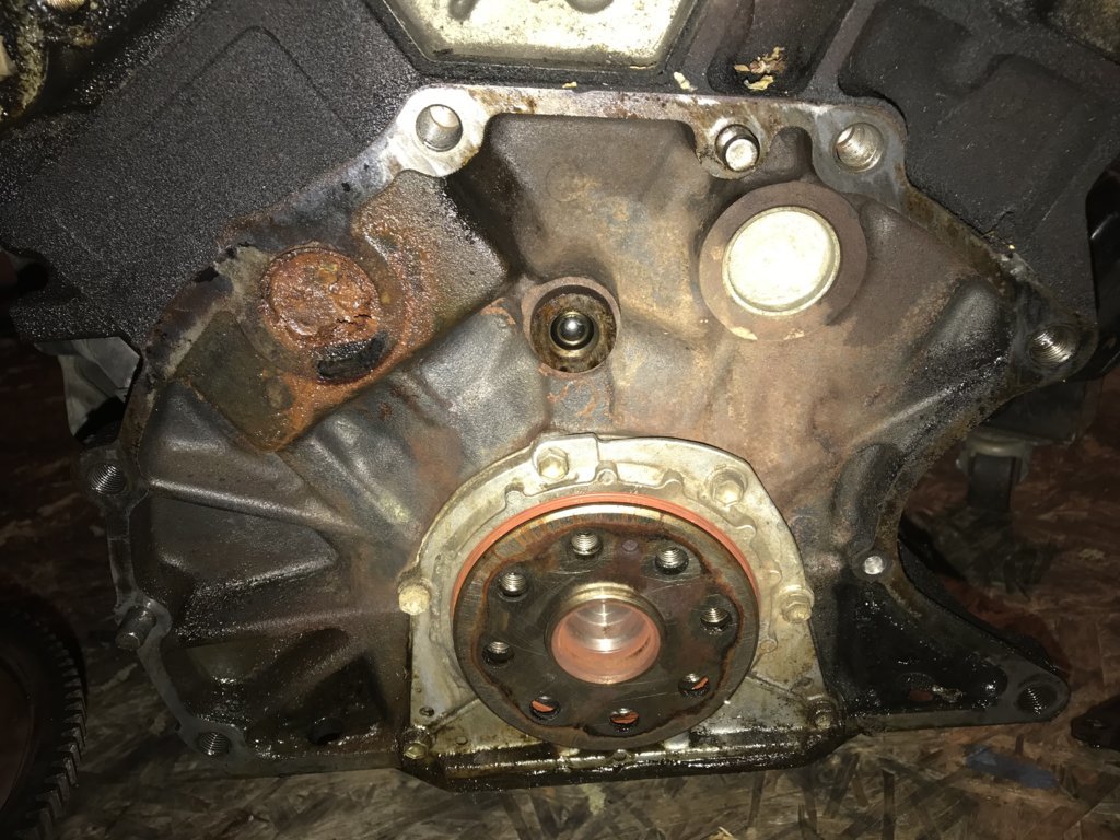

    A simple thing to do is to buy a replacement oil filter to put on his motor and take his oil filter off, open it up, spread the pleats and look, any sparkles walk away. A look at the exhaust and spark plugs might tell you if it is an oil burner or not. Look at the core plugs, if the flywheel/flex plate is off pull the seperator plate and look at the core plug on the D/S bank rear, that is where all of the crap in the cooling system settles, you will see the casting bump for the cylinder and the ledge where it all settles.
    I found the picture...
