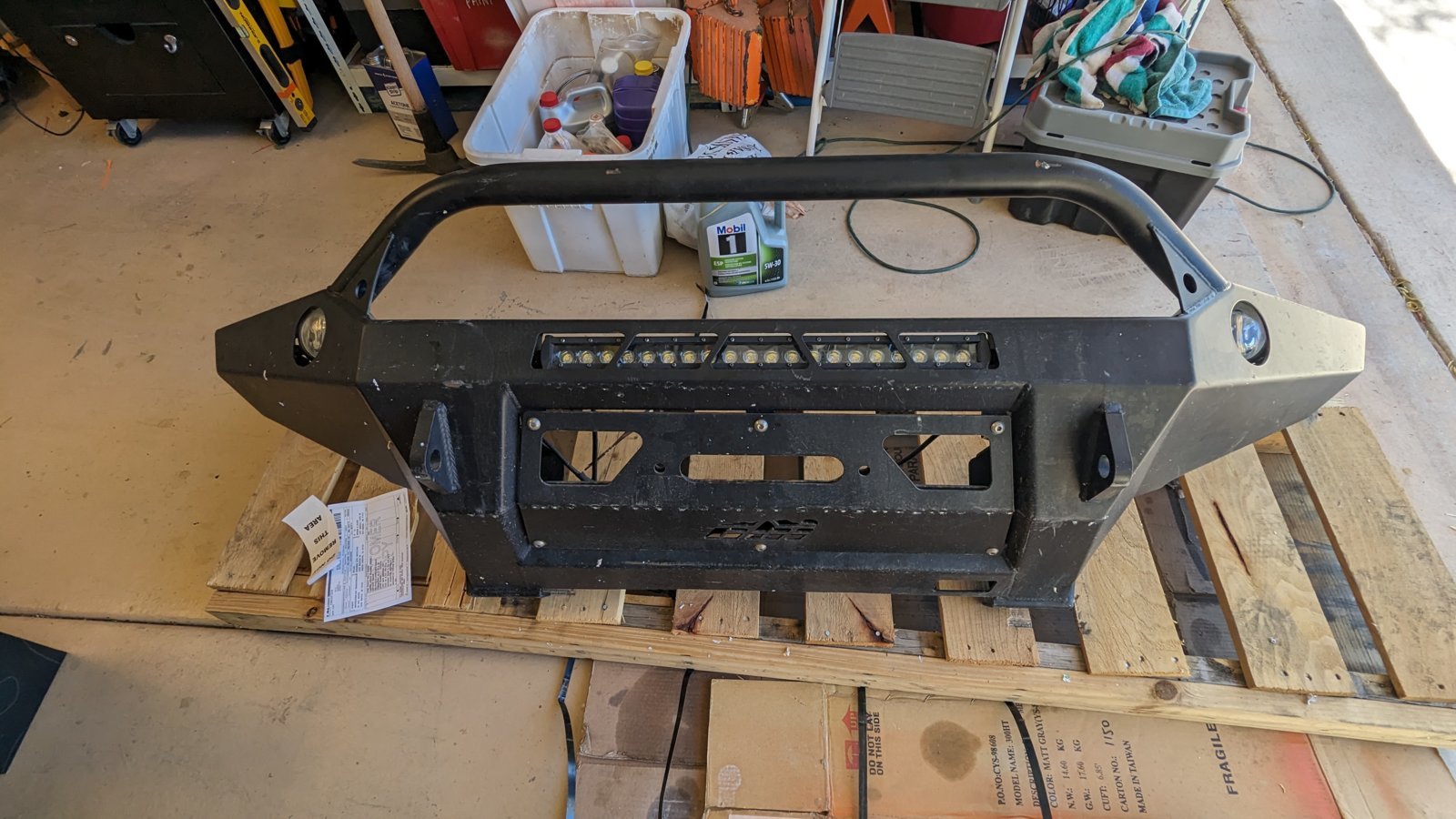

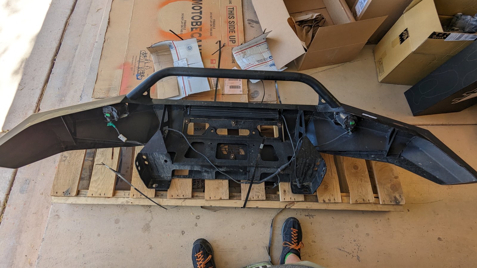

    I picked up a used CBI Baja Bumper from a truck that was rear ended a couple weeks ago and it showed up yesterday! I was pleasantly surprised to see that it came with a light bar and fogs:
    It didn't come with the relocation bracket for the power steering lines or with the frame brackets. I can work up something myself for the power steering lines but are those frame brackets needed if I won't be winching?

    The relocation is only for the winch body I believe. I installed two brands of bumpers and either came close to the cooler...only the winch. So you should be good.

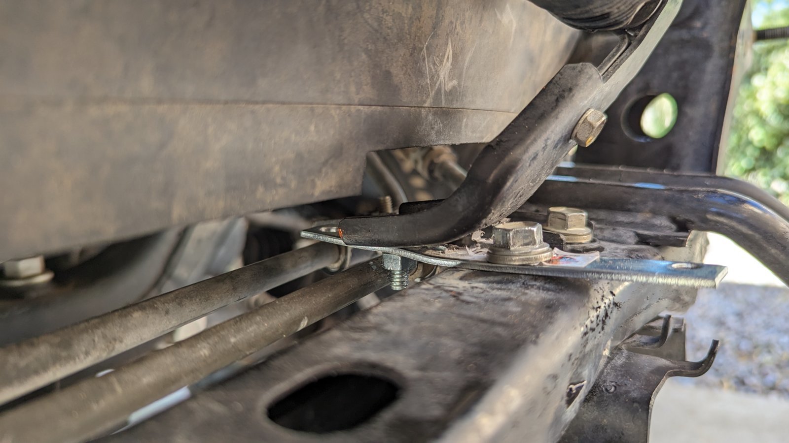

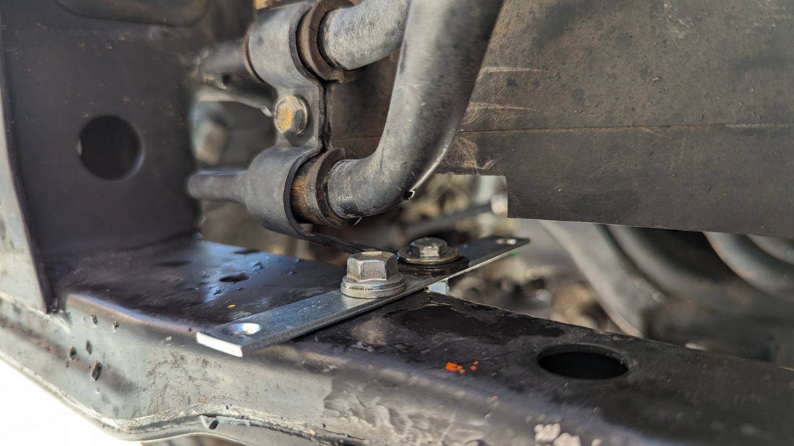

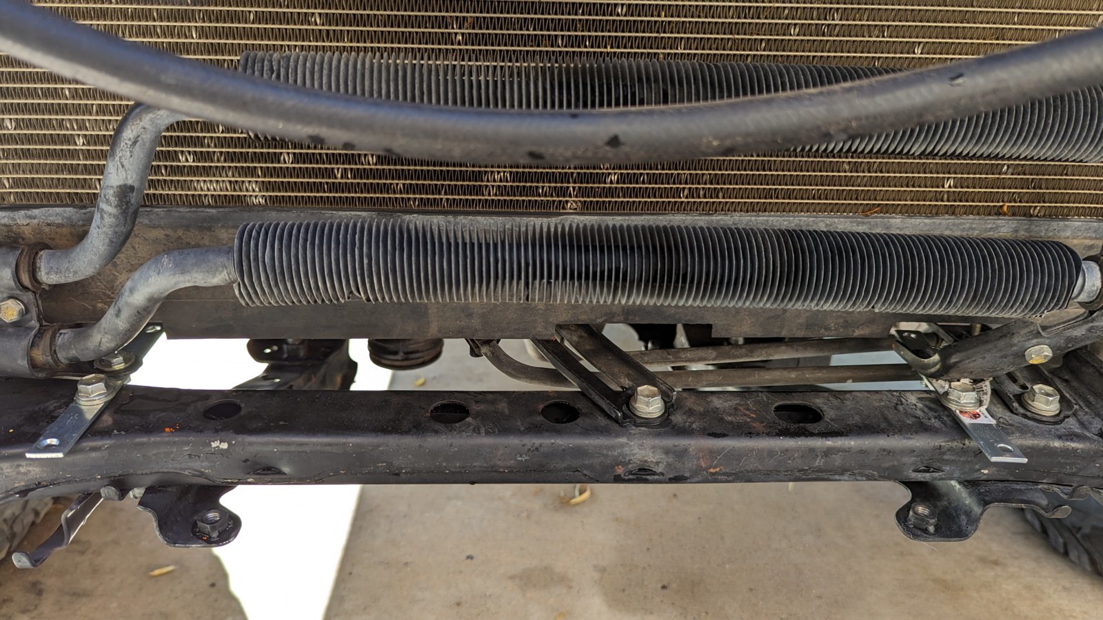

    Janky relocation brackets done.

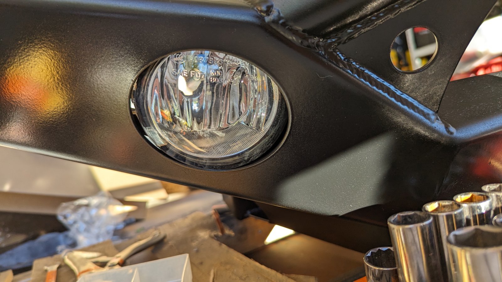

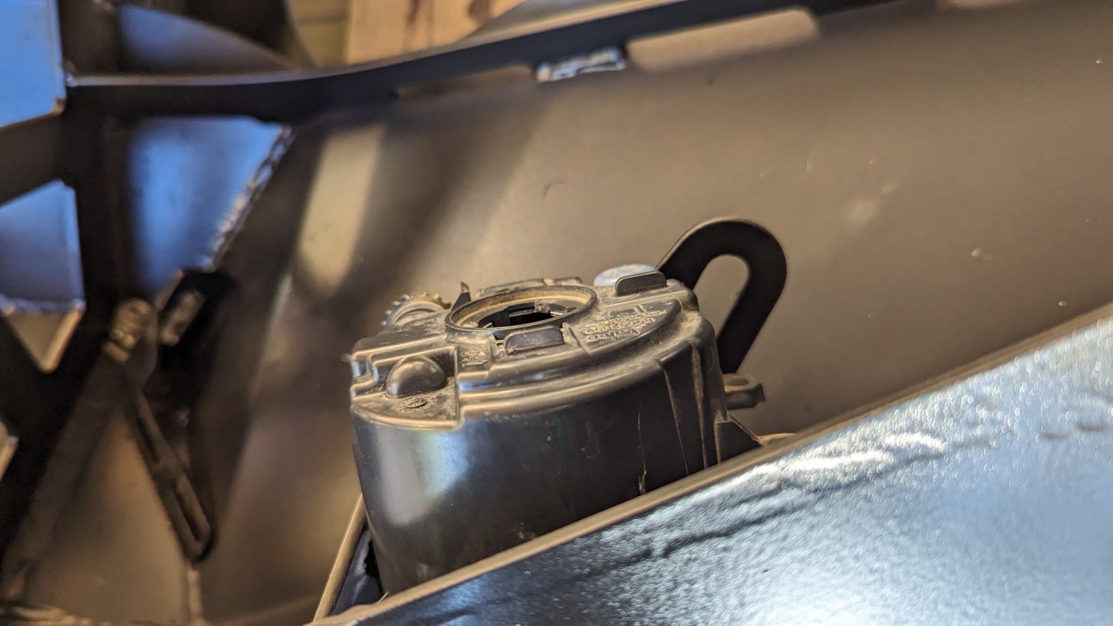

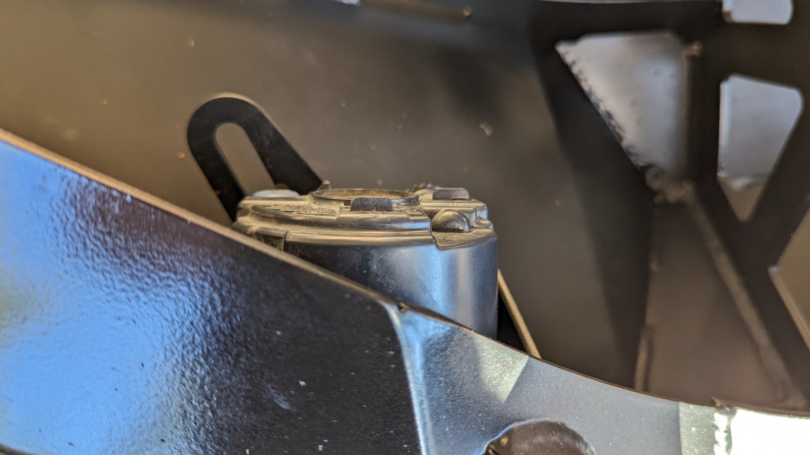

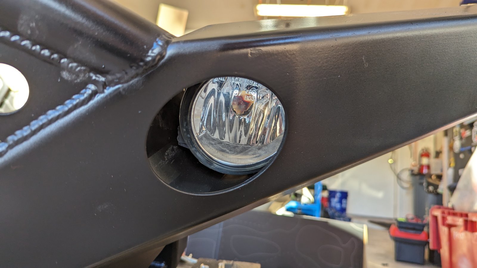

    Well, hit a snag - the fog lights seem to sit in different positions when I test fit them.
    The passenger side slides right in and sits against the bumper:
    The driver's side sits considerably further back:
    Whoever did the original install didn't clip the inner tabs so they sat back considerably further. Does anyone have photos of how they're intended to sit?
