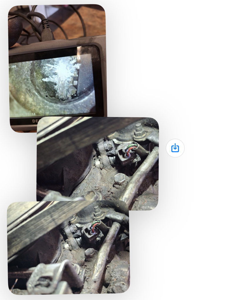

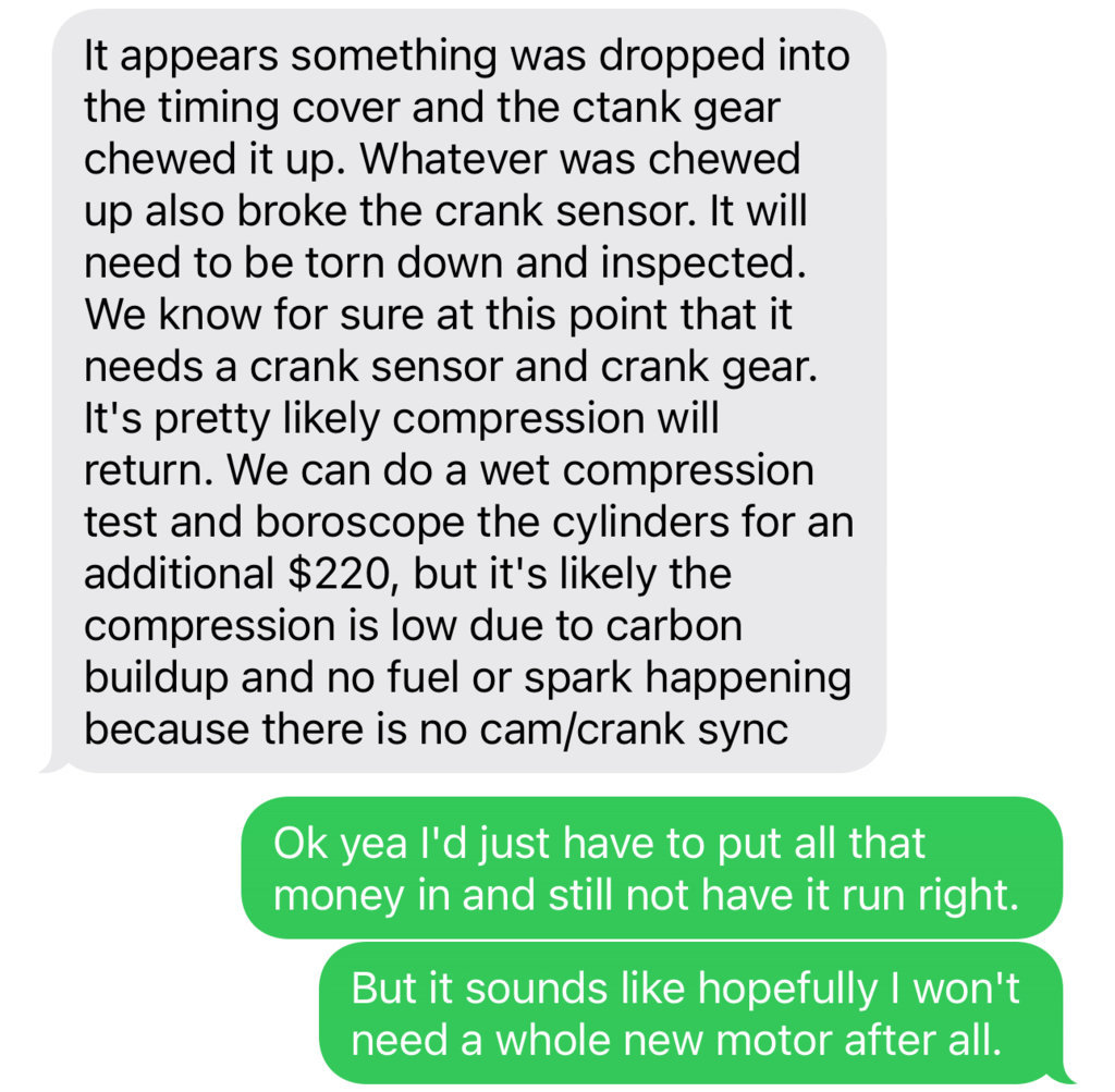

    This is the latest from the new mechanic I have the truck at. I’m trying to decide if I should have him look with a bore scope and do a wet compression test etc., or just say go ahead and fix the crank gear. I’d hate to put the $900 he quoted into it and still not have it run right. He did say the compression would probably come back after it starts getting gas, but it’s hard to know for sure.
