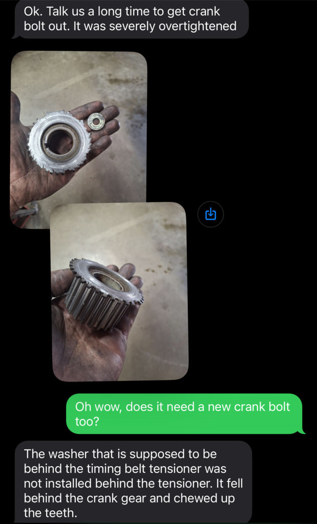

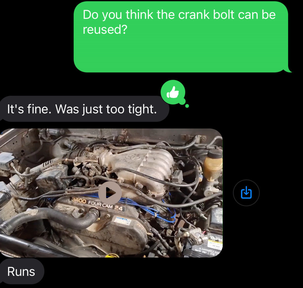

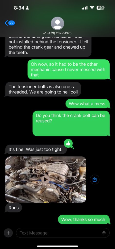

    It turned out the first mechanic was even more of an incompetent hack than I thought..
    These are my texts with the new mechanic cleaning up the other guy’s mess.

    Damn. "Way too tight" on the end of the crank isn't exactly good. What a shit show.

    I may be wrong, but I thought the crank bolt was a one time use only. How expensive can it be to replace.

    The truck is running and driving again after the washer begins the crank hear was removed, and the crank gear and sensor were replaced.
