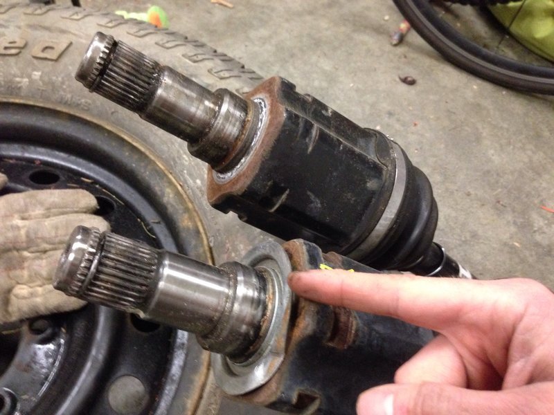

    i picked up a couple axles from a wrecking yard but one of them is missing a steel sort of cup of washer that the other has. Is this a replaceable part? It's a thin sheet metal piece and on the other axle it's pretty bent up are these useable? In the picture im pointing the washer / seal thing on the axle that has it.

    yes you just press the old one off, they cost a couple bucks from the dealer

    Toyota PN is
    4133604010

    Replace the one you're pointing at while you have it out. They bent it when they pried the axle out.

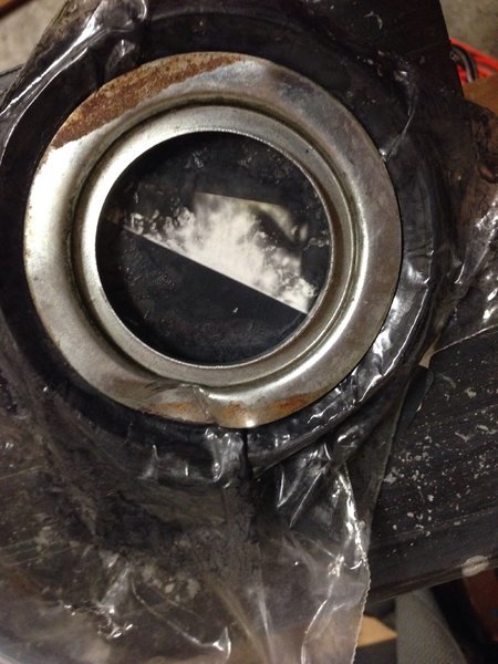

    So here is what they gave me when I went to toyota, definitely not the same. Is this another dust seal I need to replace?
    2nd picture is the metal shield I removed sitting inside the metal/with foam insert and greased one they sold me.

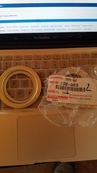

    This shows up as boot kit cover and doesn't show it installed on te axle on the toyota parts site. It should show it installed between axle and edge of diff?? http://parts.toyotaofdallas.com/oe-toyota/4133604010

    That's definitely the part # and the part you need. I just ordered some from Toyota for my new cv axles20160425_112748.jpg

    Ah yes that's the one. For some reason on toyota of Dallas they don't call it dust cover. Thanks for the picture proof.
