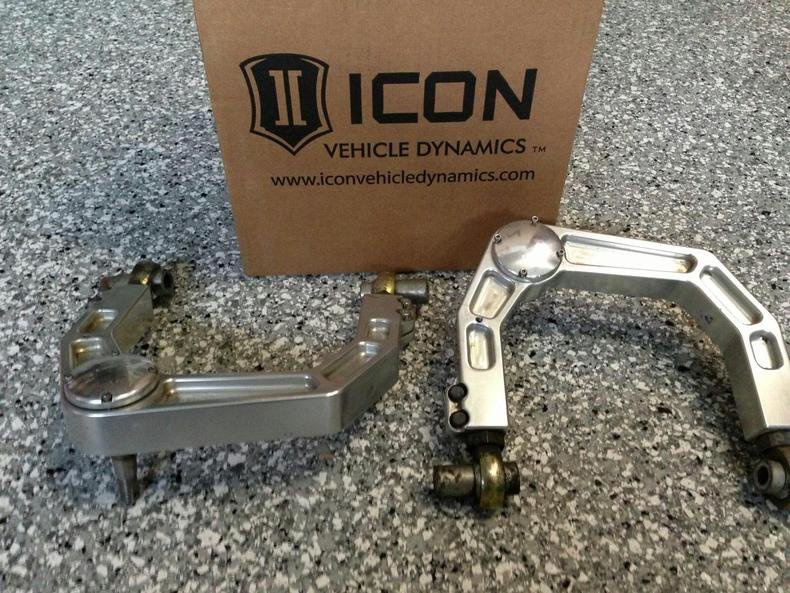

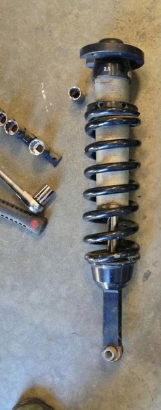

    Recently purchased a used Icon (actually DR) mid-travel set up for my 2005 TRD OR 4x4 Access Cab. The kit is in great shape (although a little dirty in the pictures) and included the following parts:
    Front:
    · Icon C/O’s (part # 58635) – extended travel
    · Icon Billet UCA’s (part # 58550)

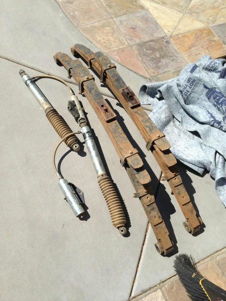

    Rear:
    · Icon 2” VS RR Rear Shocks (part # 56503R)
    · All-Pro Expo Rear Leaf Pack (part # 4505T-AP-3EX-PR)
    All the Icon stuff has ~15-20k miles on it. The C/O’s just got rebuilt 3k miles ago, at the same time the bearings in the UCA’s were replaced (0 miles on them since), and the leaf pack is brand new (the one in the pics is his used OME leaf pack).
    I’m getting ready to do an install but wanted to ask the TW community if I’m missing anything that I should order before tearing into it (i.e. new hardware, u-bolt flip kit, ext brake lines, sway bar relocation bracket, different bump stops, ect)? Also, is there any recommended cleaning and lubing before the install.

    The top hats on those front coilovers have been known to break, I would look it over thoroughly to make sure they are structurally sound.

    I've seen a few posts about that. They're currently off the coilover so I'll give them a thourogh inspection for any stress fractures and such.
    What about cleaning up the aluminum and making them look shiny and "new"? Any input? What do you guys use?

    UCA pivot bolts.
    You mentioned, Sway Bar mount, only if you plan to keep it
    Pull the lower cams and lube them up even though you have those adjustable uca

    I believe those are the old school rebranded edelbrock rear shocks. I do not believe that they will work well with the AP Expos as they're only good for 0-2" of lift. Might want to double check...
