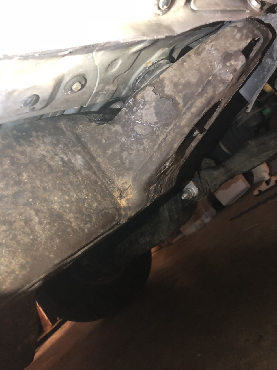

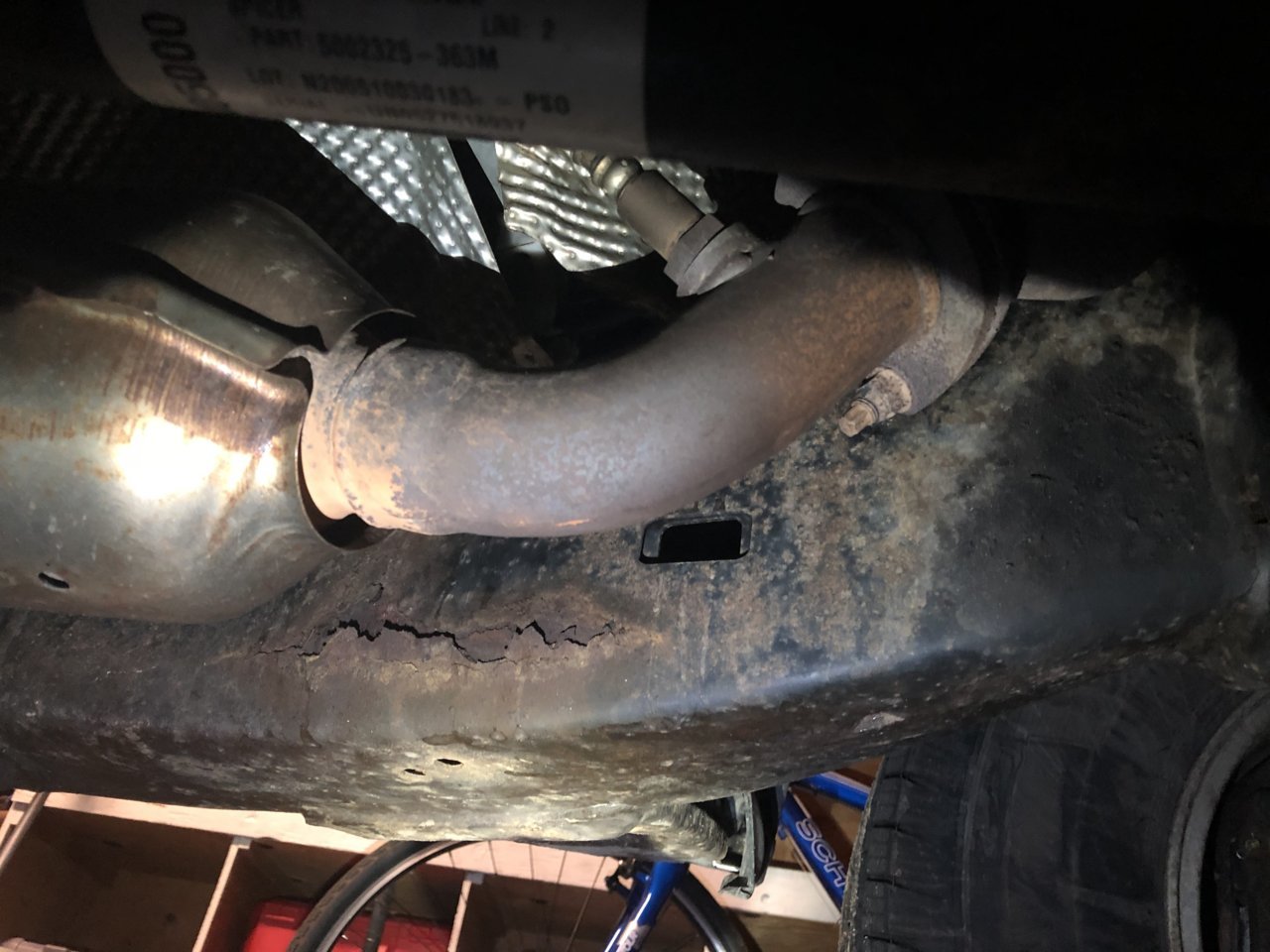

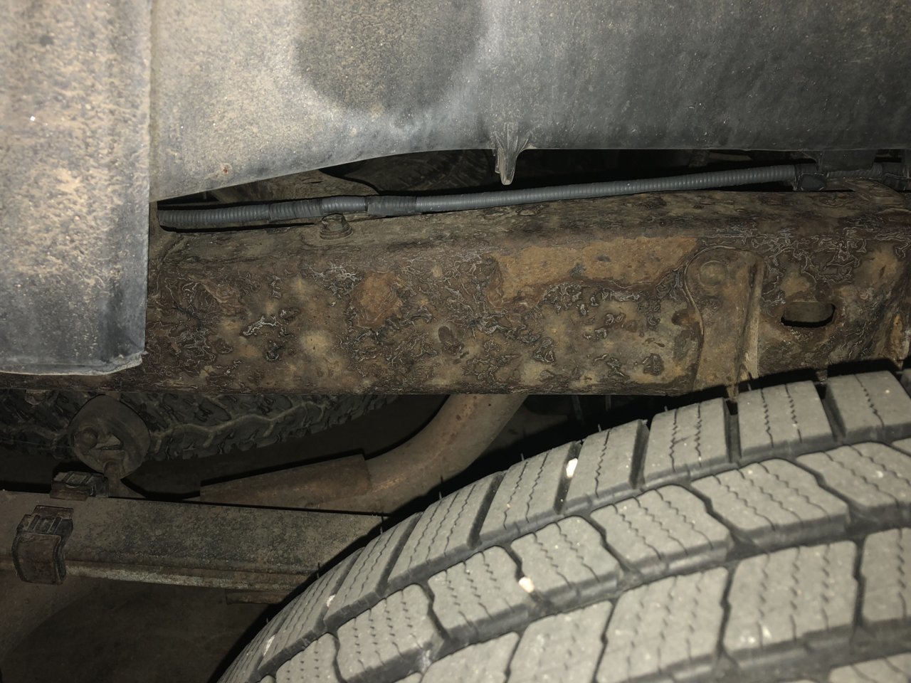

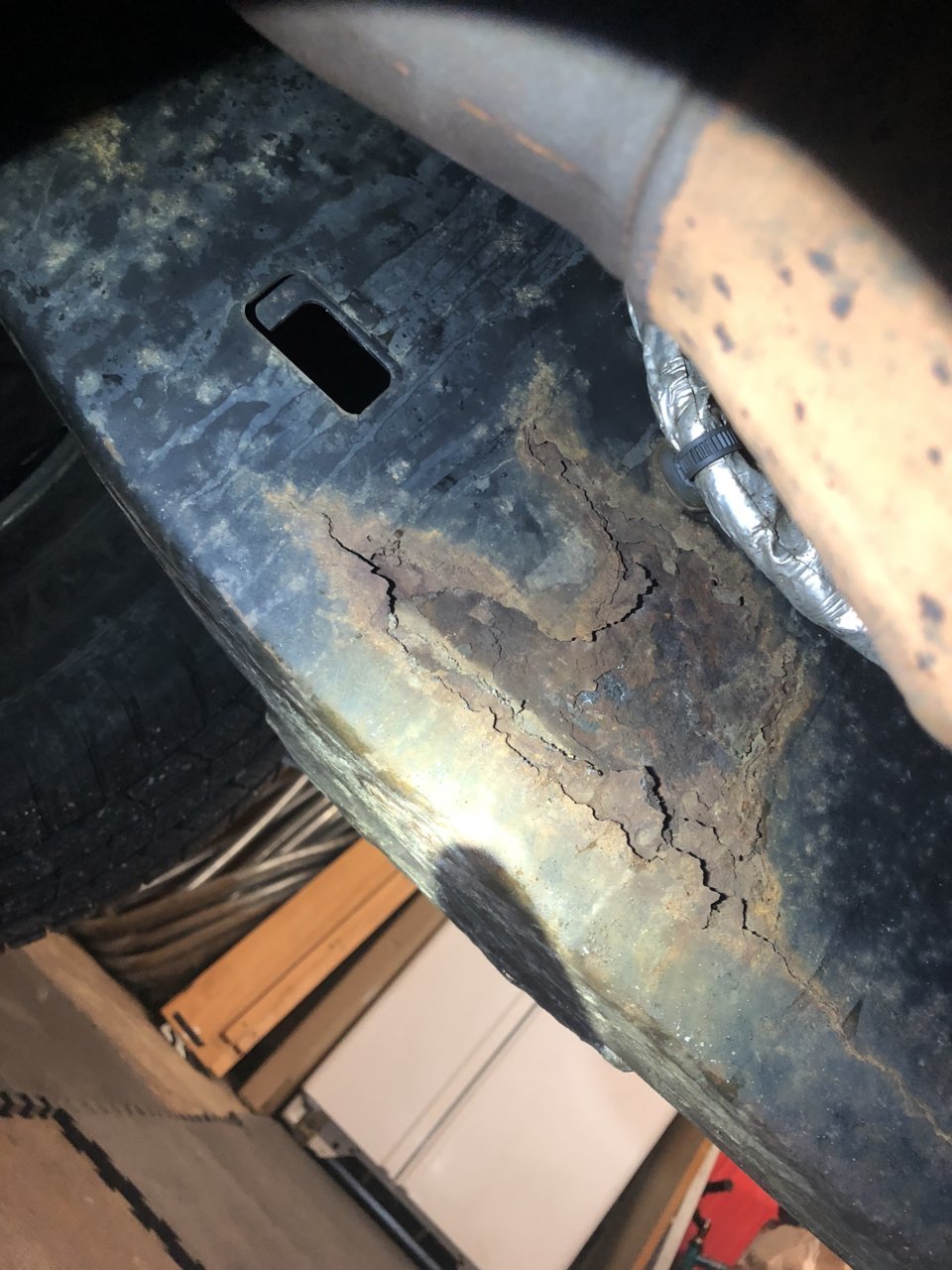

    Hey guys, first post here :) Any help is appreciated
    I've always wanted a Tacoma, I see them everywhere here in Colorado. About a week ago I bought a 2006 SR5 TRD Off-Road Tacoma from an independent dealer. I thought I was getting a great deal because it was a 1 owner truck, with a thick folder of maintenance records going back to the original purchase. 175,xxx with documented oil changes every 5k, multiple diff services, transfercase service, etc. Came with a topper, interior and exterior very clean.
    I've had it for about a week, and hadn't noticed any issues, until I started reading about the rust issues mentioned throughout this forum. Upon closer inspection I'm starting to get very concerned. I've attached pictures of the worst spots. Does that count as a "frame crack"?
    How worried should I be? Is there any chance it would be eligible for the Toyota frame recall? Not seeing that they coated the frame in the records. I'm willing to get busy brushing the frame and coating it myself, but I'm not sure that would even help it. Would it be worth it to pay for the frame replacement if it comes down to it?
    I was so excited finally getting something to take me out on some nice trails, but now I'm not sure how to feel. Hoping I didn't made a big mistake. I bought it for 12k... saw a lot of similar prices for Tacomas that didn't have the same history. I know I'm the dummy for not checking on the rust up front. :(
    I know pictures aren't that helpful, I've already called Toyota to try and set up a frame inspection.
    I'd love to hear your thoughts, thanks!

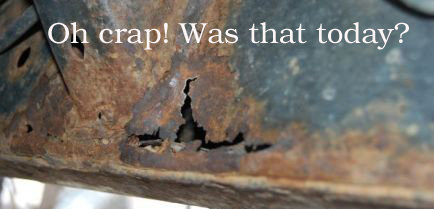

    Since you're in Colorado, you have about 30 minutes to get it inspected and approved for a free frame.

    Good thing you already called Toyota today before the deadline was up. Your frame will 100% no doubt fail by the cats in your 2nd and 3rd pics

    Thanks for the replies. It was purchased in and has been in Colorado it's whole life, since 2005. Sounds like replacement wouldn't be covered. It was serviced at the same shop it's whole life, up until this summer. I can't believe with how much the first owner put into it that the issue wasn't noticed / frame replacement already done. It's just insane he didn't take advantage of that. The dealer gave me a warranty on the engine/tranny only. Sounds like I'm screwed.
    What is really the danger of it, just the whole frame breaking and the truck not being driveable? I'll definitely look into some shops to see if I can get it patched up or reinforced. We don't really have any inspections around here, not even emissions. Looks like paying for a new frame is too expensive to be realistic. I want to love the Tacoma, still hoping I can get a long life out of the truck. Thanks guys!

    That truck is in horrific shape rust wise for a CO truck. It should not be rusting.
    I would try to get the dealer to take it back since they sold you it without disclosure. Or maybe get them to credit you some. Its not worth $12k with that level of rust.
    Frame swaps cost around $20k so its not practical for you to pay to do it.
    Now you may be able to clean it up and coat it and it will last you several years in CO.
    That owner must have taken his truck out of state frequently in the winter for it to look like that.

    Should of researched it here on TW BERFORE you bought,05-06 Tacomas also have engine mount and head gasket issues.I really do feel bad for you O.P.
    Do a professional patch job where the cats are,clean the frame up and coat it.
    The dealer was a idiot for not making you aware of the frame issue,but its your job to inspect before buying.

    RIP op missing the deadline by mere days
    Hit that first picture of the rust with a hammer if it thuds itll go through, if it makes a ping like sound start covering it up now. Or clean it up and sell it for a new taco

    You’re right lynlan1819. I actually did some research here, mostly saw people mention oil/diff/maintenance. I did see the motor mount issue as well, the engine was making a noise and a mechanic at the dealer replaced the motor mounts. I had him check the frame welds, he said they were fine, and I also didn’t see any issues there.
    I am bringing it in to Toyota today. I agree it’s worth a shot.
