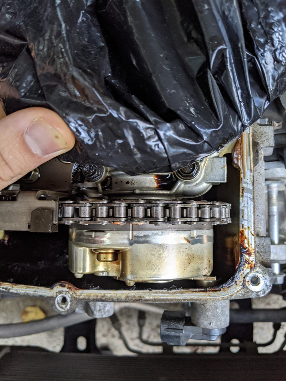

  6. Aug 9, 2023 at 9:02 PM
    #26
    Pyts
    Pyts [OP] Well-Known Member
    Aug 26, 2020
    #338854
    138
    09 2.7 RWD
    Stock
    Oh man, I didn't get a single notification for this!! I'll be reading through everything provided and responding. Thank you all so much!!
    I'm presently working towards changing the timing chain out, and when I finally get the cover off I'll scrape out as much sludge as I can.

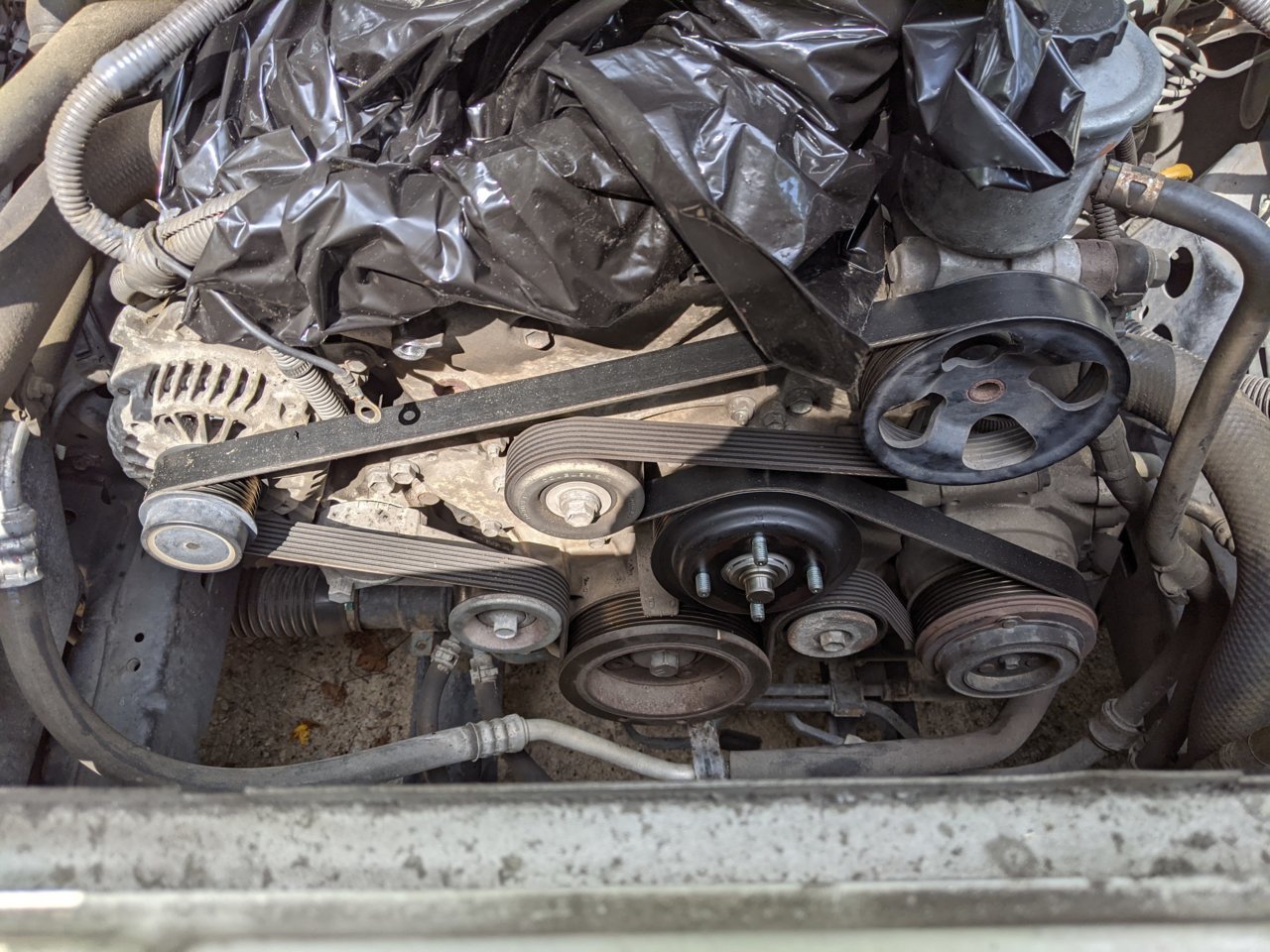

    Needed a special tool to hold the water pump/fan studs, so that slowed things down a bit, but the fan shroud is out!

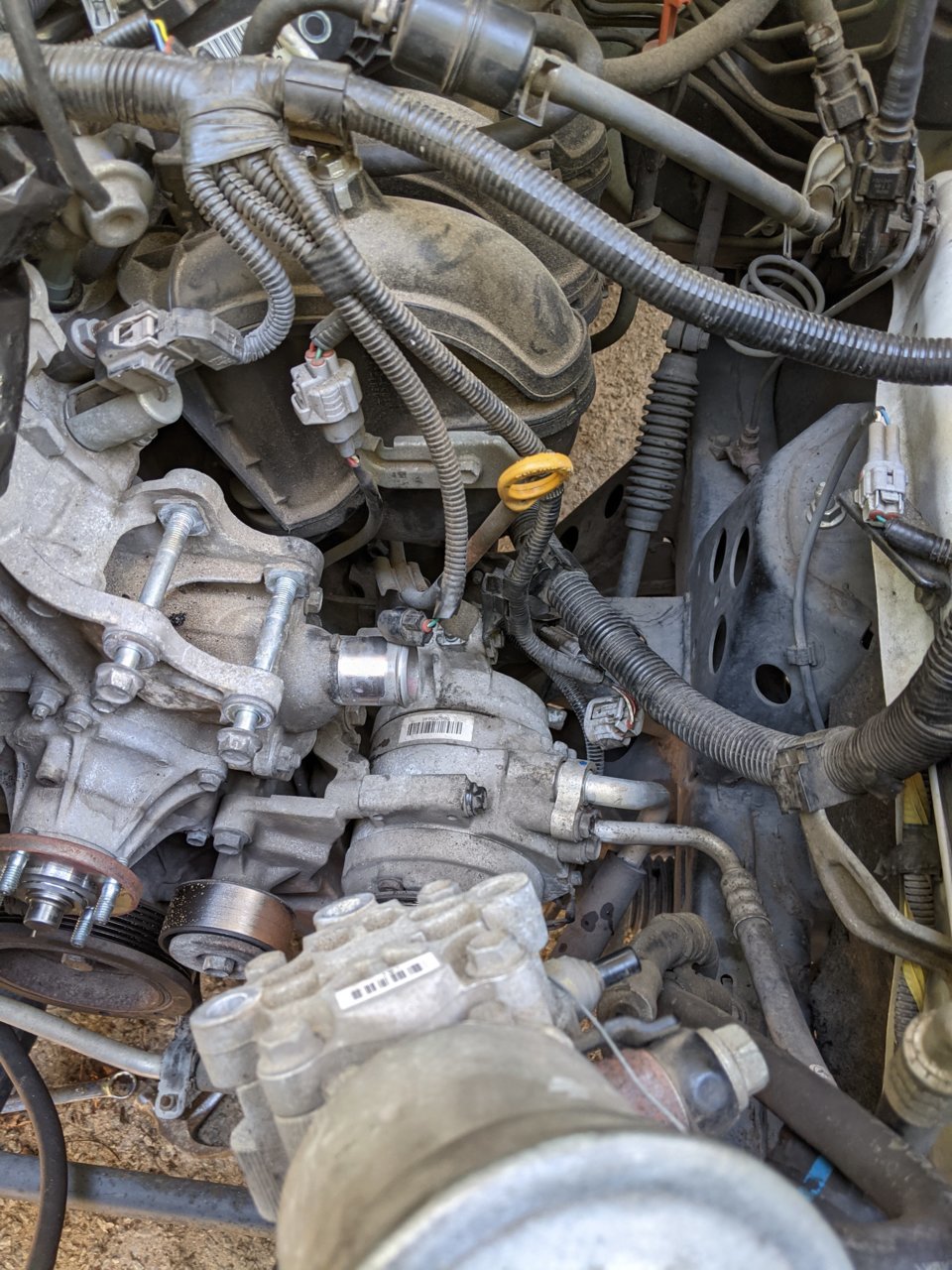

    Working towards the timing cover still, we got the alternator removed, and the power steering "vane" pump out of the way
    And the AC compressor is separated and hung too!
    But we got stuck trying to remove the harmonic balancer :( Tried holding bolts, and even making a 2x4 wood copycat of the holder tool to be able to break the big bolt in the middle of the balancer loose, but the wood split, the 10.9 grade m12x1.25 bolts bent, and yet another tool has been ordered. (Will show off the brilliant wooden feat of engineering tomorrow)
    I'll take some pictures of the timing marks tomorrow, and how the cam gears are lined up! They're just slightly incorrect, so I'll try giving the crankshaft a few spins to see if that's a certifiable problem or a rushed conclusion. I only got to mess with this kind of stuff once before, and it's lost to memory, so I may be jumping the gun entirely. Since it's being jumped, maybe we can fit in a cool spin or something before the crash landing.
    My girlfriend is reading through everything with me and we're doing our best to take all the great suggestions into consideration! Zero experience with sludge, really freaked us out.
    Although there is evidence of some sludge on the valves, I too am confused by the sheer volume seemingly restricted to the timing area. If it's accessible without too much trouble, we'll take the oil pan off and see if appearances are just that.

  14. Aug 10, 2023 at 5:18 PM
    #34
    Pyts
    Aug 26, 2020
    #338854
    138
    09 2.7 RWD
    Stock

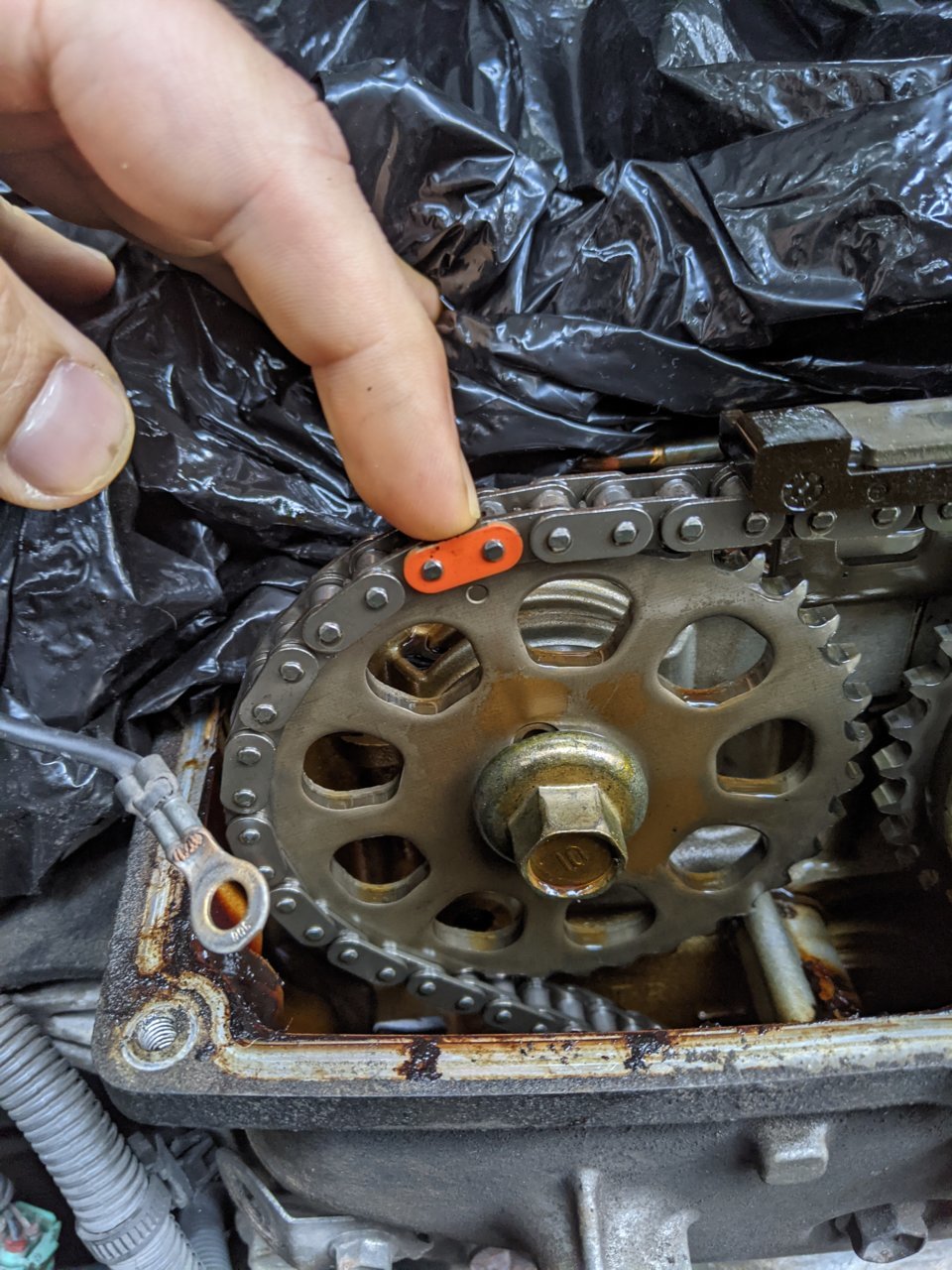

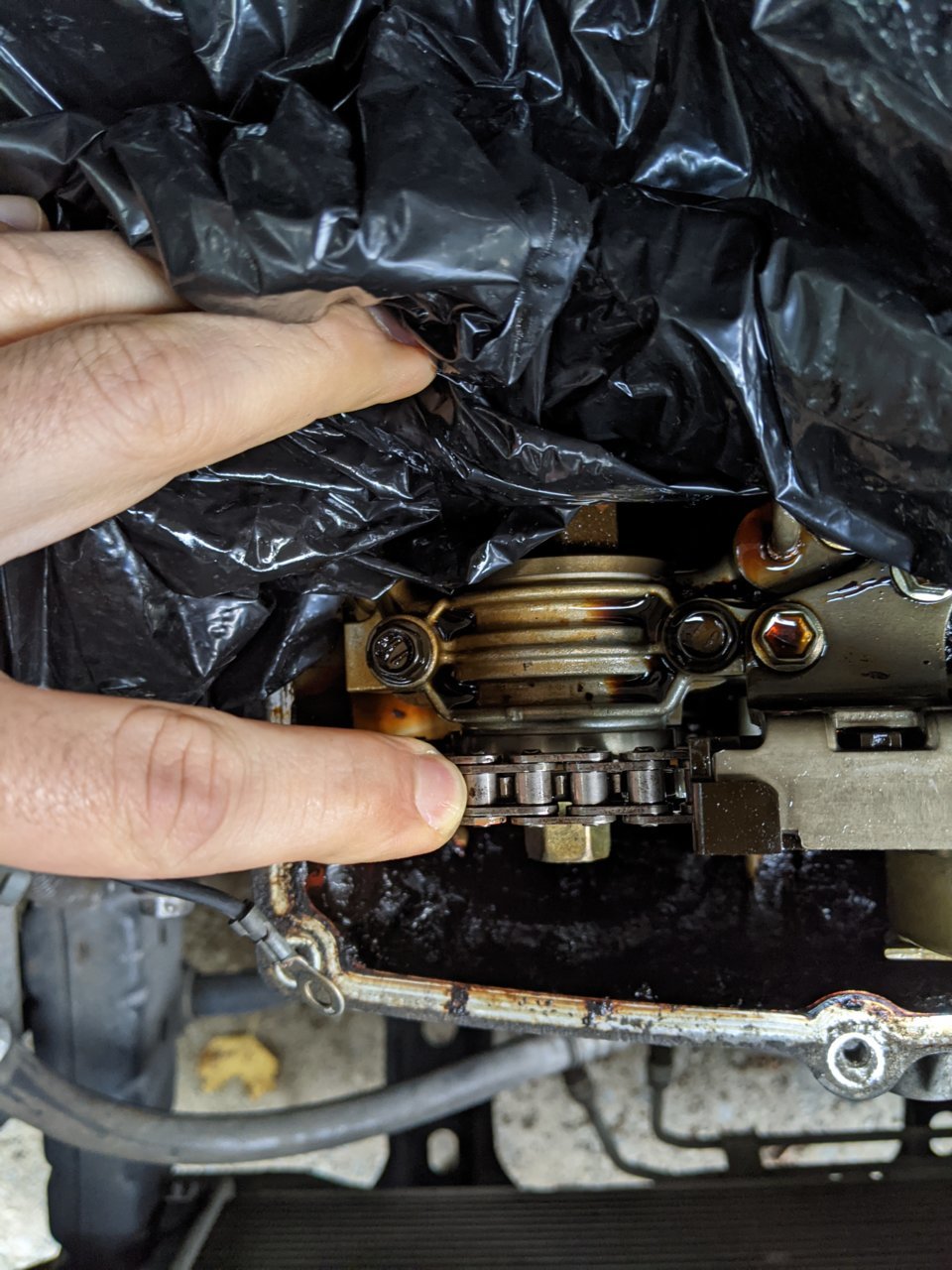

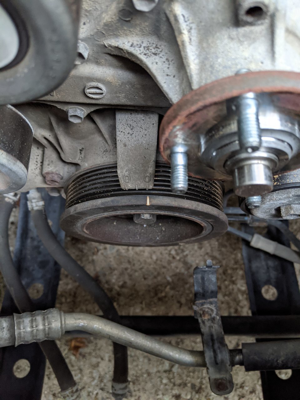

    Still waiting to get the tool for holding the harmonic balancer so that I can then utilize my balancer puller! In the mean time I got some pics of what I assume to be cylinder #1 top dead center as indicated by the harmonic balancer mark and almost by the cam marks.
    Awfully close on this one ⬇️
    This one, not so much ⬇️
    This one not so much...
    I was mindful of holding the phone camera directly straight to ensure nothing was exaggerated.
    To answer some questions, the engine air filter has been changed once immediately, and then annually since we got it. The South East doesn't give us much choice there as pollen paints our cars yellow each spring.
    And the spark plug tube gaskets will also be replaced as part of the valve cover gasket kit!
    Oh and here's the failed attempt at supplementing steel with wood. SHOCKINGLY I was able to thread the bolts into the balancer through it, their holes didn't deflect much at all! But that was a small victory within a grander failure.
  15. Aug 10, 2023 at 5:53 PM
    #35
    tak1313
    tak1313 Well-Known Member
    Aug 24, 2020
    #338673
    703
    2013 Base 2WD
    TO ME, that looks like sludge, but the engine doesn't look "sludged." You can see a portion of the valve train to the right of the pic, and it actually looks really good. I'm thinking it sludged in that area because of the bad gasket allowing oil to mix with moisture from the air over a prolonged time.
    I would clean the area the best I can and use a high detergent oil like Pennzoil Platinum to gently/slowly clean the engine. For MYSELF, as much as possible, I don't like using a harsh flushing agent right away when I get a new (used) vehicle because you never know what's going to dislodge and get stuck somewhere catastrophic - like the oil pickup screen.
    Slow clean allows the filter to do its job without getting gummed up and bypassing before you can change it.
    Pyts[OP] likes this.

    No luck with the balancer tool. I don't know if you can tell, but it didn't fit. JUST BARELY completely wrong.
    I really don't want to slap parts back on and bump the bolt loose via cranking, but that will be the last resort after my next genius idea.
    Washers a-plenty so that my bolts don't bend when I use the pulley holder that facilitated removal of the fan.
    I'll post up pics showing this incredibly humbling method.
    Was :censored: shocked to find ZERO tools that looked correct for holding the balancer. If anyone could refer one to me that they've used on the 2.7, I'd greatly appreciate it!
