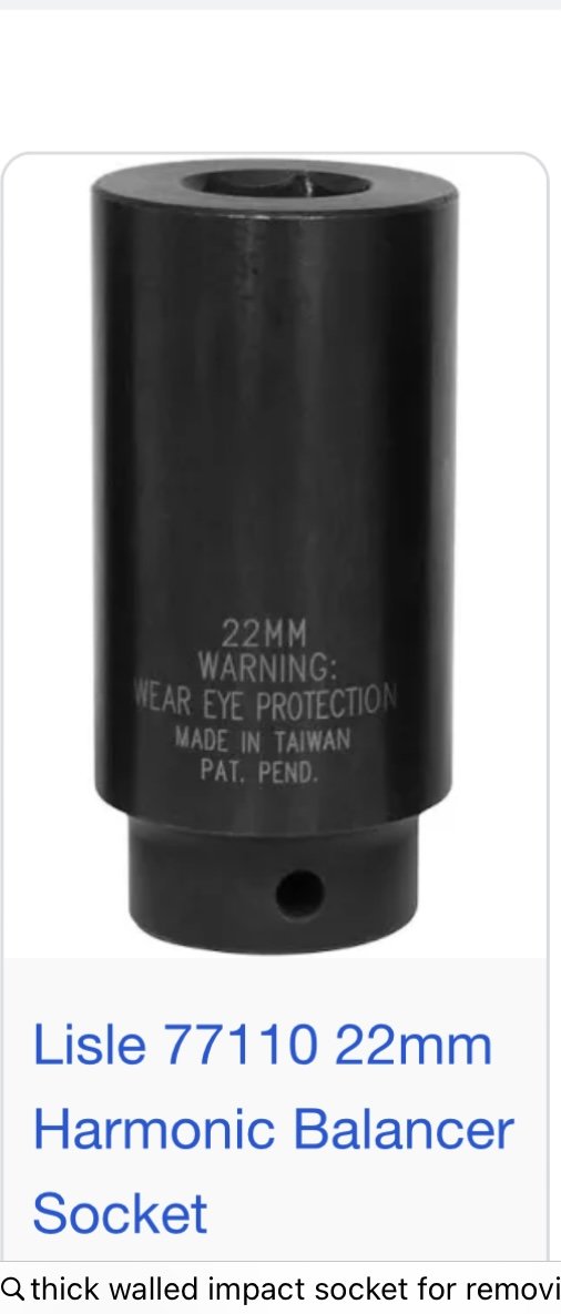

    Lisle makes a thick walled impact socket that works very well for removing balancer bolts if you can get an impact wrench on it. Napa may have it or local parts store or online.

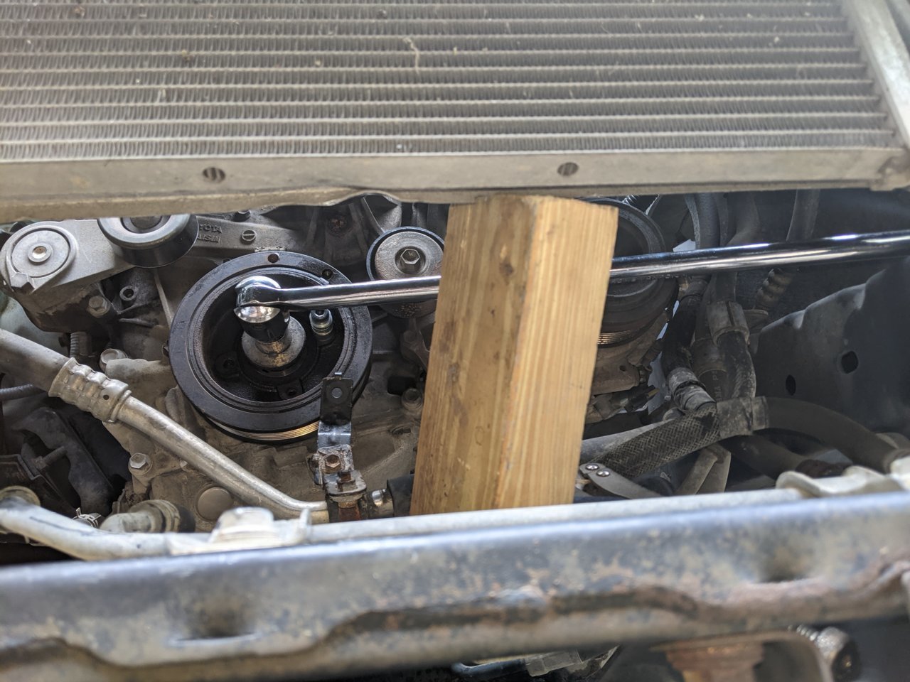

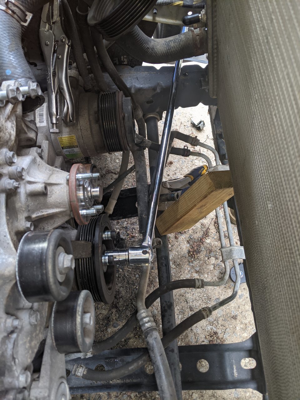

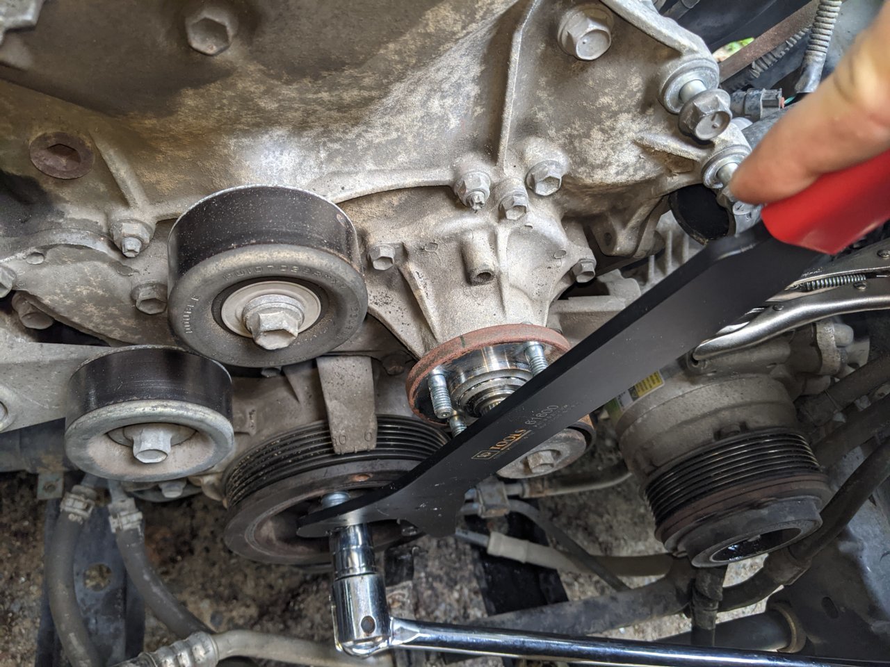

    I doubt yall need me to say it, but you were capital R right. I tried grade 30mm m8x1.25 "grade" 12.9 bolts, 19 washers per to give them some bend resistance, and tried my pulley holder with a breaker bar on the bolt. Ripped the treads out of one of the 4 holes in the balancer :boom:
    So I disconnected the radiator and plugged the ATF holes, lifted it up and tried my impact with a stubby 19mm socket and a wobble joint. No dice.
    Finally, without reassembling a damn thing, I hooked up the battery and set up my breaker bar on the frame to bump it. One good click was all it took. Did you guys hear it all the way over in smartypants land? It broke loose immediately.
    Here's how I had the radiator jacked for the impact. Ignore the breaker bar.

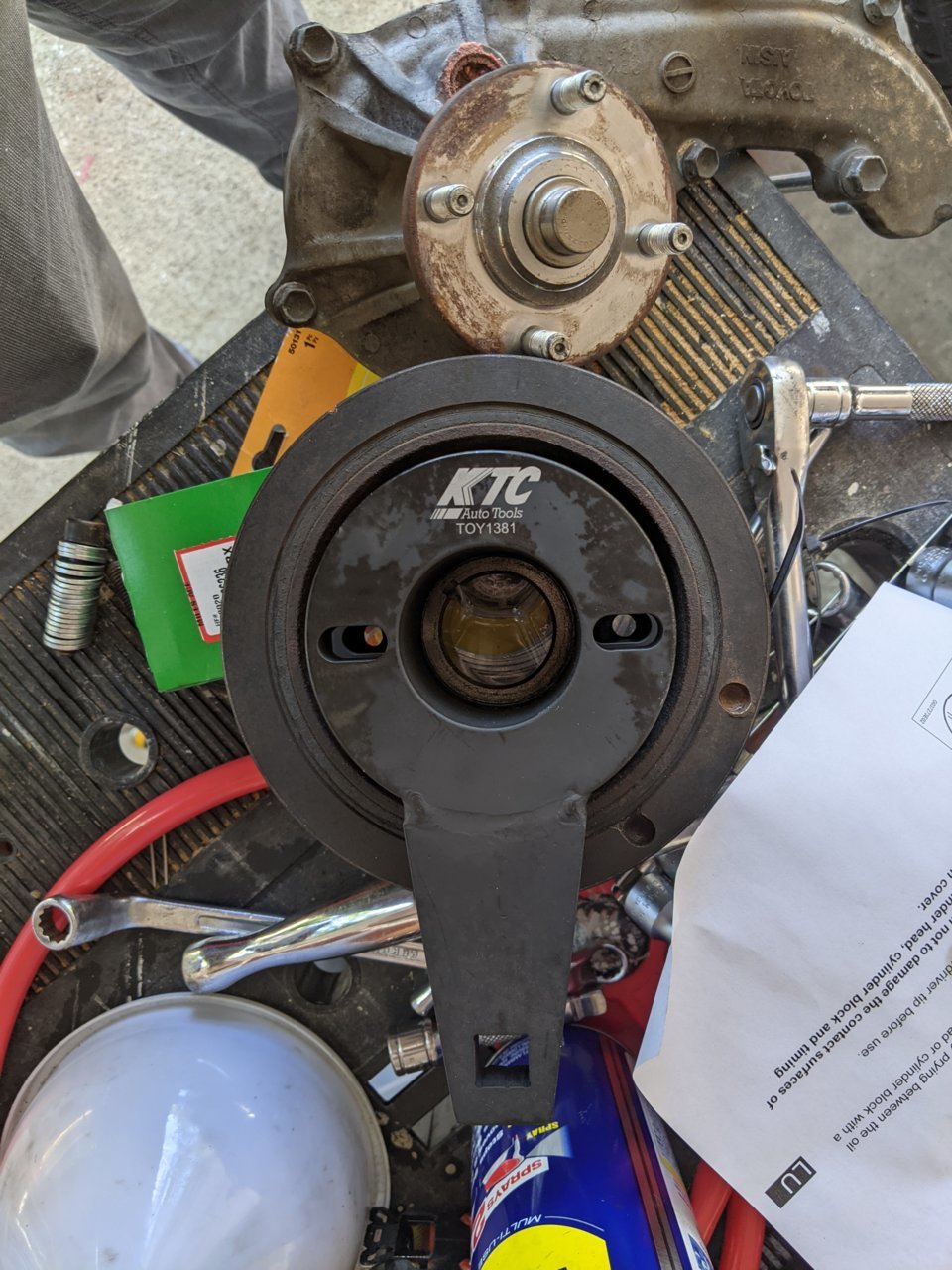

    Here's how I had my pulley holder on the washered up M8 bolts.PXL_20230813_195104322.jpg
    And here's the breaker resting on the frame as God intended.PXL_20230813_194847691.jpg
    I'm sorry, gang. I'll be proceeding and posting up more pics of the job just for the hell of it, and as payment for your assistance

    Btw, if you get the right pulley holder, you can use that to hold the pulley when you go to install the bolt back on.
    Pyts[OP] likes this.

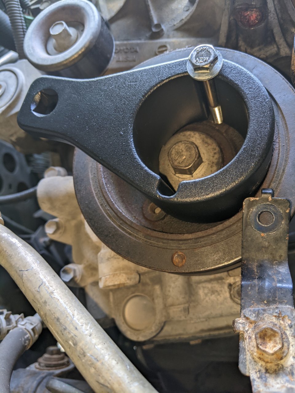

    Should be here soon and I'll get to see if it works.
    Here's the result of my creativity!

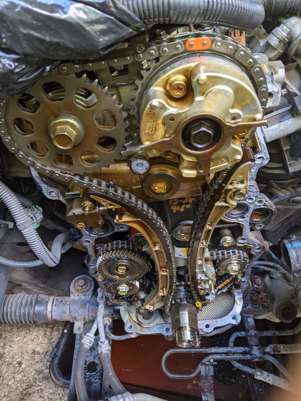

  12. Aug 15, 2023 at 5:26 PM
    #52
    Pyts
    Pyts [OP] Well-Known Member
    Aug 26, 2020
    #338854
    138
    09 2.7 RWD
    Stock

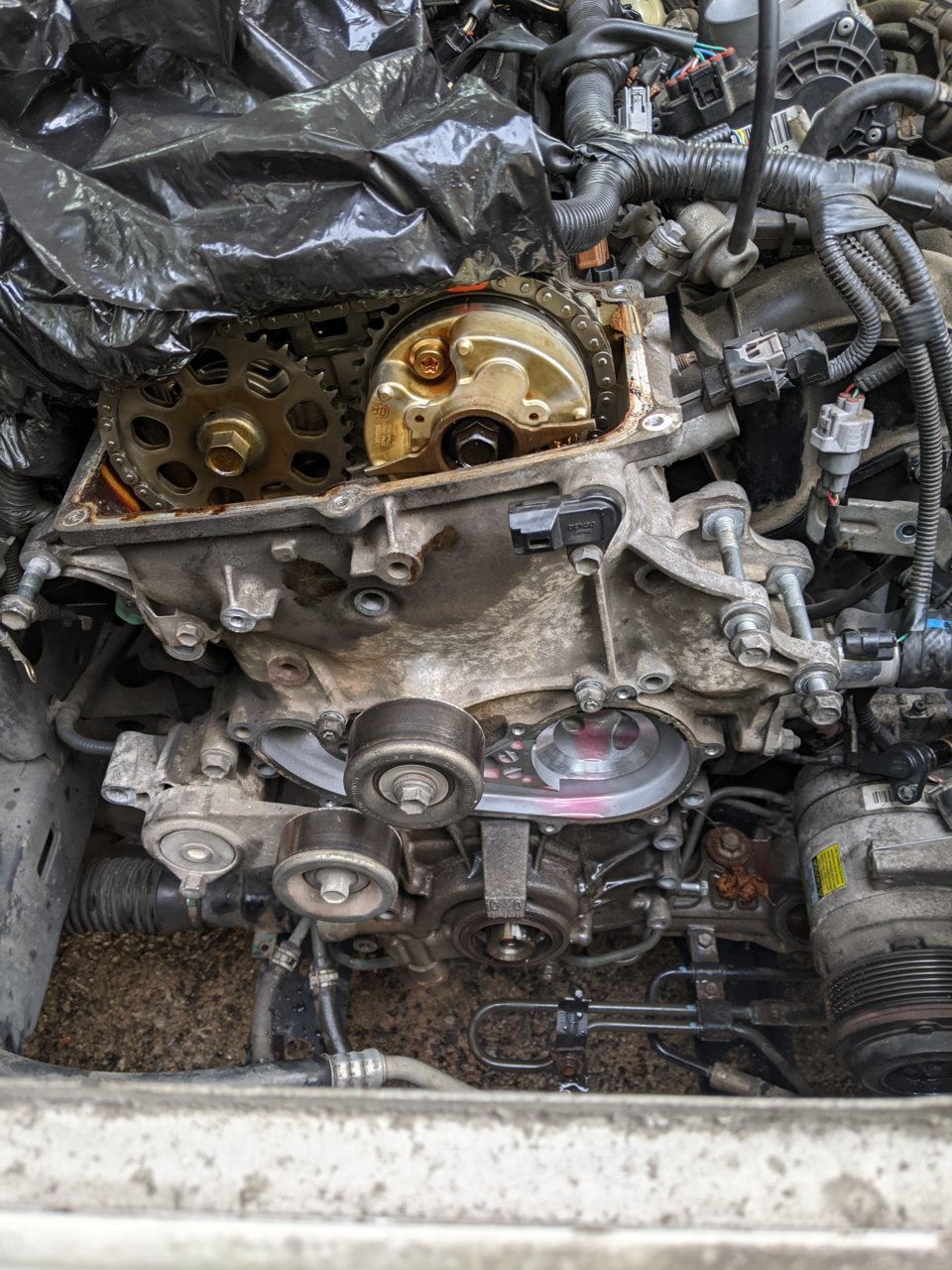

    Anybody know what I'm missing to get the timing cover off?PXL_20230815_234754195.MP.jpg
    Every bolt appears to be removed in accordance with the service manual, including the two behind the water pump outlet. The instructions are a little hard to follow as they intermix with full disassembly of the engine, and I'm already past budget.
    Is there anything, say, to do with the crankshaft or behind an idler pulley that I'm missing?
    I'll keep digging through the manual and try to endure an hour + long youtube vid on cover removal.

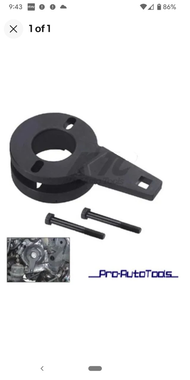

    SOME COOL NEWS!!
    The ebay tool I ordered is a match for the harmonic balancer!! PXL_20230816_172729877.MP.jpg
    AND it appears to be made by KTC (Kyoto Tool Company), part of Nepros. Ritzy Japanese Snap-On. Maybe it isn't legit... But regardless, it fits!!!
    Here's a link for anyone who might be interested:
    https://www.ebay.com/itm/2546824261...GwLoRjQSfa&var=&widget_ver=artemis&media=COPY

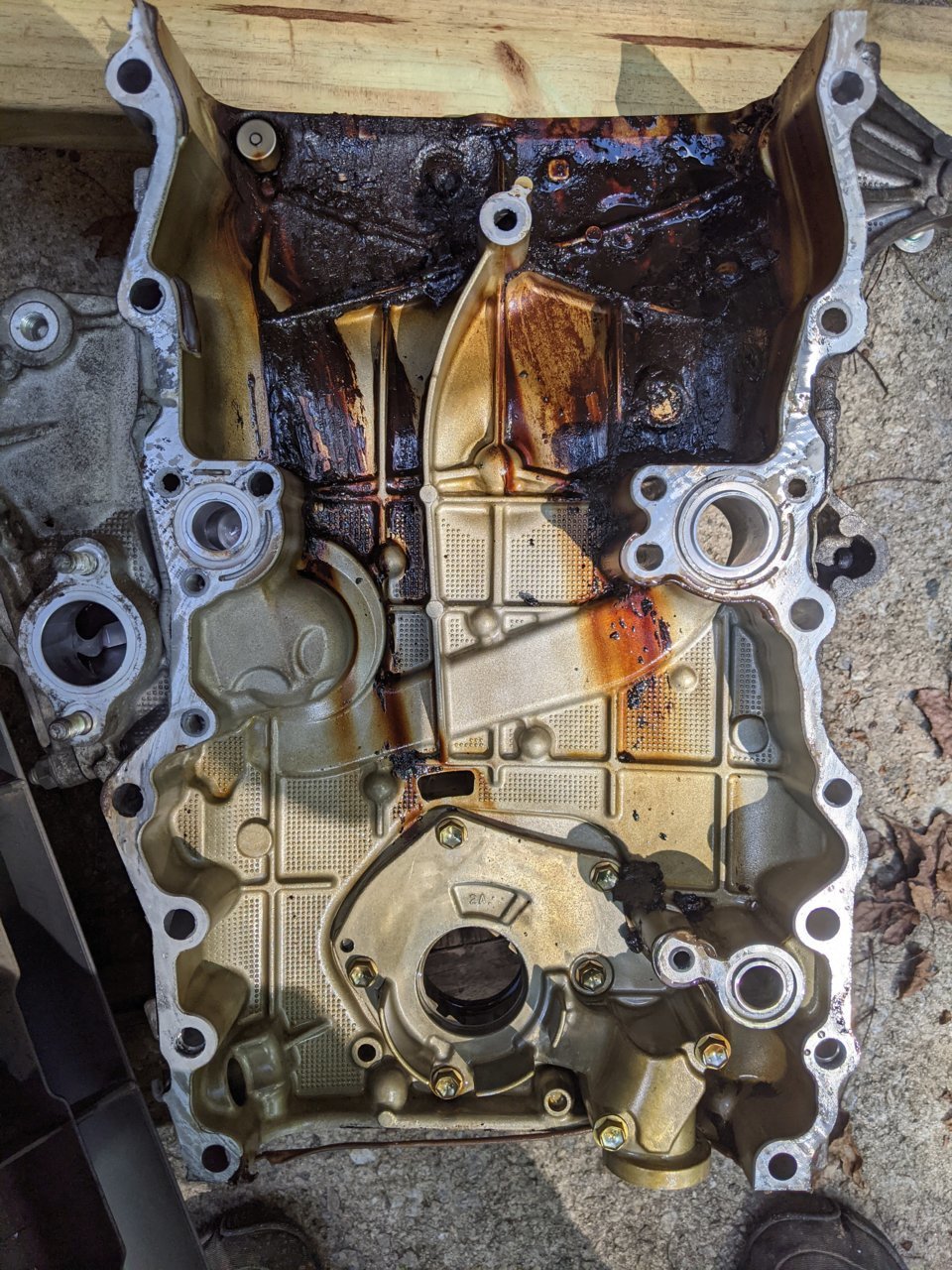

    Sorry for the dozen edits. thing added my pics wrong.
    @Steves104x4 Thank you kindly.

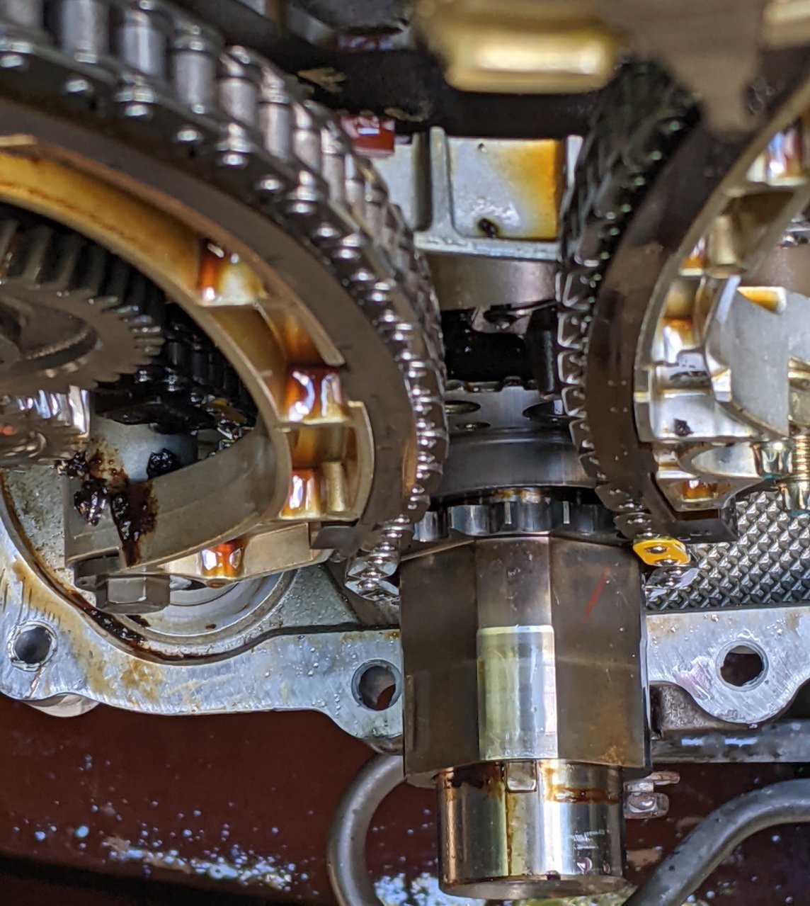

    All the sludge is at the top! I didnt wipe it or anything..
    Don't yet know why.
    Also, I just had to pry at the bottom corners to get the cover off. Well, that, and remove two studs which have external torx heads on 'em because the cover wanted to lean off, not pull straight off. The socket for said studs would be 6mm e torx, which I did not have. I did however have some long nose locking pliers... So those studs will be getting replaced with regular bolts.
    Can you tell I took an art class?

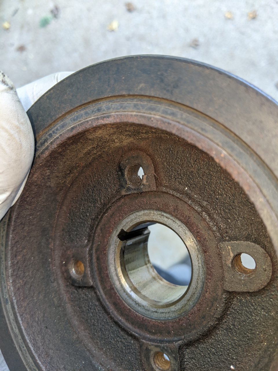

    Looks like the casting, on one of those bolt holes, broke partially.
  20. Aug 20, 2023 at 1:50 PM
    #60
    Pyts
    Aug 26, 2020
    #338854
    138
    09 2.7 RWD
    Stock
    @Torspd Sure did! Two nice cracks rendering that hole useless. I intend to run it still and replace it later if it causes a notable problem - not too hard to access.
