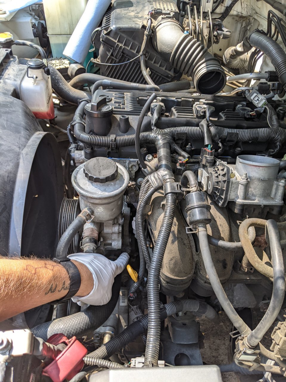

    I got the engine back together.
    Here's the youtube video of its first crank
    https://youtu.be/0B-VtevWlI0?si=pVfiu0k0o0XiDXxf
    I should probably walk you guys through the remaining process, as well as share more road trip stuff, end results (I think it's smoother but I have more troubleshooting to do).
    I skipped some picture taking for reinstalling parts for the serpentine system but I'll share what I got!

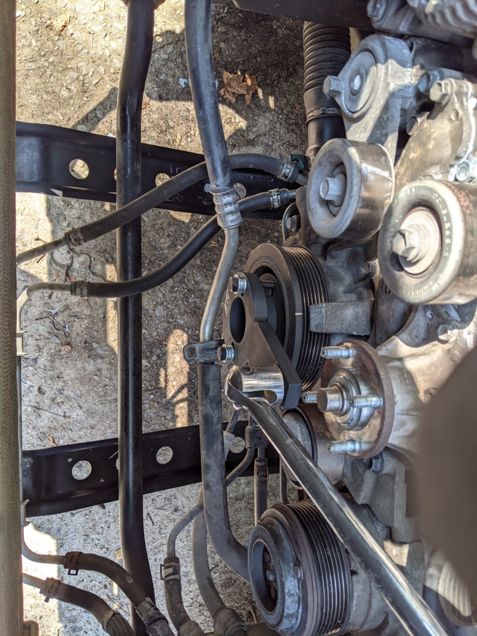

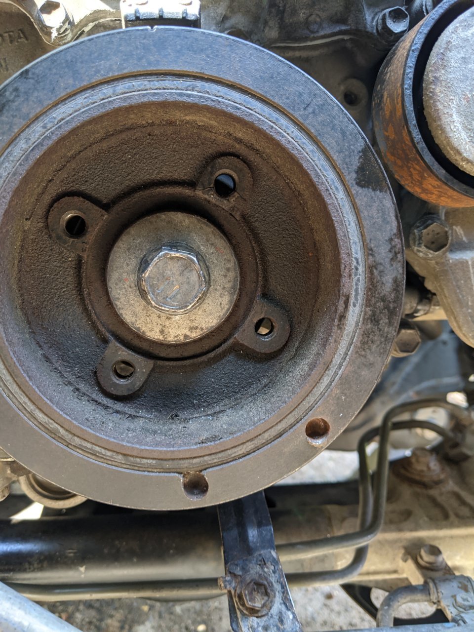

    Crank Pulley reinstalled using my fancy new tool
    Torqued it to 156ft.lbs. instead of the 190 I was recommended via the internet. I was worried I'd sheer off the bolts and for no good reason felt that was close enough. Sorry about the finger in there!

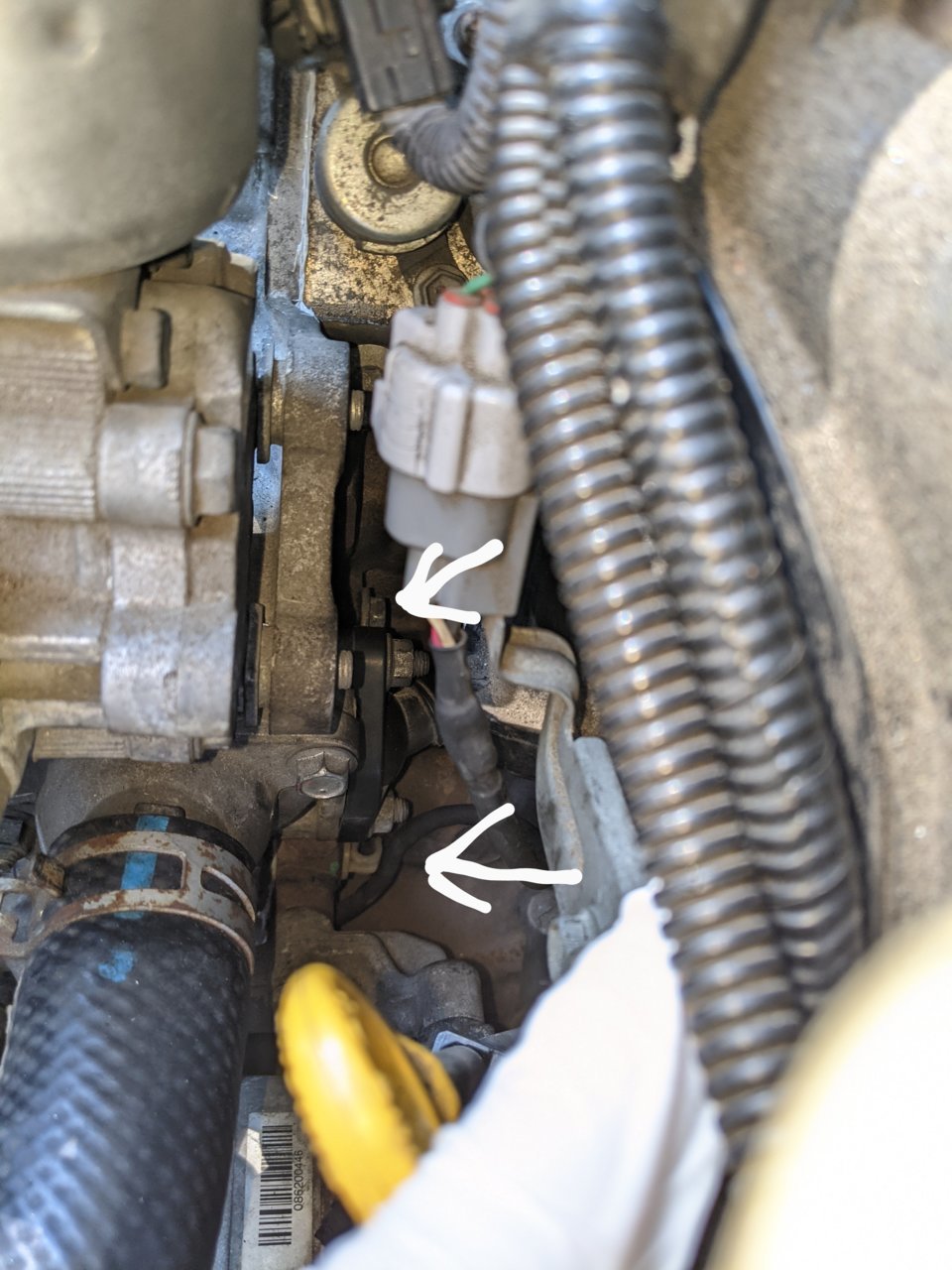

    Do note the damaged holes from previous attempts! But it's on.PXL_20230912_155954115.MP.jpg
    Oh, this is where those pain in the butt bolts are located. Shoulda taken off the intake. But I shoulda done a head gasket too, and lapped the valves (is that still a thing?)
    Here's the close-up

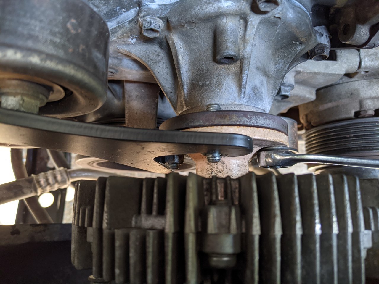

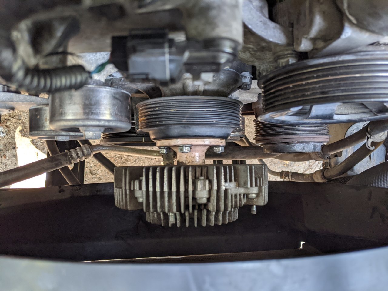

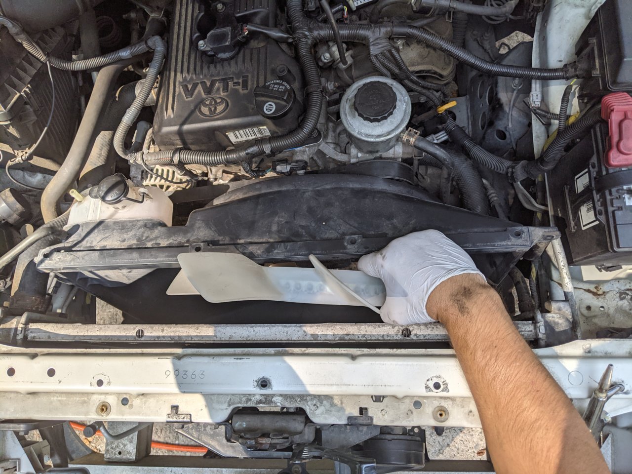

    Showing off my other new pulley holder installing the fan clutch
    PXL_20230912_161622844.MP.jpg Did you notice the problem?...
    I forgot to put the pulley on.
    Fixed (by the way, I had to buff the mounting surface of the fan clutch and lube it to get it to actually consent)
    I'd also installed the fan shroud. But I bolted it too soon. Needed to be able to move it to get the actual fan in!
    Something not shown above is my fight refitting the power steering pump. It required a rubber mallet (gently), a long prying flat head, and humility. Those moments can't be photographed.

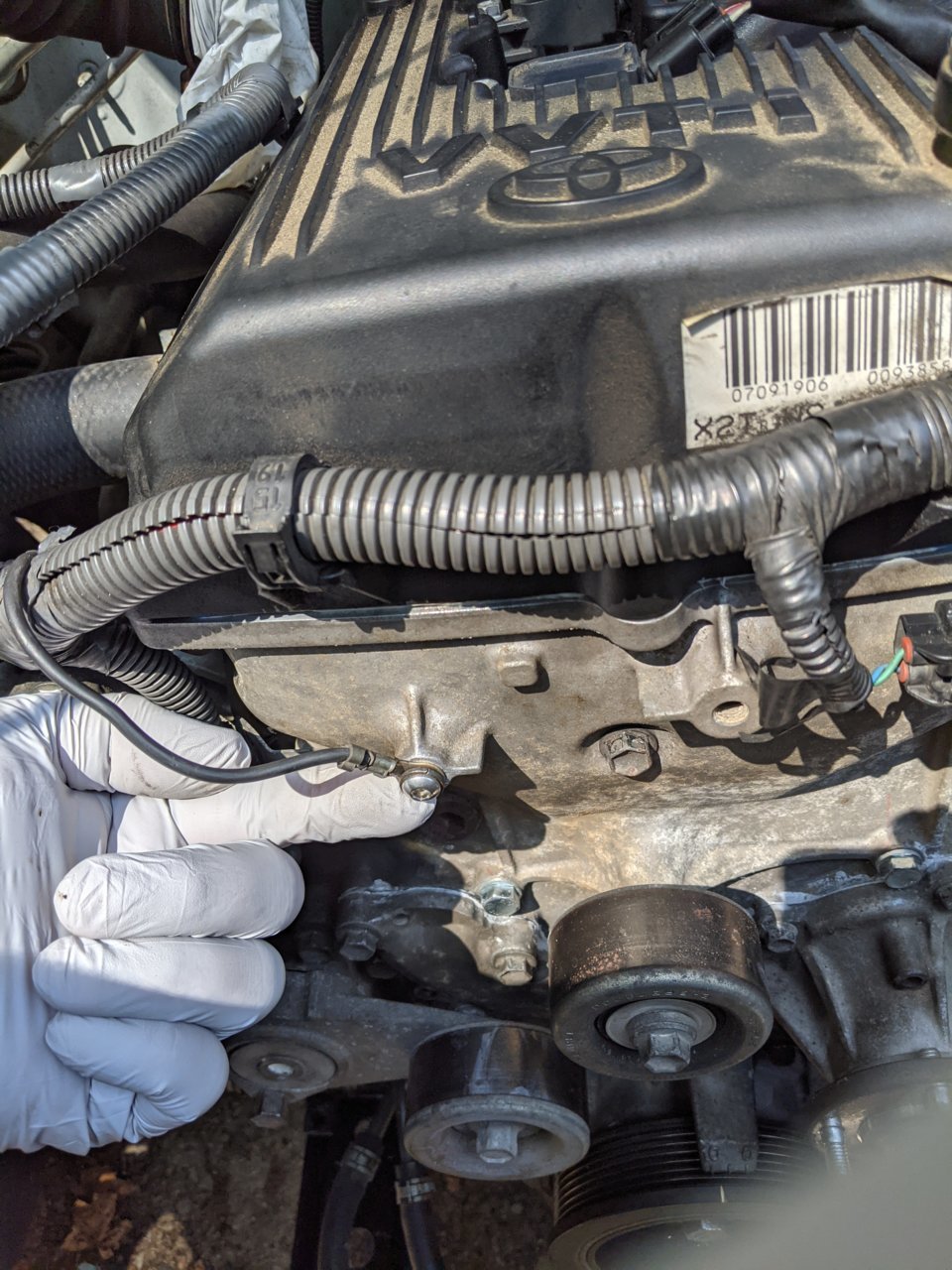

    Another casualty - lost bolt for assumed alternator grounding wire replaced.(recovered later from the concrete mixing pan I just used as an oil catch pan - available at home depot, highly recommend)

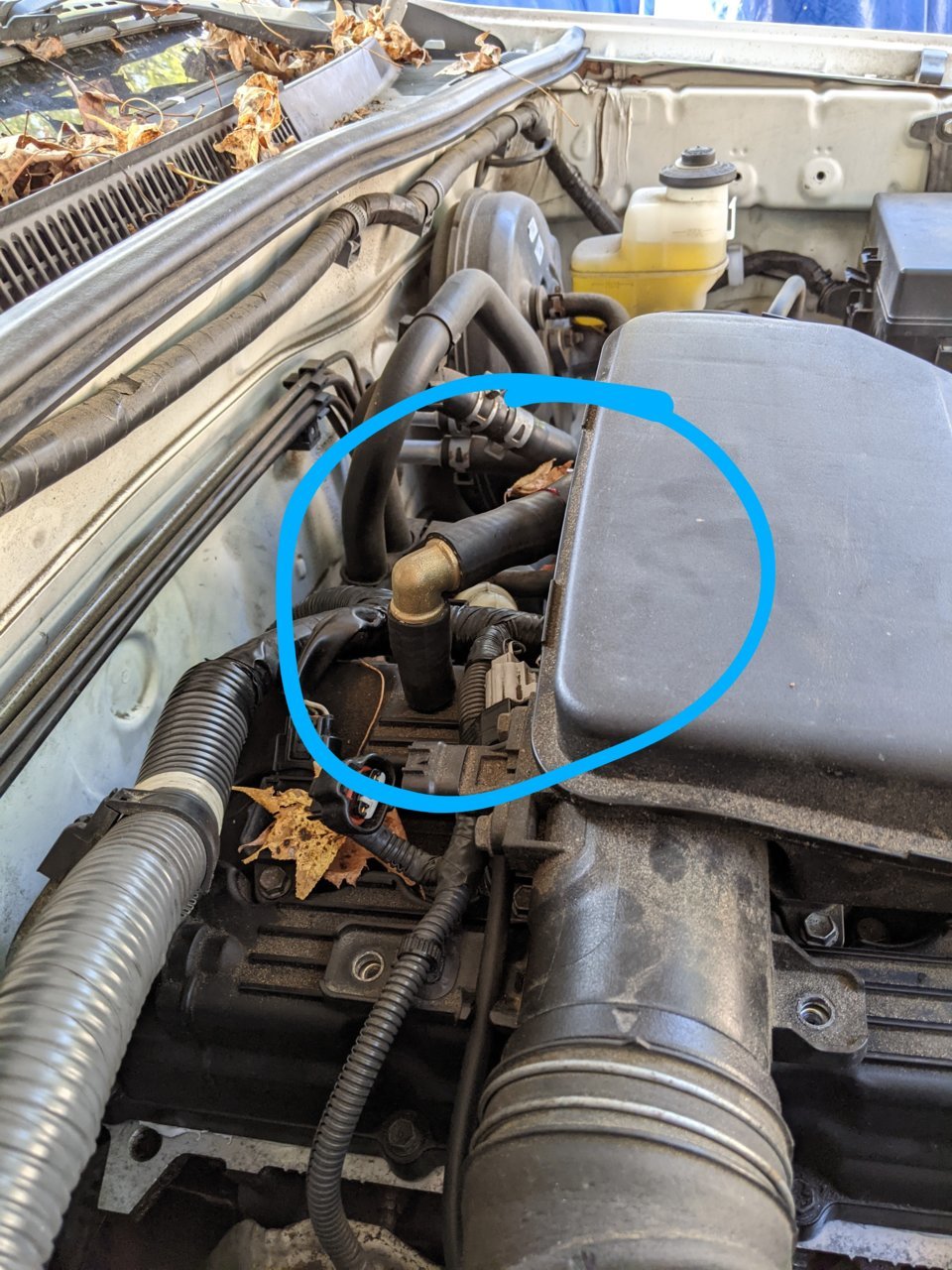

    Time consuming custom replacement for a PCV hose I later found behind the drivers headlight. Required two sizes of fuel hose (approx 5/8 & 3/4, can actually measure if requested) a 3/4 elbow from the plumbing repair section, a heat gun and some vaseline. I'm actually kinda proud.

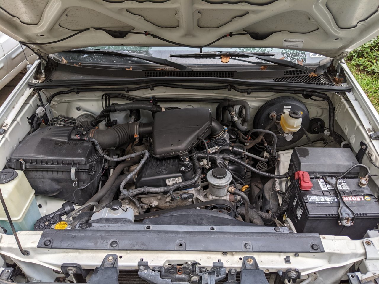

    All back together!

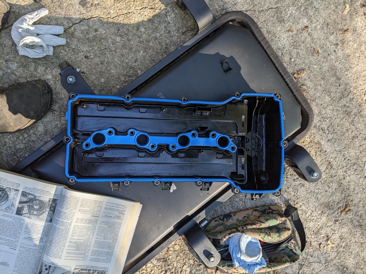

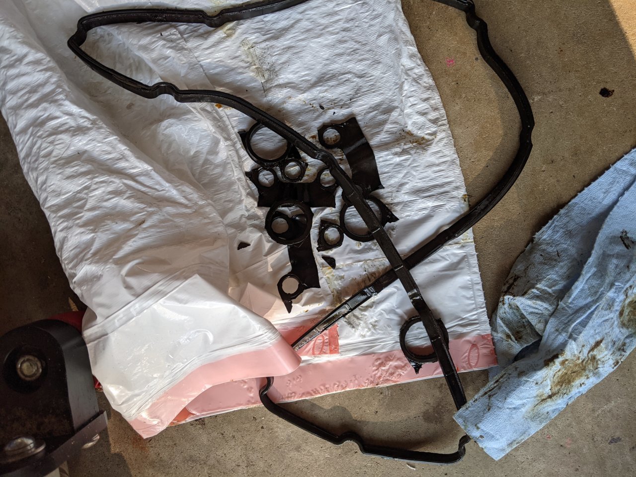

    Oh I forgot to mention the valve cover. Its gasket, at least around the spark plug tubes, was thrashed. It also appeared to leak onto the exhaust on the passenger side by the firewall.
    I also added silicone AGAIN (not shown) to the gasket surface that would meet the cylinder head. I've read these are prone to leaks, so this one might actually be deserving of it in addition to sealing the timing cover to cylinder head seams

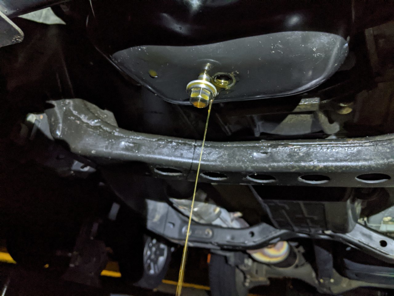

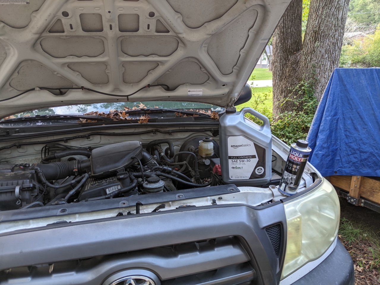

    Coolant! Walmart said they had the cheap red Supertech brand. They didn't.

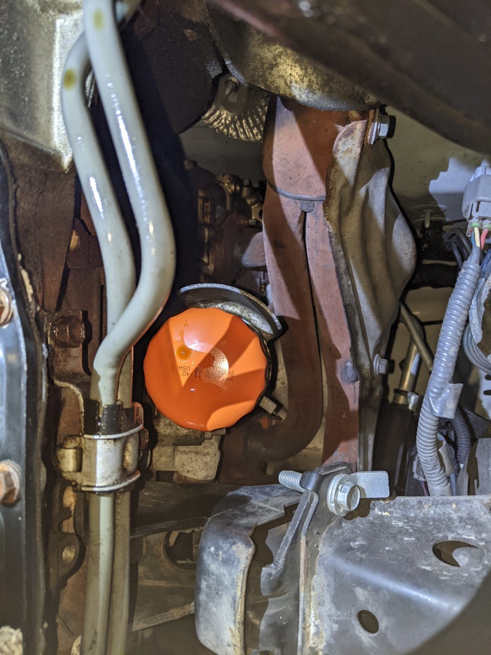

    Oil (extra 1/2qt not shown) and flush (the flush was supposed to be added AFTER operating temp was reached. Botched that)

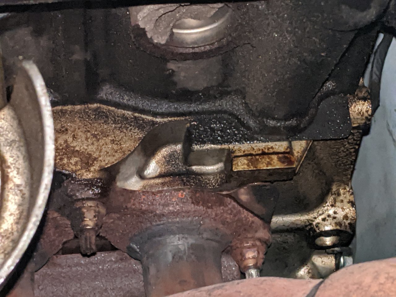

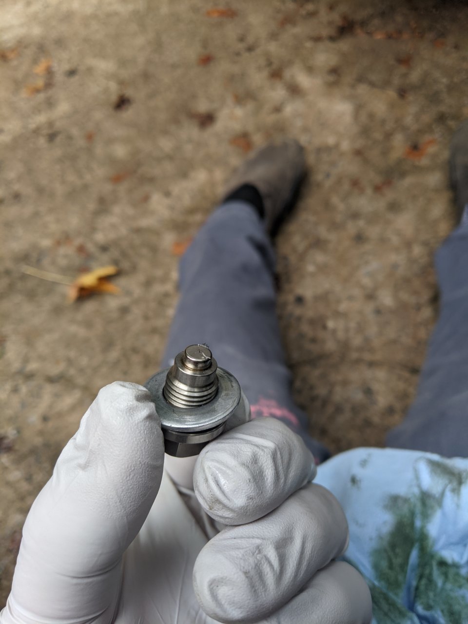

    Results AND a word of warning about magnetic drain plugs: They will stick to the pan and splash oil everywhere. I got lucky this time.
    Effin metal shavings! Not sure if it was the flush or time spent sitting dry. Never seen these before from this engine. Last seen in a Honda Del Sol (really fun little car), assumed rod bearings.
    Pretty sure I'm still leaking oil from God knows where. Not the valve cover! - I cleaned the engine bay tonight and will hopefully find out tomorrow.

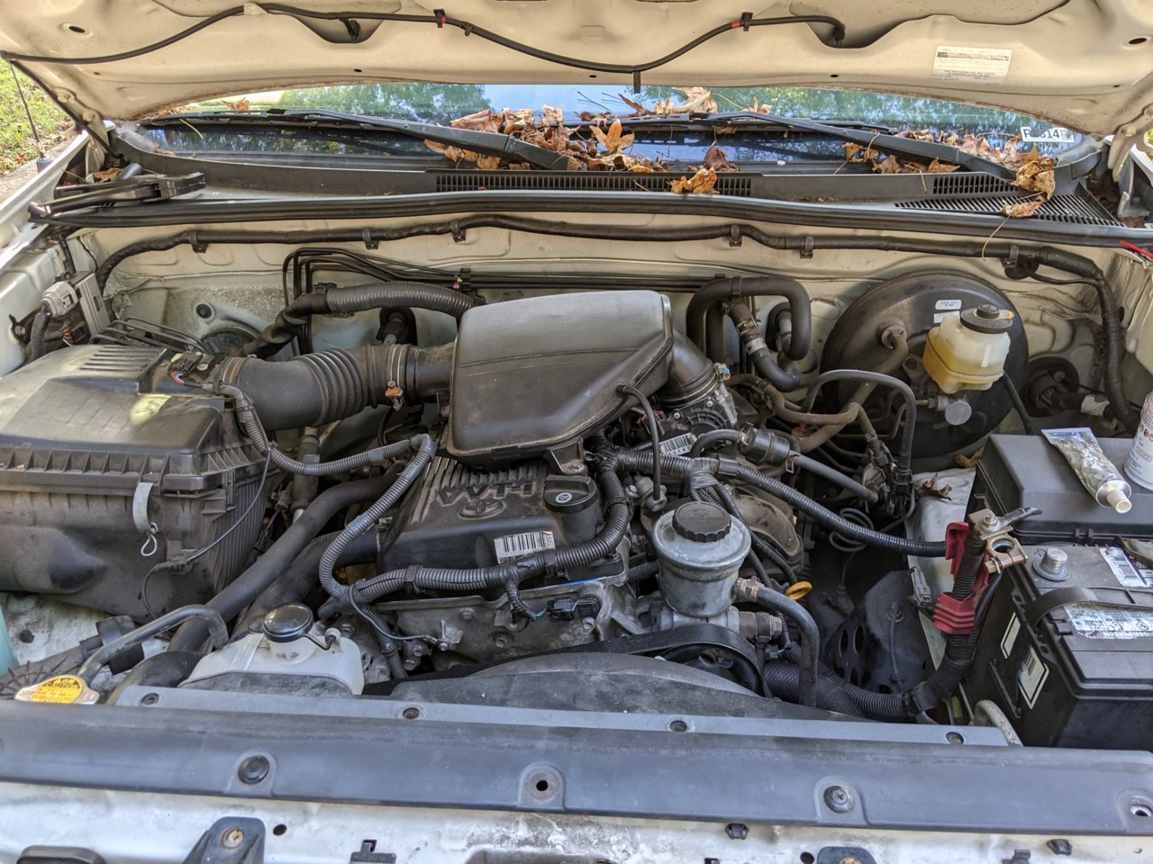

    One thing I do have to tell you though, all those leaves on your truck are wreaking havoc on my OCD. :rofl:
    winkel likes this.
  16. Sep 15, 2023 at 6:59 PM
    #116
    Pyts
    Pyts [OP] Well-Known Member
    Aug 26, 2020
    #338854
    138
    09 2.7 RWD
    Stock
    You nearly ended me with this one! We were both positively floored learning such a song existed.
    @SWPA Tacoma I've got an updated picture for yuh!
    All I did was a 1/3 ratio of simple green pro XD in a spray bottle that showed ratios. Quite the forearm workout, but after about 1.5 bottles I just hosed it off and it's near fully degreased.
