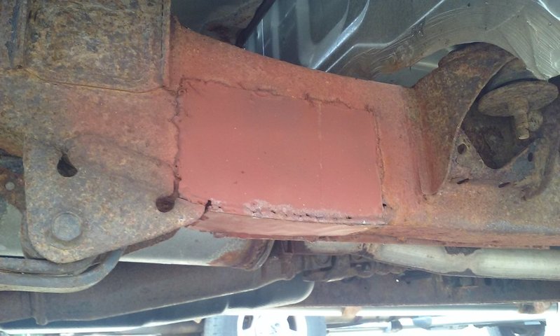

    Just seen 2004 Tacoma 4x4 2.7 5sp 150K 7000$. Was very impressed but had rust. It also had a steel plate welded (picture). Cross member was rusted with deterioration at frame.

    Question: how much rust is too much? Yeah i know its a stupid questions. Is it ever really worth considering a truck with the repair shown in picture? My experience is rust is hard to stop and moves fast but I come across a lot of trucks that i might be over reacting too.

    I'm guessing....You haven't seen - or are aware of - the frame rust issues on these trucks? It was a huge problem on the first gens (and the 2nd gens for that matter). Toyota offered a frame warranty for a period of time. Toyota would inspect the frames, if they failed.....they'd buy back the vehicle for NADA value (or something like that - can't remember - doesn't matter). The 2001-2004 trucks were lucky enough to get new frames or the corrosive compound applied. Same issue with 2nd gens...If your frame fails, toyota will replaced the frame. If it passes, they'll apply the corrosive compound (and I believe the warranty is good for another 5 years).
    So....my best advice....Look for the newer trucks 2001+. Be patient....maybe you'll find one with a replacement / newer frame. Whatever you find...I would highly recommend having TOYOTA inspect the frame. They'll inform you of its condition and/or if you have any options .... If you find a used one on a dealership's lot.... then you can probably bargain a bit depending on the situation / condition of the truck. FIND OUT about its warranty and push the issue.
    Do some research on the matter so you're fully prepared to push the issue with a dealership.
    But ultimately.... It sucks these trucks have a bad rap because of the frame rust. It'd be a damn shame to see anyone spend good money on a truck only to discover in a couple years the frame falls out from under you.

    Run from the rig with that patch job! The welds are scary. The weld don't even look like it got any penetration!

    +1 I have seen better welds with a car battery and a coat hanger
