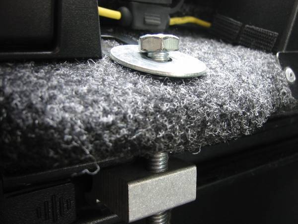

    My Leer cap installs with bolts that thread into blocks that go in the bed rail tracks

    Bedrail track block/bolt-

    You can get the camper clamps that slide into the rail from Bestop but last I checked they were $25 each
