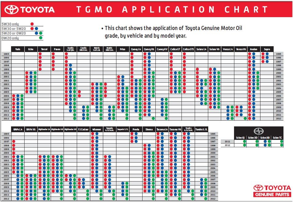

    My owners manual for the 2.7L only says 0w-20 or 5w-20. It doesn't say dino or synthetic, only "Toyota Genuine motor oil or equivalent". Do different years call for different specs?

    Different engines do, the 2.7 in the first gen is a totally different beast so its a different oil.

    Toyota Tacoma 2013 Owner's Manual page 456. 4.0 L V6 (1GR-FE) engine
    "SAE 5W-30 is the best choice for good fuel economy and good starting in cold weather. If SAE 5W-30 is not available, SAE 10W-30 oil may be used. However, it should be replaced with SAE 5W-30 at the next oil change."
    "The 5W in 5W-30 indicates the characteristic of the which allows cold start ability. Oils with a lower value before the W allow for easier starting of the engine in cold weather."
    "The 30 in 5W-30 indicates the viscosity characteristic of the oil when the oil is at high temperature. An oil with a higher viscosity (one with a higher value) may be better suited if the vehicle is operated at high speeds, or under extreme load conditions."
    Nothing about using 20 viscosity oil or lower.

    The 2013 Owner's Manual states what oil to use in this engine. 5w-20 is not listed, only 5W-30 and 10W-30.
