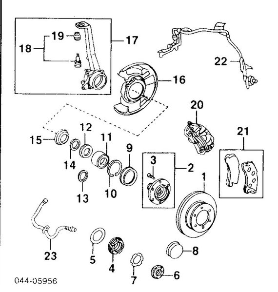

    I've attached 2 pictures to show the seals I'm talking about.
    2WD
    4WD
    The seal I'm talking about is number #11 on the 2WD, (the picture shows it has a hole, but it doesn't on your Prerunner, it's a metal cap) and #15 on the 4WD.
    You need 2 of the #15 seals, and 2 manual hub assemblies, or ADD hub assemblies, and you have what you need for 4WD
