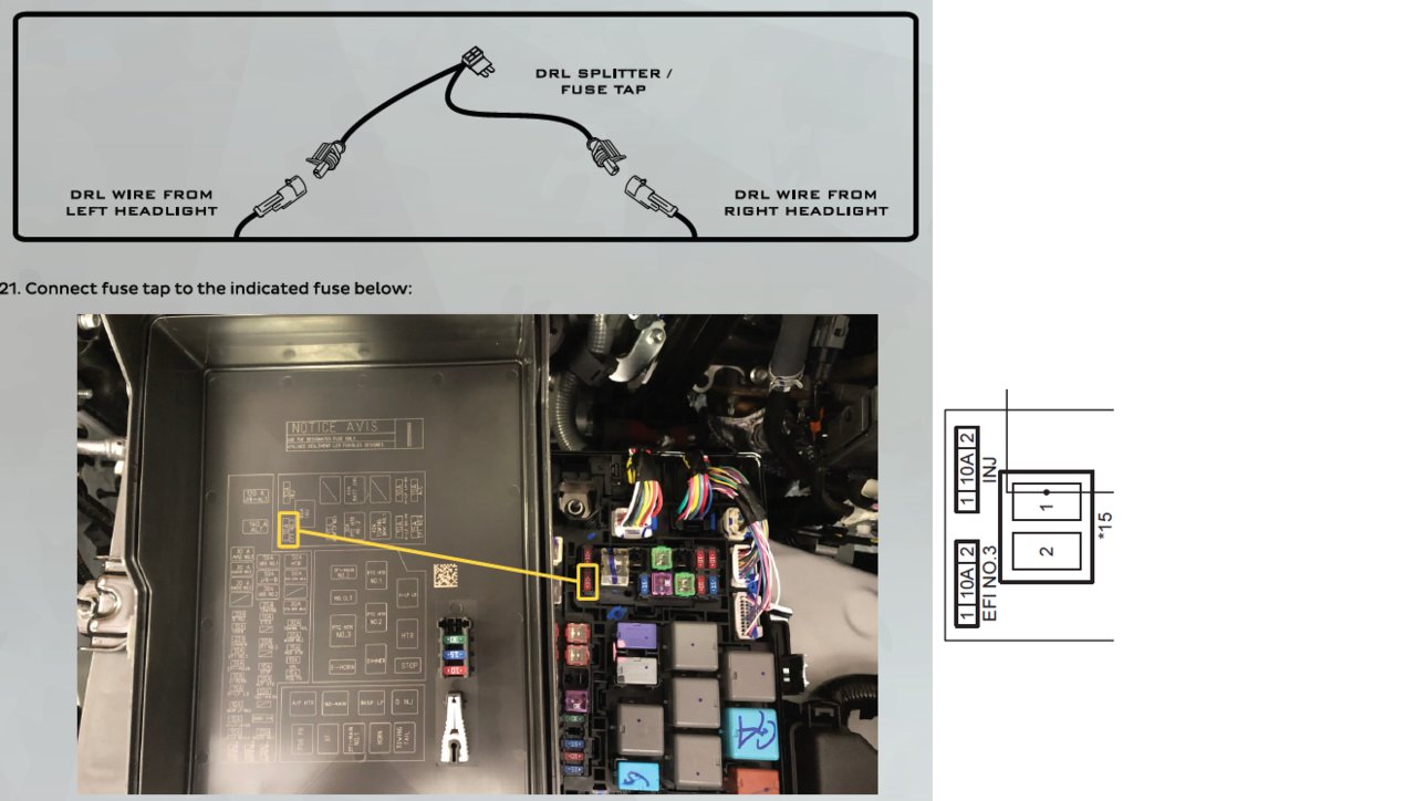

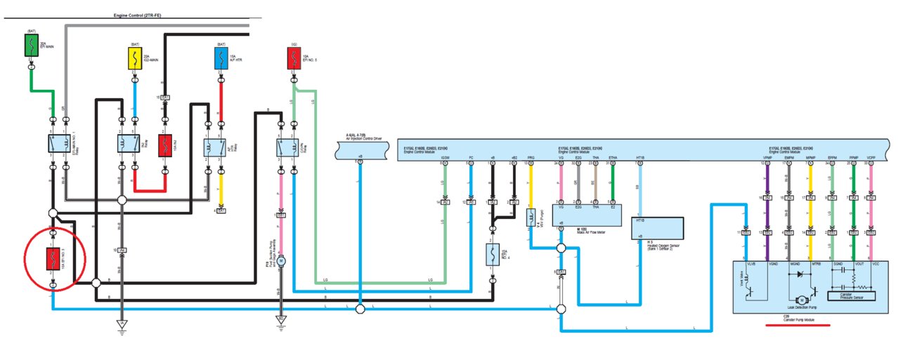

    Anyone having their installed Morimoto Headlamps illuminate (DRL's)
    after a few hours engine OFF?
    Add-a-fuse (dual) to EFI N0. 3 is same circuit for Leak Detection Pump test.

    I don't have XB headlights but I do have raptor lights that i taped into the EFI fuse and noticed them cutting on and off randomly throughout the day/night. I wound up moving my fuse tap to the wiper fuse inside the cabin.
