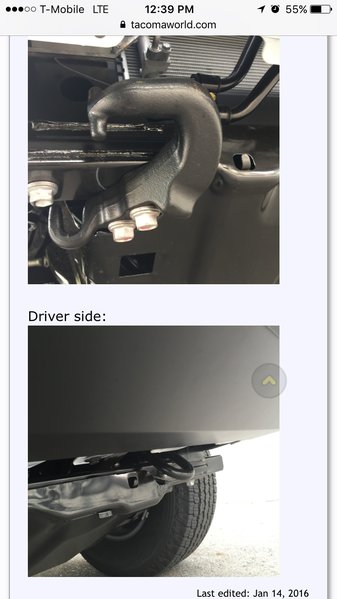

    Can you take some pics of the proper hooks, front and back? I see/ hear different options and confused which is really the right way.

    Use the hook, not the loop on the front of the Taco. Here are pictures from another TW Thread.

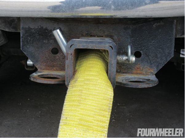

    Don't recover with this:
    Do this
    351572d1415783799t-d-ring-hitch-screen-s_31bbed056089f614360bd03edd9a80e4949e4da2.jpg
    Or this if you have to

    The recovery d ring for the tow hitch looks most legit. What is that part called and what are the specs?
