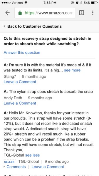

    I bought this recovery strap instead of the ARB one listed above: https://www.amazon.com/Tow-strap-Re...coding=UTF8&psc=1&refRID=8SQ0YADQXV5VDK9JWM2F
    - wider (3 inches vs 2 3/8")
    - higher breaking strength (30,000lbs vs. 17,500lbs)
    - half the price ($30 vs $60)
    Also have the same smittybilt hitch d-ring as mentioned above. Note: my shackle (on the smittybilt d-ring) was tight, but still managed to vibrate loose and fall off the truck. Only found it by accident. Since then I zap-strap the "bolt" to ensure it doesn't go anywhere (and will cut off the zap-strap when/if I need to use the shackle).

    That's more a tow strap than a snatch strap. A seller even mentions that it doesn't stretch as much as a snatch strap.

    It's not meant for a lot of stretch but also stronger than the basic tow straps I see for sale all over the place. It's polyester (11% elongation).
