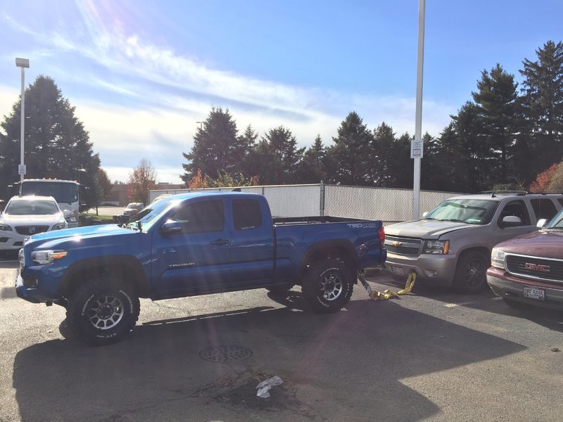

    Never even thought of using a recovery strap like the third picture. Is that really a safe way of doing it?

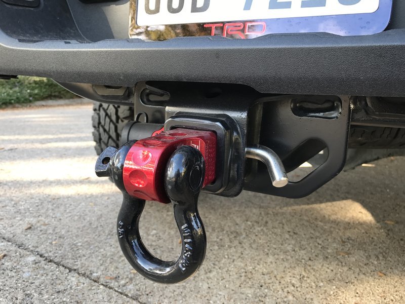

    Factor 55 hitchlink, smittybilt 3/4 D-ring, and bubba recovery rope is what I use. IMG_7883.jpg

    If it's a straight pull it's going to be fine. If the pull is to the side (or up/down) you will chafe the strap on the receiver and that's no good. It's a lot safer than using a ball, which happens all the time.
    I've done it on a straight & level pull when the other truck didn't have a tow point in the rear.

    Look the best option to insert the pin is the open end facing upward (see pic attached).
    Is this ok/secured/safe?

    The pin facing down like that is probably not the SAFEST installation method, but it's not immediately un-safe. I would wrap a zip-tie through the eye and around the safety chain loop just to be sure a branch does not snag the pin and pop it out.
