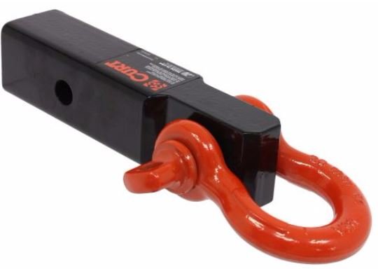

    Here's my shopping list for anyone wanting to get started on building up their recovery gear.
    Hitch Reciever Shackle
    ARB Snatch Strap
    Front Shackle Holder for TRD Sport
    ARB Shackle
    Small Shovel
    With these things, you can get yourself out of a lot situations you'd encounter on the trail. I can't stress enough to buy quality stuff. This is going to last you a long time, so spend the extra few bucks. There's a lot of potential for breakage and injury, so do yourself that favor.

    Yeah it's not something I'd want to do unless absolutely necessary. All recovery stuff comes in stages pretty much, and the list I posted is the best place to start. After that it can start getting expensive.
    hi-lift
    traction boards
    tree saver/chains
    front/rear plate bumpers and sliders (to use as lift points with the hi-lift)
    winch
