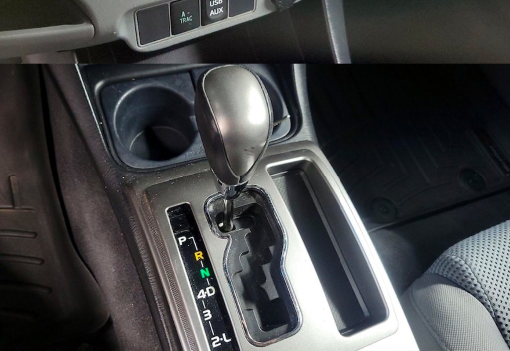

    I currently have a 2019 but may be getting a 2015 TRD automatic. I always use S Mode and D3 in my 2019 but the 2015 doesn’t have S Mode. How does using D3 in the 2015 work? Do I need to be at a certain speed or take my foot off the gas or slightly brake to move it from D to D3? What about once at the bottom of the hill - what do I need to do to move it back to regular D?Screenshot 2024-12-09 at 3.01.04 PM.png

    I can't say anything about how the 3rd gens work, but as someone who owns a 2015 and just finished towing a trailer 1k miles I can hopefully give some insight. As far as speed goes, I'd shift from D to D4 at no more than like 60mph. Same goes for shifting D4 to D3 to either engine brake or to keep RPMs up when starting a hill climb, probably don't make that shift above 55mph. Those are just general numbers, you'd figure out for yourself the real limits if you are really pushing it. Once you are done downshifting and you want it back in D (overdrive) just push the shifter back to D position. No slight braking needed, probably doesn't hurt to stay light on the throttle or let off while making the shift. Hope this helps, good luck.

    I owned a 2010 for 8 years then upgraded to a 3rd gen. You can use the transmission exactly the same way as your 2019, except the shift gate is puzzle shaped.
    Move the shifter D->4->3 at the same road speeds you'd shift D->S4->S3 on your 2019. If your downshift command would otherwise overrev the engine, the ECM simply delays the actual downshift until the truck dropped to a safe speed. To get back to 5th gear you'd have to move the shifter 3->4->D.

    Feel free to stay on the gas just like if you're accelerating in normal automatic mode. You're merely giving a request to the ECM to authorize a higher gear. The ECM then shifts when it deems appropriate and manages the throttle cut (or throttle increase to avoid bogging) as needed.
