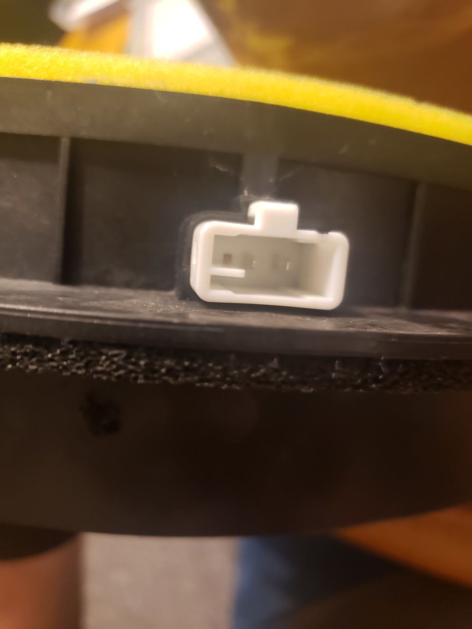

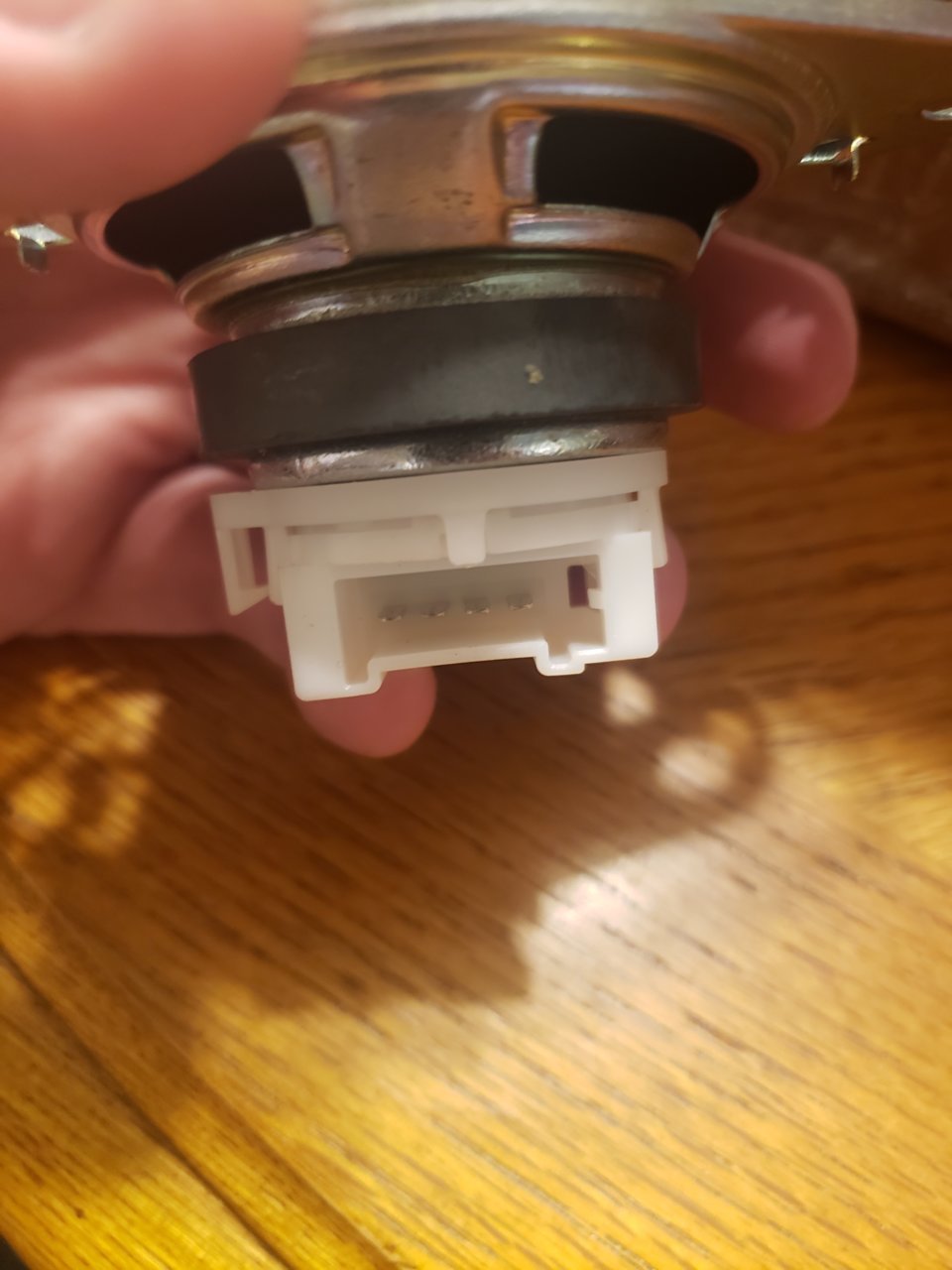

    So I upgraded all of the stock speakers in my 19 tacoma last year. Been using a bluetooth speaker in my garage, but decided I wanted something more, emphasis on CHEAP. So what cheaper than stuff I already have? So I picked up a $20 bluetooth media receiver head unit from work, and cannibalized a old pc power supply to provide 12v from a 110 source. I built some boxes out of scrap wood I had lying around. Now I'm at the point of wiring everything up. I'm looking at my factory tweeters and trying to figure out how to wire them. 4 pin, no wires to go off of as im not tearing back into the truck for reference. Anyone have any info on how theyre wired? Same question for the 6x9/6.5's, but theyre 2 pin and figured id just try polarity both ways

    mjc251
    mjc251 Well-Known Member
    Apr 12, 2017
    #216040
    326
    Mark
    2022 TRD Off-Road DCSB
    if you look at the tweeter from the connector on top and the cone pointed down, you should see two wires coming from the connector, I think the one on the left is positive. There are 4 pins on that connector as a passthru for signal on the woofer, so you can ignore.
