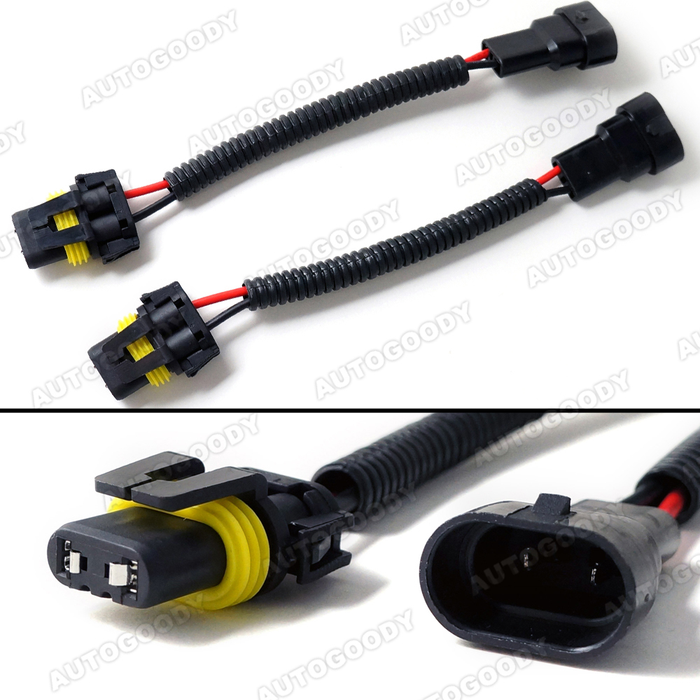

    this is the type of plug socket i got in my 08 tacoma.
    i just wanna know if u can use that ground and hot. to wire new led offroad lights
  7. May 13, 2014 at 5:17 AM
    88JayPizzle
    88JayPizzle [OP] Well-Known Member
    Jan 24, 2014
    #121331
    181
    ima try to wire this to my OEM Socket
    going to use the male connector to connect to my OEM plug.
    any conserns?

    I didn't take any pictures (I know, I should have), but I will see if I can get one tonight (the adapter I made is tucked up and away).
    But basically I took the supplied Rigid harness (seen here, snipped the plug off the end and attached it to an OEM connector... (the end in the bottom right in your picture).
    I'll try and get a pic, and the wiring threw me a bit since the stock wiring doesn't use a black red (got it wired backwards at first).

    Baja fog pocket kit comes with adapters to plug into the factory connectors..
    But there are some things to keep in mind;
    -Tacomas turn off fogs when highbeams go on, this can be fixed with the always-on mod; easy on the 2nd gen, it's harder for the 3rd gen.
    -OEM fog bulbs are ~40w so the harness is designed around ~3.5a each or ~7a both. Most LED will run less ie; Squadron Sports are 26w/2a each.
