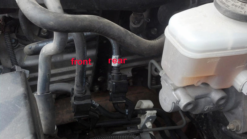

    F16, that makes sense. Of course I have no idea which fuel line is pressure side, as they both disappear underneath my supercharger. Attached photo, left is toward front of truck, which is which?

    You are dealing with high pressure what ever you do will require some thing better than rubber hose and clamps. The pump will not run with out the engine running or a wiring by pass. The pressure side is at the fuel rail the return is at the regulator. Frankly I think it is a bad ideal but it's your truck if it springs a leak the truck will stop and there will be gasoline every where.
