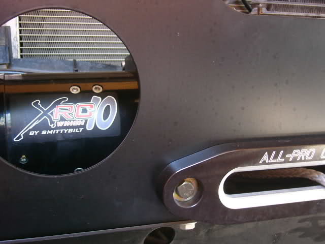

    I've been using a Superwinch EPi 9.0 like the one in the
    above picture on my Jeep for about 6 years, never let me
    down, and it's very fast.
