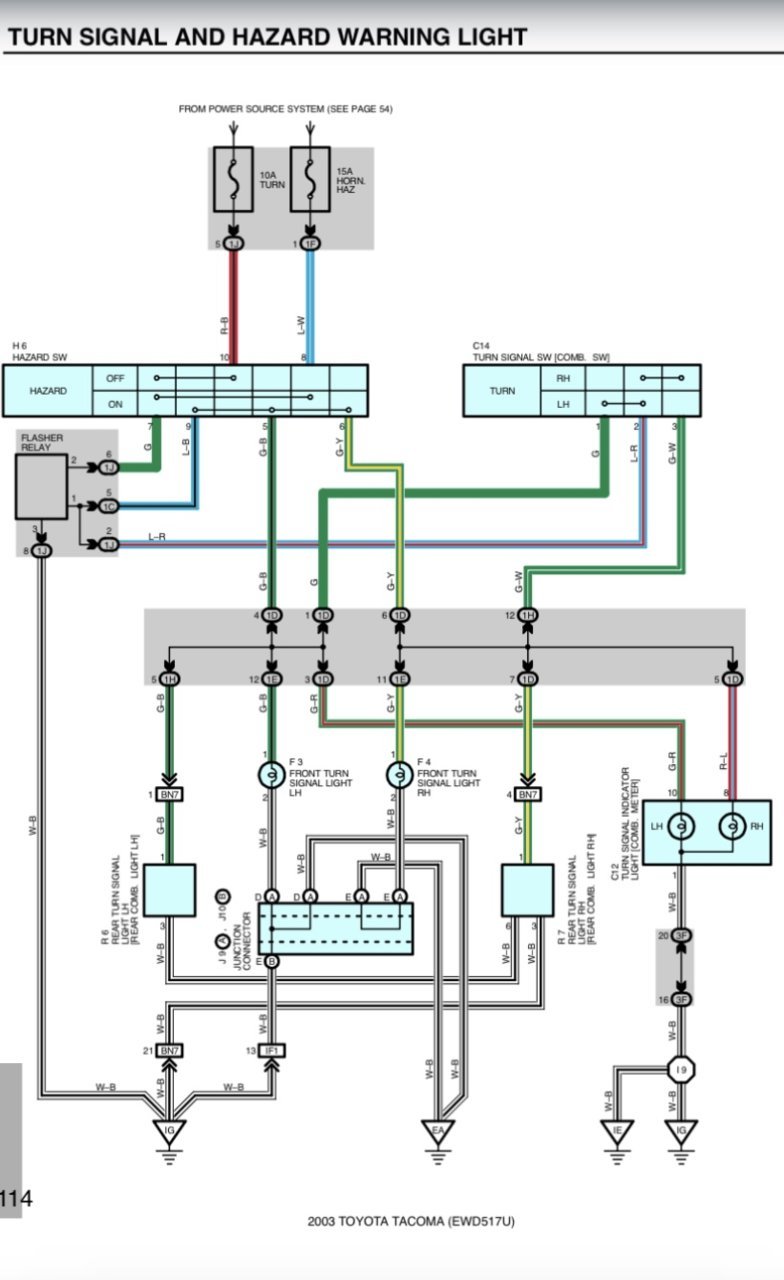

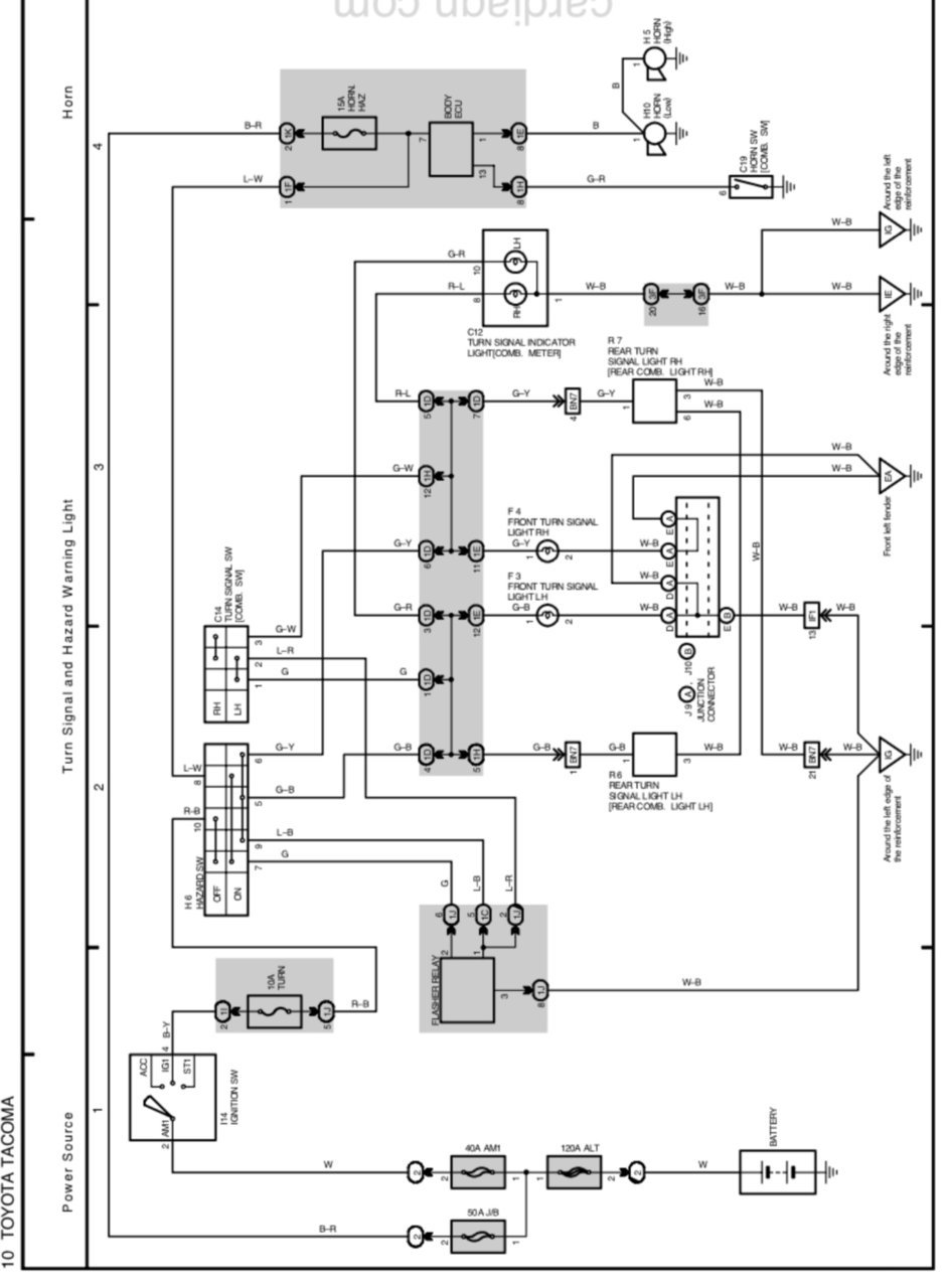

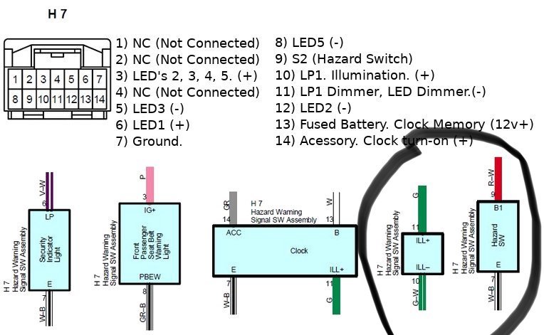

    So after a lot of research, I think my best bet is to try and repurpose an additional hazard light switch. The other switches like ect, clutch start cancel, and rr diff all seem to be momentary switches that interact directly with the ecu.
    The hazard switch, however, seems like a proper on/off switch that passes power from the 15A Horn Haz. fuse to the flasher relay and then on to the turn signals.
    I think this is shown in these diagrams but I may be wrong when I have some time, I will set up a test outside of the vehicle and see if i can get the switch to work.IMG_3944.jpgIMG_3941.jpgIMG_3947.jpg
