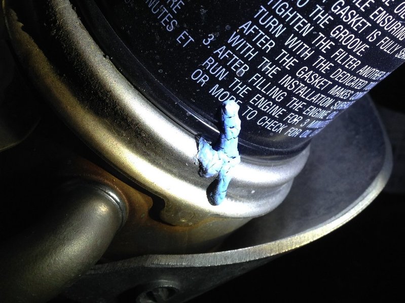

    Update to this thread.
    I drove the truck about 500 miles of short-haul, in CO winter mountains. Then a couple weeks ago there was a death in the family and I needed to drive to the midwest to help out. It's a little over 1000 miles each way, plus I drove a couple hundred while I was there. The upshot is that I've now put ~3000 miles on that oil change, some of it short drives less than 20 miles, and four days of all-damn-day making time crossing the prairie states. Cold starts, some of them less than 0° F. Hours at a time at 85 mph, often into a strong headwind. Flogged it pretty hard.
    I didn't do the level checks per 1000 miles because I had too much going on, but checked it just now. Perfect, didn't use a drop. So that's awesome.
    But while I was checking it I saw something unusual on the oil filter:
    It's a drop of something that got splattered onto the filter and hardened on. I'm sure I could chip it away with zero effort, but I'm wondering, could that be the original filter? There's no way the filter could be removed without this little dingleberry getting knocked off. Could it be that the dealer has been telling me it changed oil + filter but... didn't?
    I can't really imagine how it would have gotten on there since the dealer had it in December. Perhaps they splattered something on it last thing just before they closed it up, but the hood was only open since then 1) when I checked it after starting this thread in December and 2) just now. I can't imagine a scenario where it got splattered on there in winter with the hood closed.
    Anybody recognize it or can guess how it got on there? Kind of a robin's egg blue. Totally circumstantial evidence, not exactly something I could use to sue anybody. But I'm curious.
    And the dealer won't be touching it again. My confidence has been reduced.
  18. Jan 26, 2016 at 1:06 PM
    #18
    Clearwater Bill
    Clearwater Bill Never answer an anonymous letter
    Oct 11, 2014
    #140097
    24,604
    Billy
    Largo Florida
    '13 5 lug AC w/convenience package
    A few OE parts from fancy trucks
    :D :hattip:
    Sorry for your family issues and other distractions, but sometimes life just happens doesn't it?
    Glad you can take the oil consumption idea off your plate..........
    I can't answer what the goober is on the filter. But at this point I wouldn't worry over it. It will be gone with the next oil/filter change.
  19. Jan 26, 2016 at 1:20 PM
    #19
    ColoradoTom
    ColoradoTom [OP] Team Velveeta™
    Jan 26, 2015
    #147234
    253
    Colorado
    2014 Tacoma 4x4 Access Cab
    Life will do what it will do. In this case, makes no fuggin' sense at all. Healthy 60-year-old man, active, working a small piece of property for fun. Worked hard to be able to retire at 60. Gets some kind of weird systemic infection and dies less than 100 hours from reporting to the emergency room. Daughters 17 and 18. Happy wife (my sister). Not an enemy in the world. WTF.
    Thinking about that, yeah. Who cares about the little goober. Who cares when that filter was last changed. Nothing I can do about it now, so why spend a moment contemplating? I'll get me an OEM filter and put Mobil1 in there this weekend.
