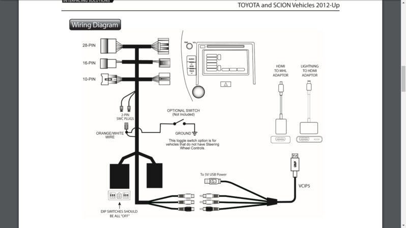

    I do not have the JBL system. According to the instructions, the install is a little more complicated...
    Yes, it absolutely does!
    You hold the up arrow on the left side of the steering wheel control for five seconds to initiate the system. Once the system is initiated you can control all the functions that are typically grayed out while the truck is in motion. The drawback being that the actual global positioning (the GP of GPS) appears to be disabled, that is to say the Entune system loses track of where you are. Not sure if happens through speed sense wire or some other faculty, but it happens. Hold the up arrow for five seconds again, and the Entune system picks up where it left off, and the truck will learn your location again.
    I have not tried this, and most likely never will. My interest was in being able to adjust destination settings while moving.
    Don't know for sure, but I believe that it will accept an analog video input.

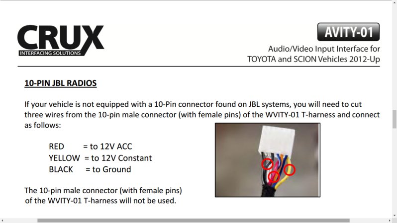

    I'm bummed that the CRUX solution is not plug and play for the JBL units. It seems like that would be pretty easy for them to do.

    2014 Reg Cab 4x4
    Thought the CRUX solution was JBL plug & play.
    It was the non-JBL systems that required wire cutting:

    I would still consider this plug and play since you do the wire cutting o the WVITY-01 and not on the actual truck wiring, still making it completely reversible.

    I agree, the instructions are a little confusing on this point. However kjp4575 installed it in a non-JBL truck and did not have to make any mods.

    I bought the VIMTY-05 but have not had a chance to install it yet. I used the online form to contact CRUX about the ambiguous JBL connector question. That was Sunday night and they have not responded. I'll try calling them tomorrow if I have a chance. I'd like to know for sure if the harness needs modification so I can take care of it before the installation.
    Also bumping this thread to see if anyone has installed the VIMTY-05 or AVITY-01 on a 3rd gen truck with JBL. Anyone? If so, did you have to mod the CRUX harness?
