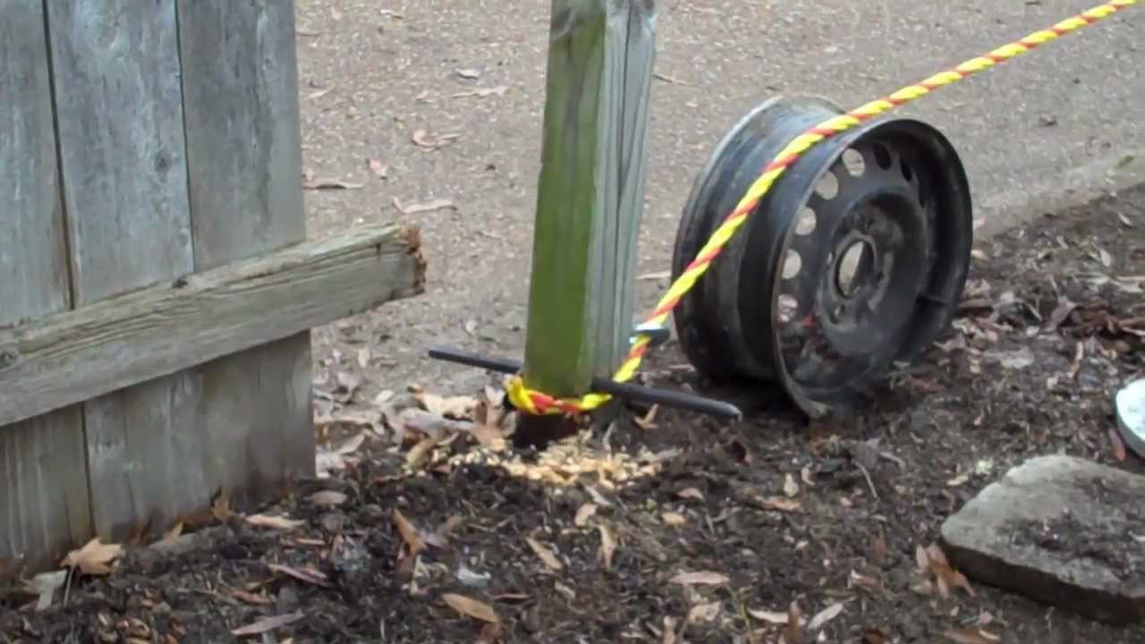

    Not my pic but I used a rim to re-direct the pulling force upward. Worked great to pull out some small stumps. I pulled backwards in 4lo (chain was hooked to the front of the truck)
