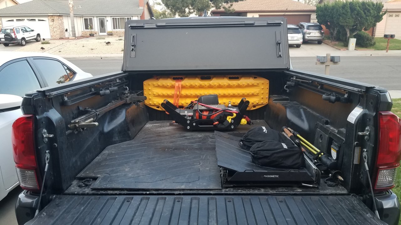

    I recently learned about Well Nuts in another thread and since I never knew they existed I thought it would be good to let others know about them. I used these for bolting a few items directly to the bed. I wouldn't trust them for anything too heavy but they seem to work great for things like shovel mounts or other lightweight items. I'm sure an engineer or someone more technically minded than me can give us what the real limitations are for using these to bolt items directly to our bed.

    I also used a few well nuts for my fridge slide. I'm a little worried about how this will hold up offroad since my fridge can get pretty heavy, but so far so good. I think you're the one who recommended them to me. lol

    I used them for my hi lift mounts also. The majority of the weight of the hi lift sits on the wheel well. So the rubber mounts are really only keeping the hi lift from sliding off the wheel well. I think it should hold up just fine.

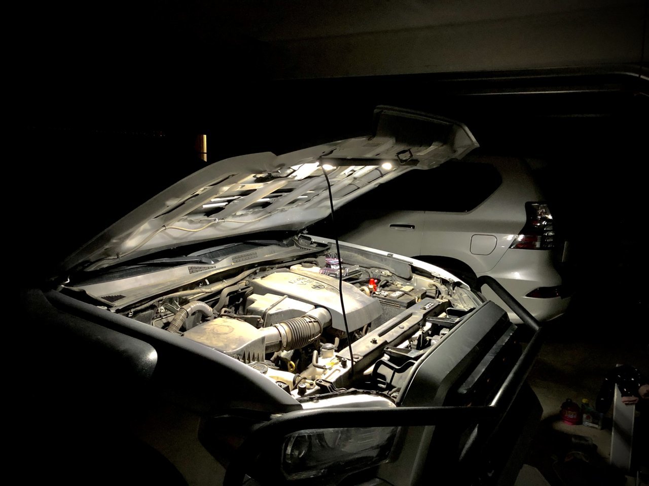

    18 TRD Sport DCSB MGM
    I used these to mount my Baja engine bay light. Because no special tool needed

    Now THATS a good fuckin idea. KC cyclones and switch pro here we come.

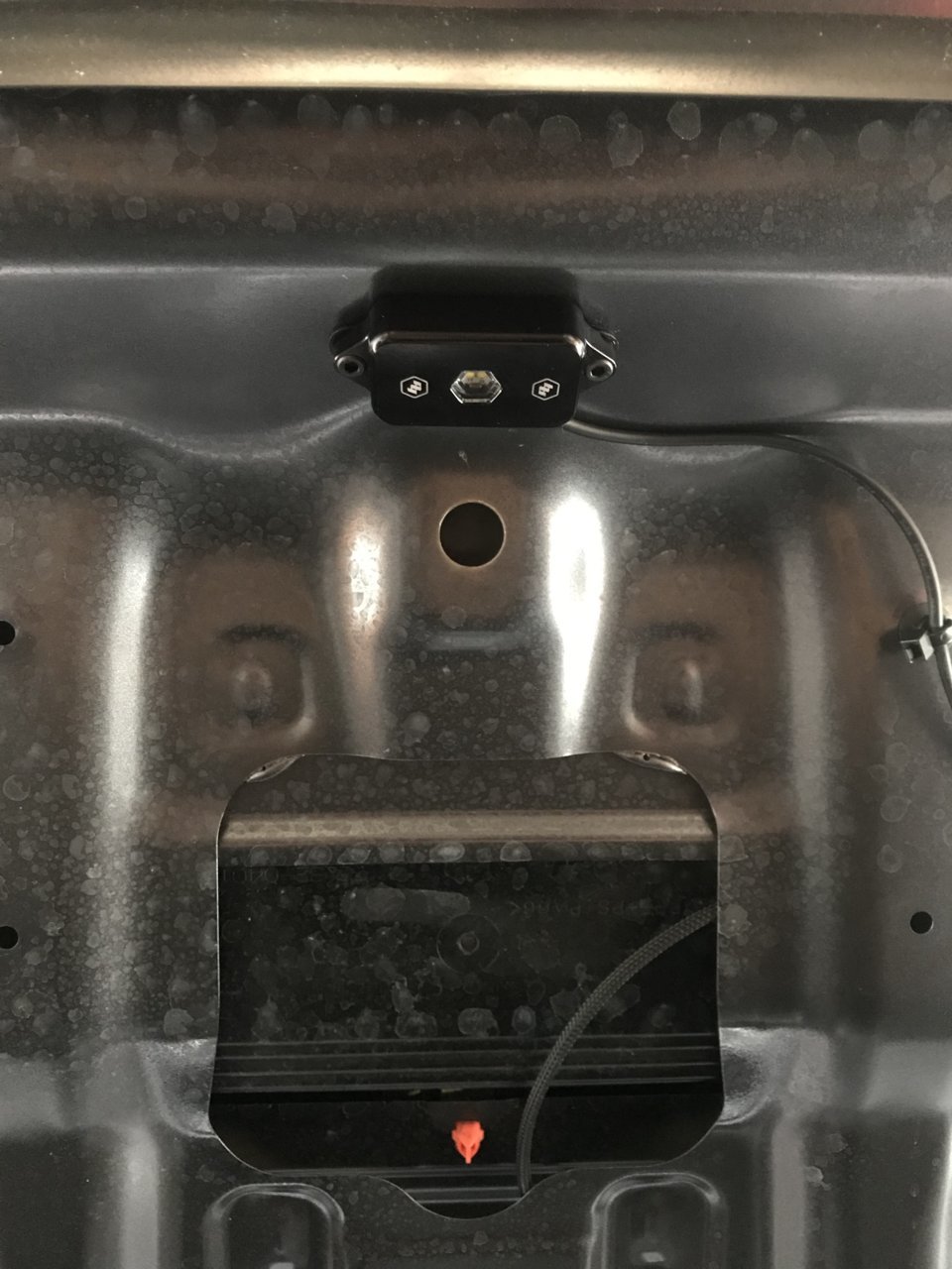

    Kc would work (I just didn’t like the puck style). I only wanted 1 so I had to do it centered but if you have more than 1 you might find existing holes you can utilize. The rubber acts as a seal/gasket/anti vibration and dont have to worry about rusting out and having to drill it out. I have posted a mini tut somewhere on how I routed the wires. I went with most hidden versus shorter/closer… in fact I have a second harness I was making when I did this one, just never finished it completely. This is where I used the Christmas tree zip mounts I showed you earlier on a pre existing hole holding the wire on the hood skeleton. Shoot me a pm for any parts or show you the harness routing

    its bright but not overly bright.
    I used these:
    https://www.amazon.com/dp/B07YBBCJ5W/
    combined with some countersunk bolts, washers, and nylon nuts.
    will do the same for rock lights as well, just haven’t had the time yet.
