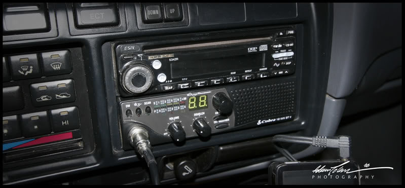

    OK, after nearly a full day of online research I think that I've got it figured out! :cool:
    This picture isn't a 2nd Gen, but it depicts what I have in mind with the Cobra 18 WX ST II:

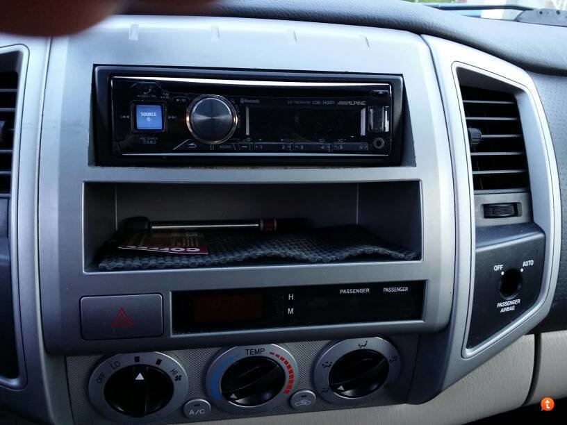

    In the dash I currently have a single-DIN Alpine head unit:

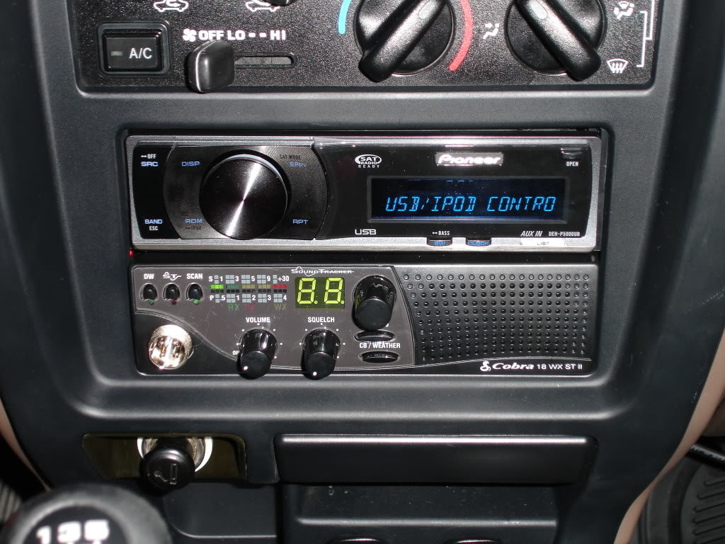

    I also have laying around a dash plate that can accommodate a single-DIN stereo, a double-DIN, or two stacked single-DINs:
    Plus it has the texture that matches my climate control panel, which I like the look of a whole lot better than the smooth dash panel that's in there now!
    Because the Cobra 18 WX ST II is a single-DIN unit, and I can stack it with my single-DIN Alpine stereo via the face plate I already own, we should be able to achieve a flush, factory look for both units in the dash atop one another. The front-facing speaker on the CB unit should work well in this position, too, as it's between the driver and the passenger at roughly ear height. I wish that this CB had adjustable RF Gain, and it would also be nice to have a switchable external speaker output that I could run to the auxiliary input on the Alpine stereo and use the internal speaker when I'm using the stereo for other purposes, and the stereo speaker when I'm using the CB full time. The way this unit is configured, if something's plugged into the external speaker output it automatically mutes the internal speaker and this isn't configurable from the front of the radio. But it's the only CB radio I can find that has everything else that I want and is a single-DIN size for this type of installation, so I guess that you can't have everything. Things like a clean mount and weather radio are far more important to me.
