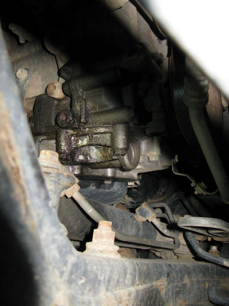

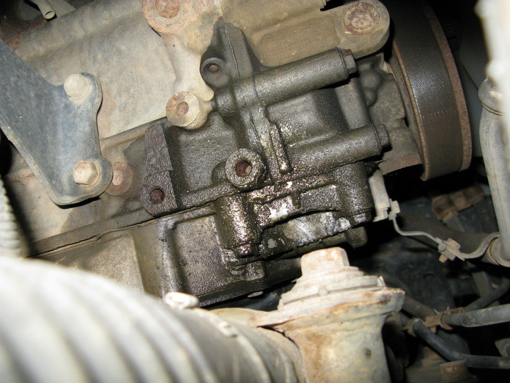

    Pretty sure my water pump seal has been leaking lightly since this summer. Never took care of it because the fluid barely drops. Nothing else is missing fluid and from the diagrams I have found for the four cylinder this is the water pump area. Bottom of engine passenger side is where these pictures are from. Stuff looks oily but doesnt't smell it.
    ETA: The only reason I don't suspect the thermostat is because the temperature reading from the ultraguage hasn't been the same since the thermostat was changed. That was around june. Think last winter I had a bad tstat because even running the heat the engine temp could hit 190-194 while driving at -20 temps. This morning at -2 it would only get into the 190's while idling. If the truck was moving she was running 186-188. This is with a spec 185 degree tstat for the 4cyl. I could even believe a blocked radiator but the system really hasn't been touched since the tstat was changed in el paso in june. It ran fine on 100 degree days this summer sticking right around 188.

    Hello @Hartford, in those photos you posted, you are looking at the crankshaft dampener, not the water pump pulley. The water pump pulley is above and to the right of the crankshaft dampener if you're standing at the front of the truck looking into the engine bay. The water pump is shaped like a cock and balls. The water pump weep-hole will be behind the pulley. Usually you need an inspection mirror and flashlight to see it. If the water pump is going bad, you will see dried coolant residue around the weep-hole or wet coolant dripping out of it.
    But the issue could also be an air pocket in the cooling system, intake system vacuum leak, failing coolant temp. sensor, slipping serpentine belt, etc. It's really hard to troubleshoot it through the internet. I used to live in Bountiful and the Tunex on Main St. just north of 2600 S. had several excellent mechanics. I'd recommend them over a dealership and if you prefer OEM parts as I do, they happen to be walking distance from the Toyota dealer.

    Awesome information. Thank you sir. Just what I was looking for. Will be checking them out on monday.
    Thank you to everyone else for your help also.
