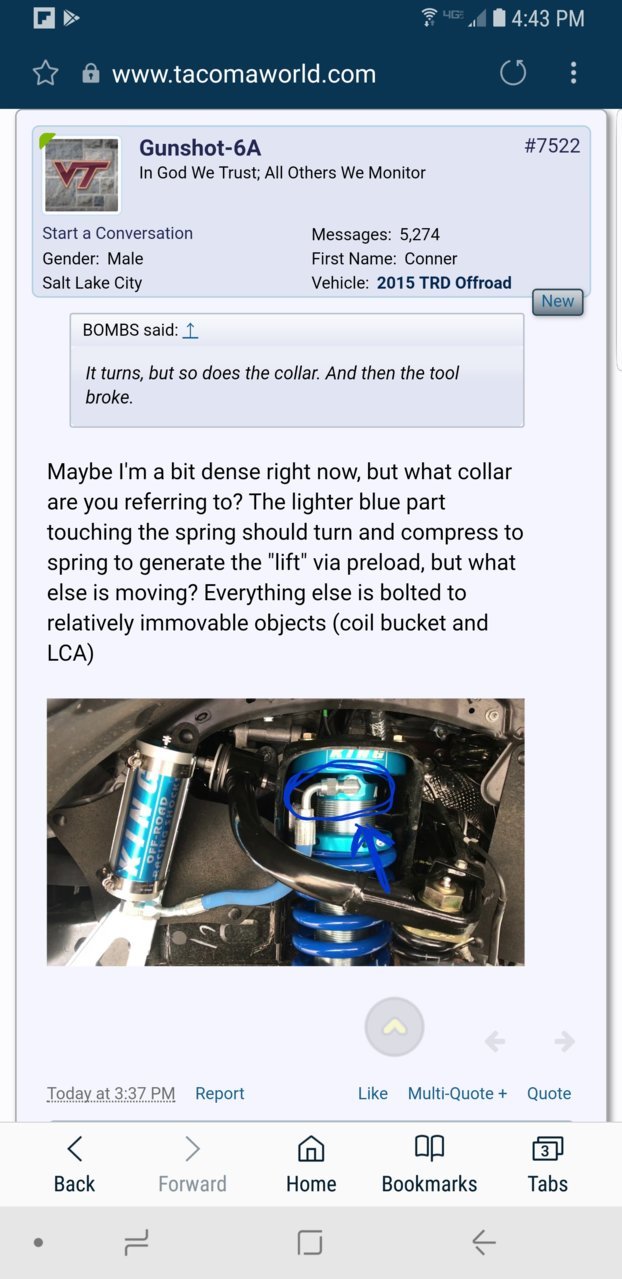

    It turns, but so does the collar. And then the tool broke.

    Maybe I'm a bit dense right now, but what collar are you referring to? The lighter blue part touching the spring should turn and compress to spring to generate the "lift" via preload, but what else is moving? Everything else is bolted to relatively immovable objects (coil bucket and LCA)

    To make it the easiest you wanna jack the front of the truck off the ground, then lube the threads with some wd40. You’re not the first person I’ve heard of snapping that tool.

    We had done that.

    That's a new one for me. Call King and see whats up?

    If you want to save yourself the hassle of coilover removal, this spring compressor fits in there if you pop the tie rod end out. The compressor itself is rock solid and have used it to swap 700 lb springs before.

    We had tried that too, but the coilover compressor did not fit in between the spring or there was not enough room while the coilover was still on the truck.

    Gotcha. Well if you already have one it seems silly to buy another, but the one I linked is awesome and can definitely fit on the coilover on the truck.

    We had used PB Blaster on the threads and didn't get nowhere.
