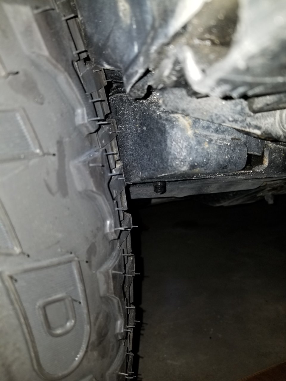

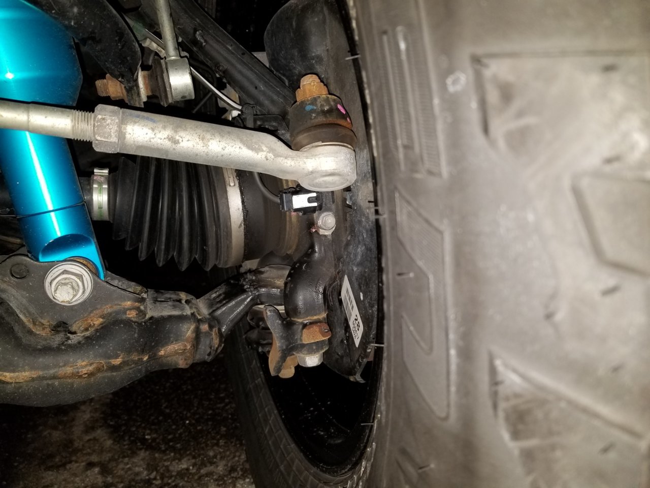

    Tires are rubbing on CMC. Anybody have any suggestions?20190409_182745.jpg 20190409_182842.jpg

    Cut more? Less stance? Relocation?

    Damn...more work! Thanks.

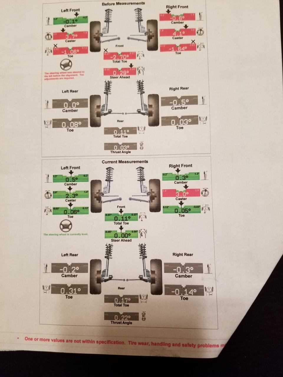

    What are you alignment specs? Can they get more positve caster?

    BOMBS
    BOMBS Well-Known Member
    Jun 22, 2018
    #257154
    1,422
    2017 Black Tacoma TRD Off Road

    I would see if they can get more caster. Something like +3.5 to +3.75 would give more clearance. If that doesn't work probably need to cut more.

    Ok. I'll give that a try, hopefully the Firestone in Riverton is still open for business.

    Are those 285/75/17’s? They look like there stuffed in their.
    More :sawzall: on the CMC looks necessary.

    Yes, they're that size and it's definitely stuffed in there.

    Keep on trimming the CMC away. I Unbolted my cab mount turned it and bolted it backdown. This gave me more room where I needed it and I was still able to keep both bolts and structure.
