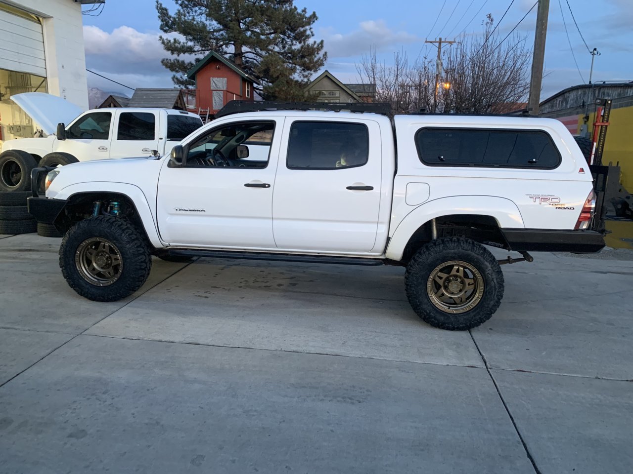

    Not much stock left.
    I have no clue :notsure: Nice rig though.

    Beauty, congrats! Try UTOR on Facebook, might find the previous owner there.

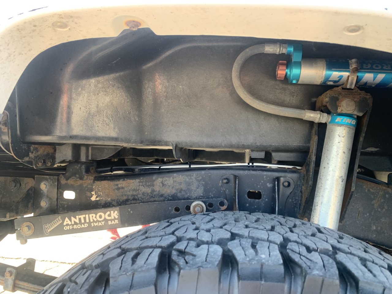

    Why does that truck have a currie anti-rock sway bar in the rear?? That thing can't have that much body roll? I would look at what spring pack it has.
    I have a long travel rear end and have a lot of body roll and I dont have a rear sway bar...

    Not really sure the need for that swaybar... If it does have an "unsafe" amount of body roll, that would lead me to think that the spring pack is wrong. There is a time and place for sway bars, but this is not one of those instances.
    Also, the rear hanger does not look stock. So I question what pack/ setup it has.

    Agreed on the suspension setup. Just saying that almost literally nobody has a antirock swaybar on the rear of a taco and it would be a custom fab job to make it so. Gotta be a list of about ~1 person.

    With the king coil overs in the front and no sway bar in the front is why I’m guessing and the rear shock towers have been raised and moved

    Lotta people run kings up front and rear relocates. Not one has a sway bar in the back. Pretty sure it is a symptom of a setup problem like @concentric_killa said.

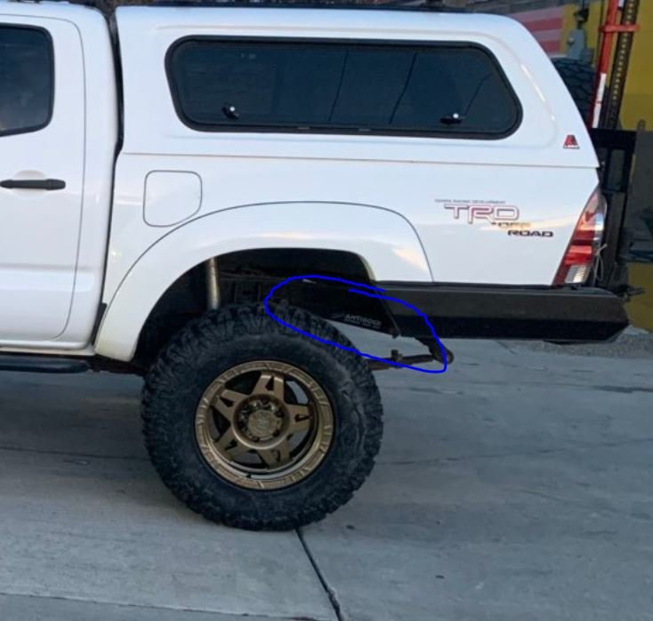

    Those shackles look really odd, being downward pointed in the rearward direction. Looks like a 63" chevy spring swap or similar process if I took a guess.

    I’ll have to take a pic when I get home I thought they where the total chaos leafs

    Just meant they weren't factory, not really one brand or another. Def a fabbed aftermarket setup. with the relocate, new shackle mounts, sway bar, etc.

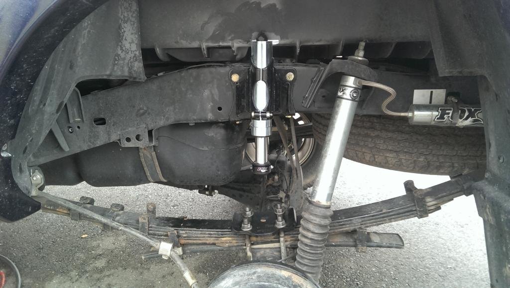

    but no hydro-bumpstops

    All that work on spring swap, relocate, and sway bar and you skip the hydro bumps?
