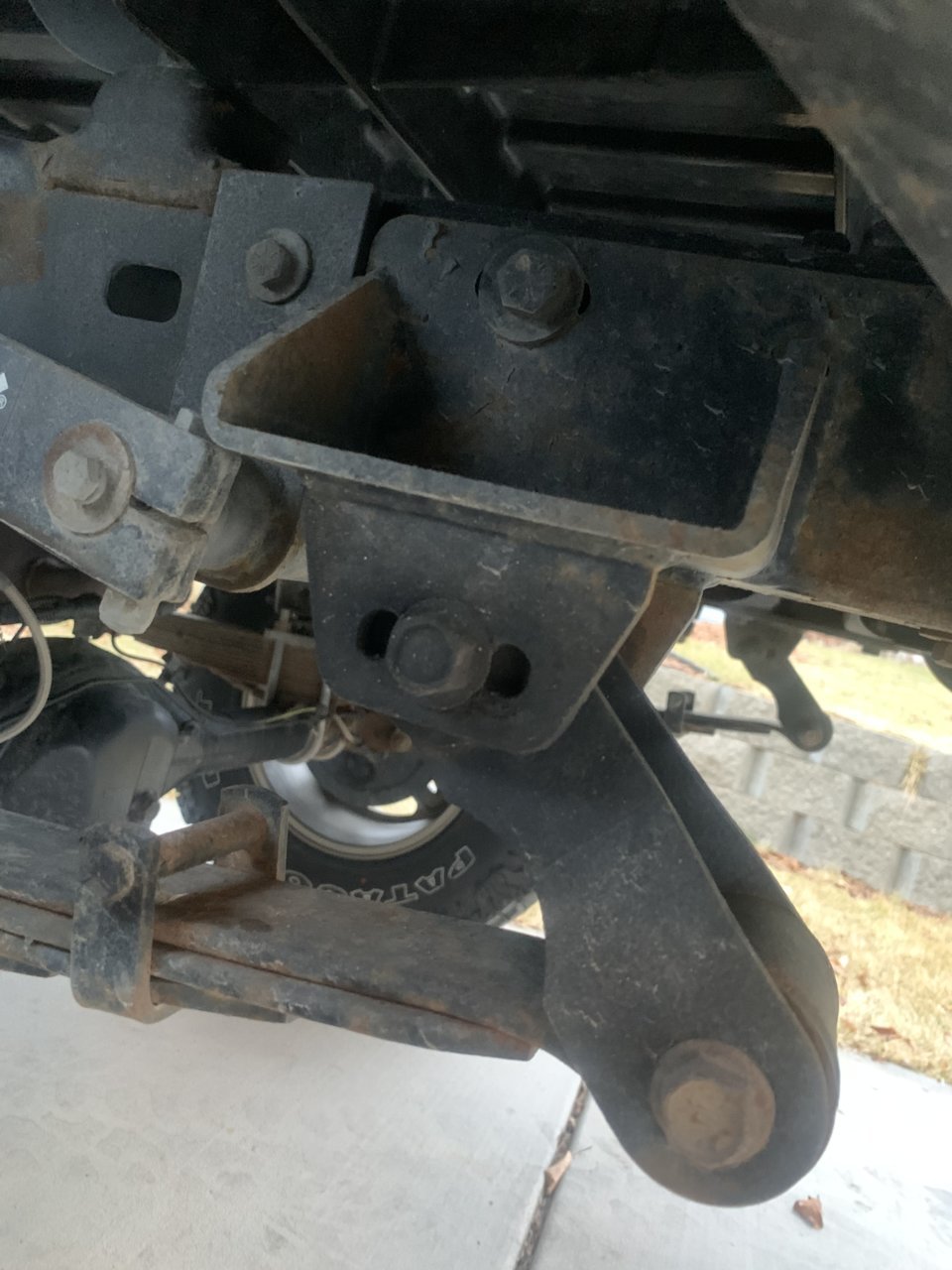

    Here is the front

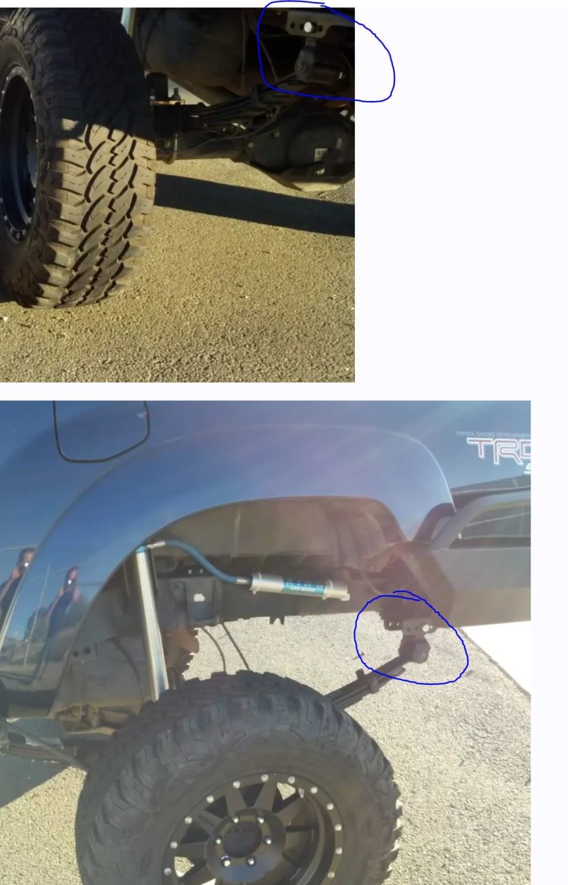

    That is not bad. Guess you didn't get swindled. For your reference, this is what alot of users do for beefer shackles and hangers.
    http://bayareametalfab.3dcartstores.com/2005-to-2018-Tacoma-HD-shackle-hanger_p_82.html
    http://bayareametalfab.3dcartstores.com/2005-to-2020-Tacoma-Shock-Relocation-Kit_p_14.html <-- Looks like you have this, but notice no sway bar.
    In some of the BAMF pics, it looks like you may have this rear hanger setup? I am not sure who makes it, but it is not BAMF.

    Those look pretty close to the ones I have

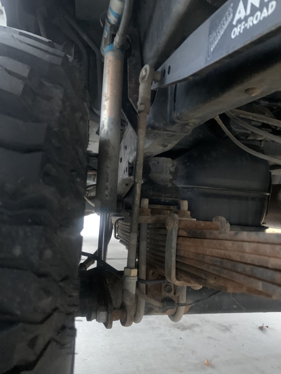

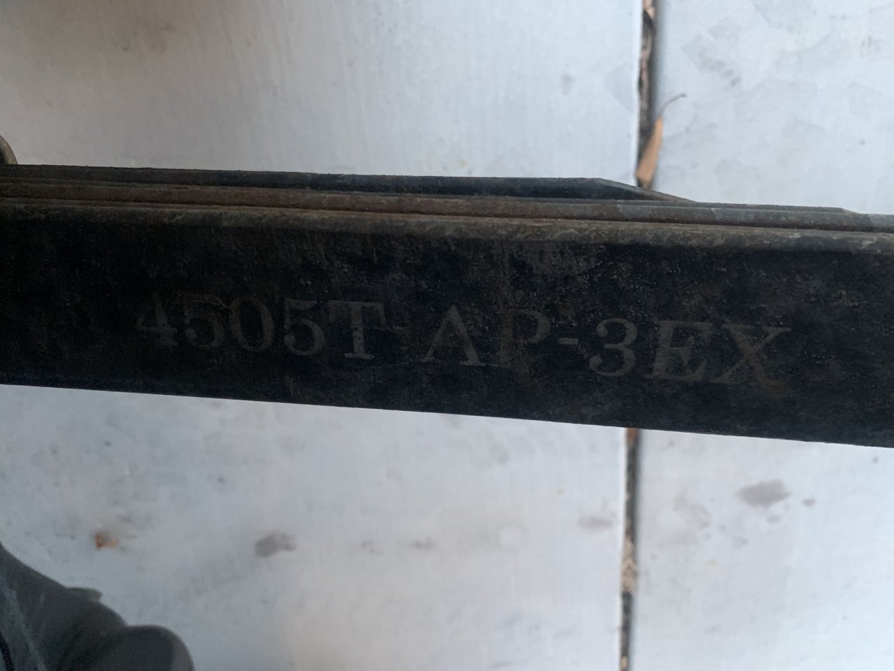

    There all pro 4505t-ap-3ex

    Thanks for the pics. Do you have a lot of weight in the bed?? It looks like you have no up travel.

    There is nothing in the bed the rear tire will fully stiff in the fender

    Interesting. From your supplied picture it looks like the spring has no arch in it and that it is riding on the rubber bump stop. Or is that an airbag??
