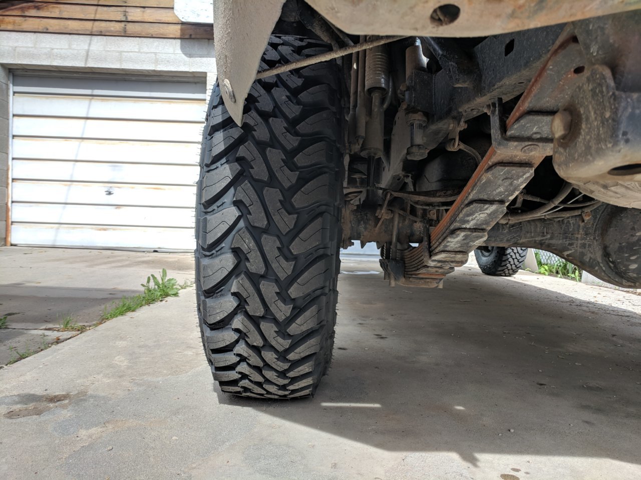

    There. Is 4 inches before it touches the bumpstops

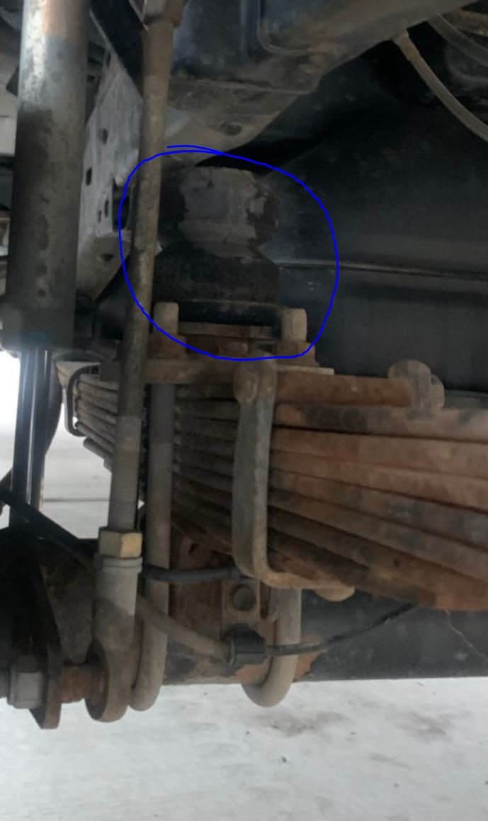

    What is this? It looks like it is touching the u-bolt plate Spring Plate.
  5. Dec 13, 2019 at 9:33 AM
    ginseng27
    ginseng27 who knows?
    Apr 19, 2017
    #216702
    3,168
    '17 DCSB OR
    not enough.
    bump stop?

    Thats what I think it is, but the OP of the picture says there is 4" before it touches the bump stops. I also asked if the truck was weighed down in the pictures he posted. He mentioned "no". I am just trying to figure out why his truck has a rear sway bar with all pro leaf springs.

    oh, I see the original picture now. yeah. that is very curious. it's also a strange looking mount if it is a bump stop. very interesting design/build for that suspension setup.

    Antirock is that rod and it’s not touching the u bolt but there is 4” between bumpstop and frame

    Yes that’s a bump stop

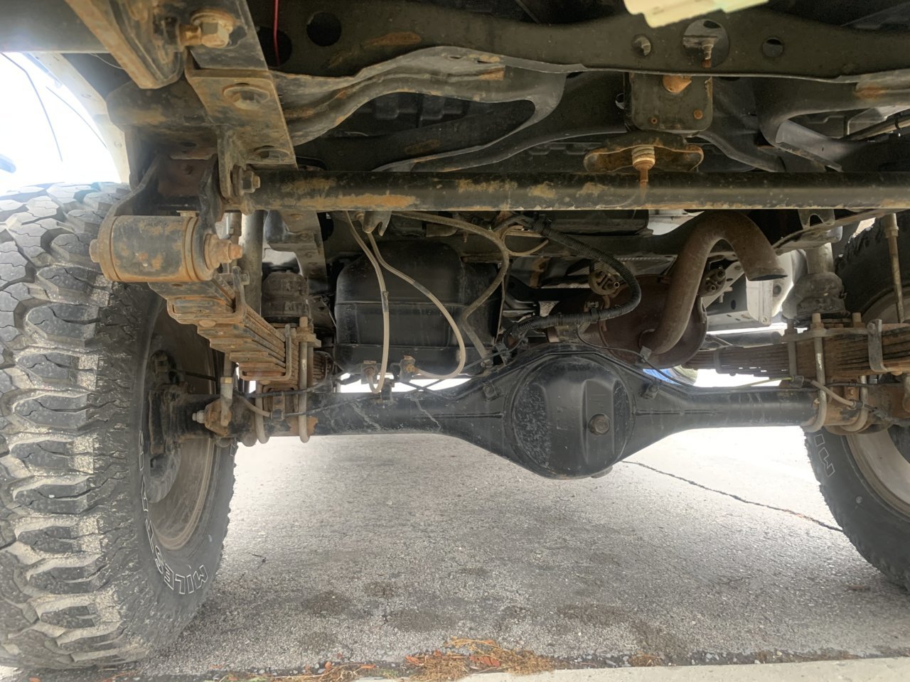

    Can you take one more set of pictures? A shot this or where you can see the bump stop and the gap between the bumpstop and the spring plates (my truck is spring under vs. your spring over axle). I want to see what yours looks like.
    No weight in the bed just your shell and bumper. I may have a theory on why you have a sway bar.

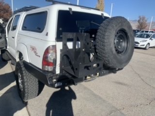

    I do have a spare tire on the rear bumper

    is it just me or does your leaf pack look super flat....?

    That is what I was looking at. The flatter the leaf pack, the more prone to axle wrap. I am wondering if having the shell, High clearance bumper, and spare tire have over taxed those springs. Depending upon where the truck sits, different parts of the leaf pack are "engaged".
    From Low Range's Website about those all pro springs: "* NOTE: These springs are NOT designed for extreme weight carrying capability. They are designed for ride quality and flex. For springs designed to carry heavy loads, see the CS047R Emu Dakar springs."
    That leads me to believe that the previous owner put the sway bar on in order to counter act a couple of things:
    - Axle wrap
    - Increased amount of Sway.
    Since the truck is more heavy in the rear, it will want to sway more. I experienced this a couple of weeks ago in my truck. I was hauling some brick and cinder block to the dump. I loaded my truck up to about 1-2" from my Hydraulic bump. The truck would want to "wander" and sway on the freeway. It was kinda sketchy.
    Although I had probably 1500lbs in the bed, and I have aftermarket springs/ setup, I could see the effects of excessive weight.
    I bet if that sway bar was disconnected, OP's truck would want to wander since the leafs look nearly flat at ride height.

    Great explanation. I can agree with this path of logic. Makes a lot of sense to me considering how flat those leaf springs look.
